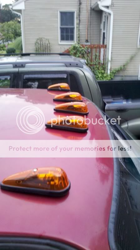

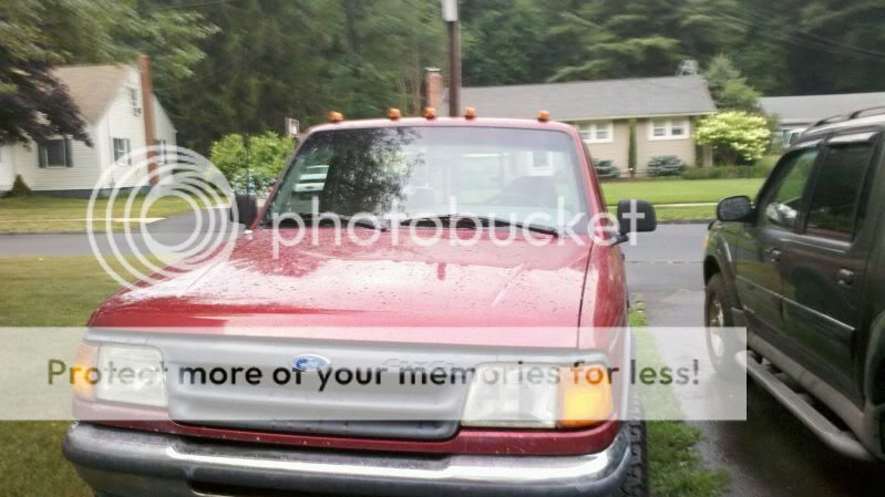

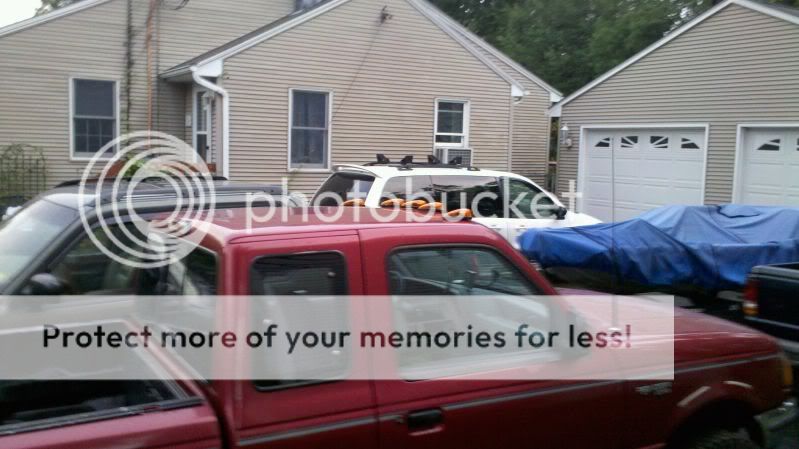

did a rough mock up. no measuring or anything. just seeing how i like them. i love them heres a few pics from different angles
i dont know when ill get around to putting these on for good but ill want to be not doing anything for at least 2 days
ps. sorry. i have shaky hands and my camera doesnt take quick enough

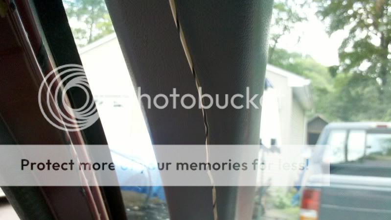

so i started removing all the trim to take down my head liner... which is really annoying because i have an ex cab so i need to remove that huge panel in the back it appears(unless i can bend it enough to see what im doing). any way. i took off the drivers side a pillar trim and i found this mysterious white and black wire going to no where? any ideas. i doubt it but im going to test it to see if it gets powered with the head lights. that would make life a lot easier
its not powered with the lights.... figures. now i just need one of those clip remover tools

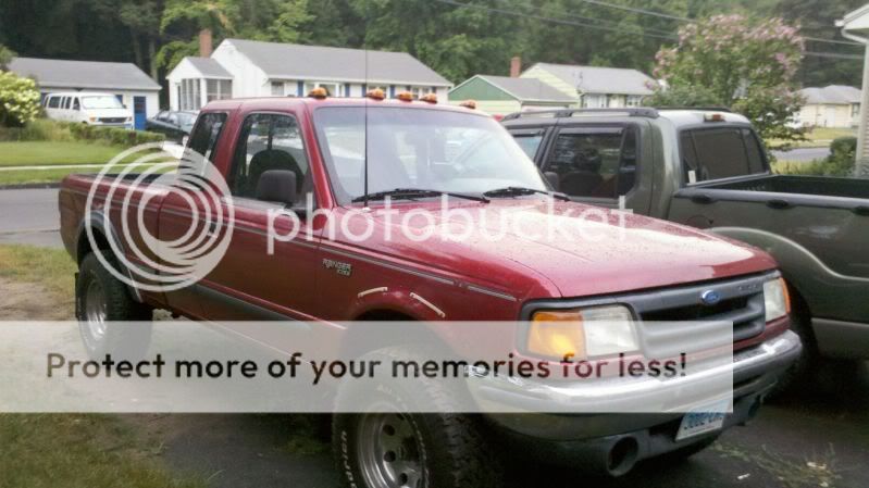

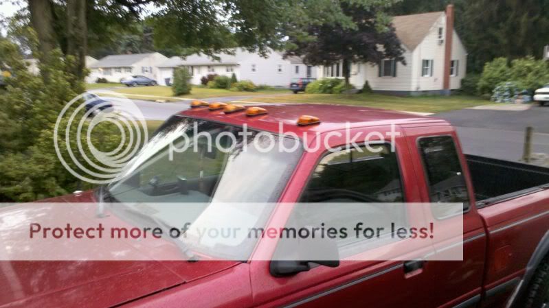

so the finished product. over all i would rate the difficulty 3 out of 10. probably took 3-4 hours in total. worst thing was dealing with the head liner
i ended up spacing the middle 3 out a bit more. i like it. the kit i bought comes with everything you need. i didnt use the switch or fuse they give you. i just hooked it up with the dimmer/light switch. everything works great. heres the measurements i used.
front of the light housing to the windshield trim - 4"
outer lights to the door crack - 2 3/4"
center the middle by dividing the distance in half
middle 2 - 8" from center one center to center
i just eyeballed them for straightness. i started with the outer 2. then did the center. and played around with the middle 2 untill i liked it. looking at the pictures now i probably would have done 7 1/2" (1/2" makes a very noticeable difference). the 4" from the windshield ensured that all of them followed the same arc. i really like the look of it and am happy with the results. i can't wait to see it at night (pics will come) and to get my 06 mirrors and lights

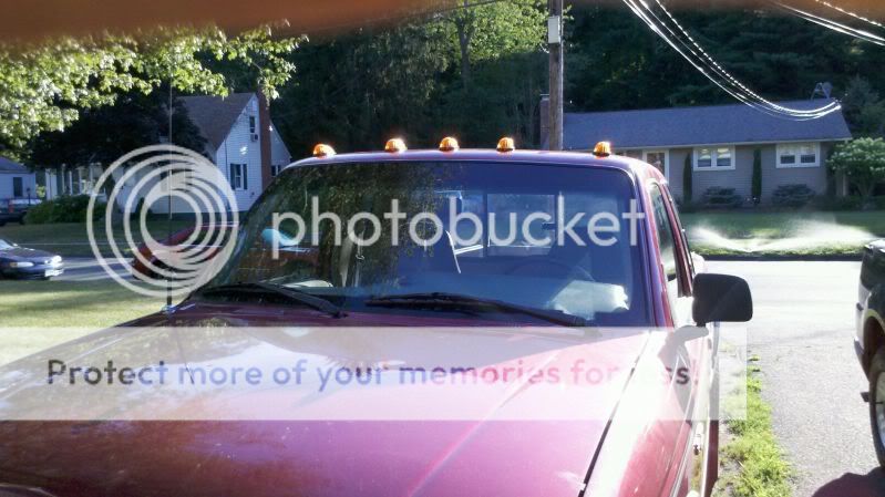

picture as promised. and like i said. if i could do it again i would have made the inner 3 slightly closer together, but hey. its cool. i like it. and how many rangers have you ever seen that have cab lights. maybe 4 and only 1 was in person for me. and he lived an hour away. so i'm the only one in the area. once i get my 06 mirrors and lights you really wont be able to tell if its a full size or not at night
