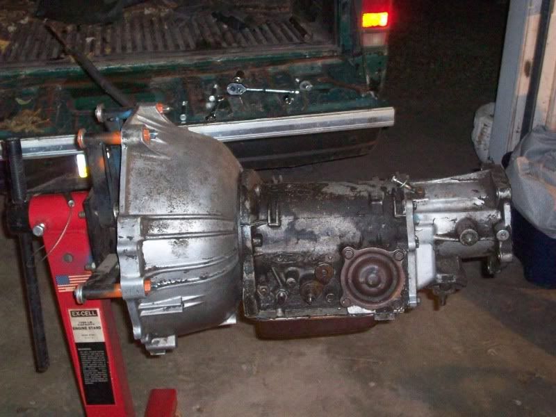

Here is my C5:
C4 or C5 Bellhousing

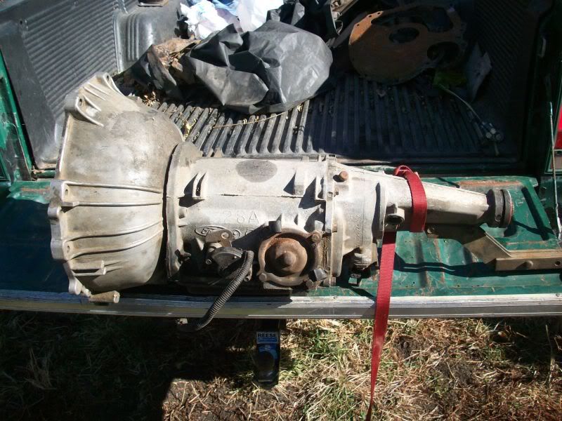

My C4, also 164t:

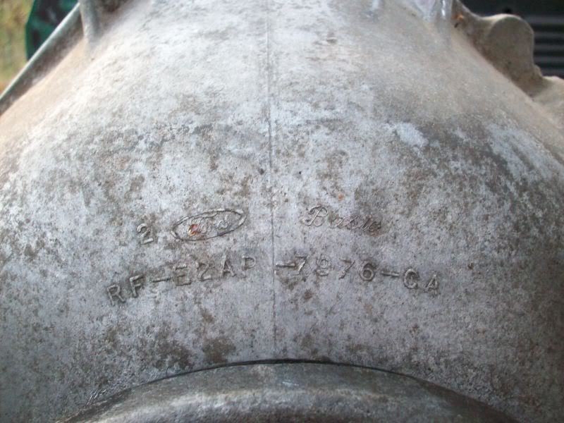

Of course there more be one than one part number for essentially the same thing (I wouldn't doubt it all on the C4)
C=60's
D=70's
E=80's
For example the E2 on my C5 bell means it was DESIGNED in (not produced for) 1982, the rest of it is code too but I don't recall what it means. You could still get a part in say... 1989 that had a E2 prefix if it hadn't been updated. The C7 means my C4 bell was designed in 1967.
Reading codes is kinda cool once you get into it, but I can never remember what the specifics are after the first two digits.
Nice pics! Very helpful.. So I can tell that I have the c5 bell currently (top pic)... to put it behind the 302 I will need the C4 164 tooth bell then (bottom pic)?? or will the old c5 housing mate to a 302?

The bellhousing is deeper, so the TC would be farther away from the transmission. Dunno for sure if that will be a problem or not. :icon_confused: I doubt it would be a good thing though.
A C-5 will not bolt to a 302. The C-4 is not only deeper it also has a larger diameter.
What is your intension for the truck? The C-5 is designed to back a V-6. It will work behind a V-8 (after the bell housing is changed) but it won't take a ton of abuse. Mine lasted in my off-road truck for just over one season. I then gutted the transmission and replaced the inner working with donor parts and Jegs parts from/for a C-4.

Bell house casting reads Pf-E2ap7976-ca

The first letter is actually a "R" and not a "P" ... so that will leave me with the same bell as you in the top pic..
