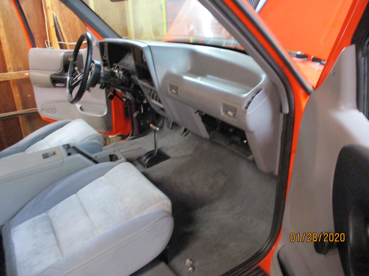

I used a B&M Unimatic in my Explorer with a C5 - I had to build a custom floor plate that raises the shifter itself quite a ways off the floor to clear the linkage. It looks like it's really high but it's very comfortable to use while from a normal sitting position. The only thing I don't like about this shifter is there are no really positive detents between gears in the shifter itself so it's really easy to miss a gear or be in the wrong gear.

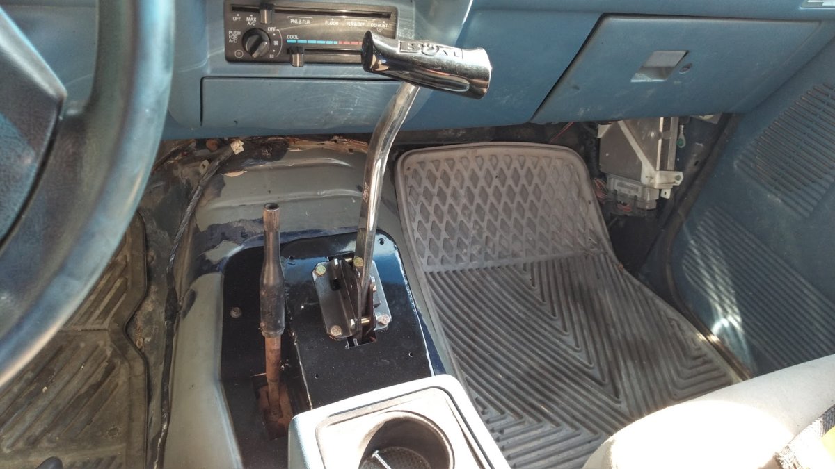

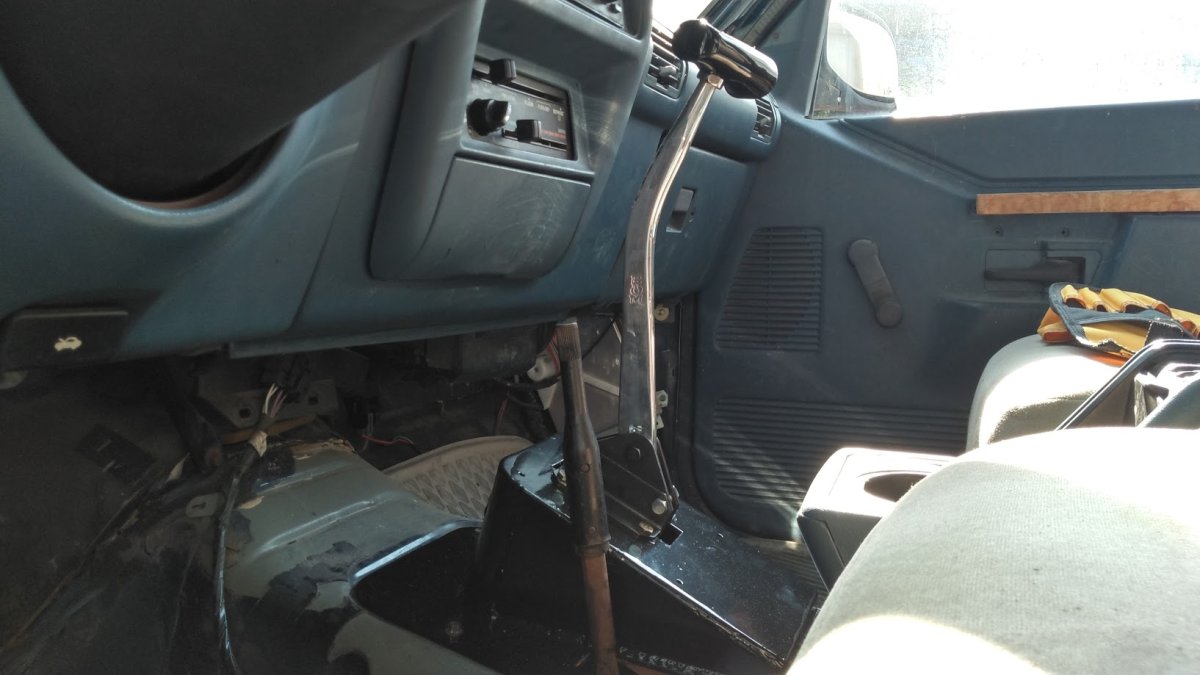

I used the same with my truck, with a bodylift I didn't have to move it up.
How much of a body lift did you do to clear the linkage? I was planning on doing one for the sole fact that it will make install easier for the trans.

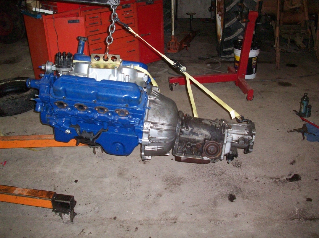

When you installed everything, how did you go about mating the trans and motor? Did you install trans by itself first then the motor? Or mount the trans to the motor then drop them in together? I'm hoping to start in a couple weeks and getting final plan put together.
Went in as a team.

Went in as a team.
A 2wd has a longer tailshaft, no idea how that would work. The 2.8/A4LD was tighter coming out than the 5.0/C5 was going in... but my bell was deeper than a C4 bellhousing as well.
Great, thank you very much for that. That helps figure out some of the alignment questions I had. My plan is to drop both in together and put the transmission crossmember in unbolted to help figure out where I need to drill holes as well as just support some weight.
