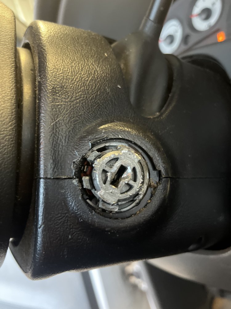

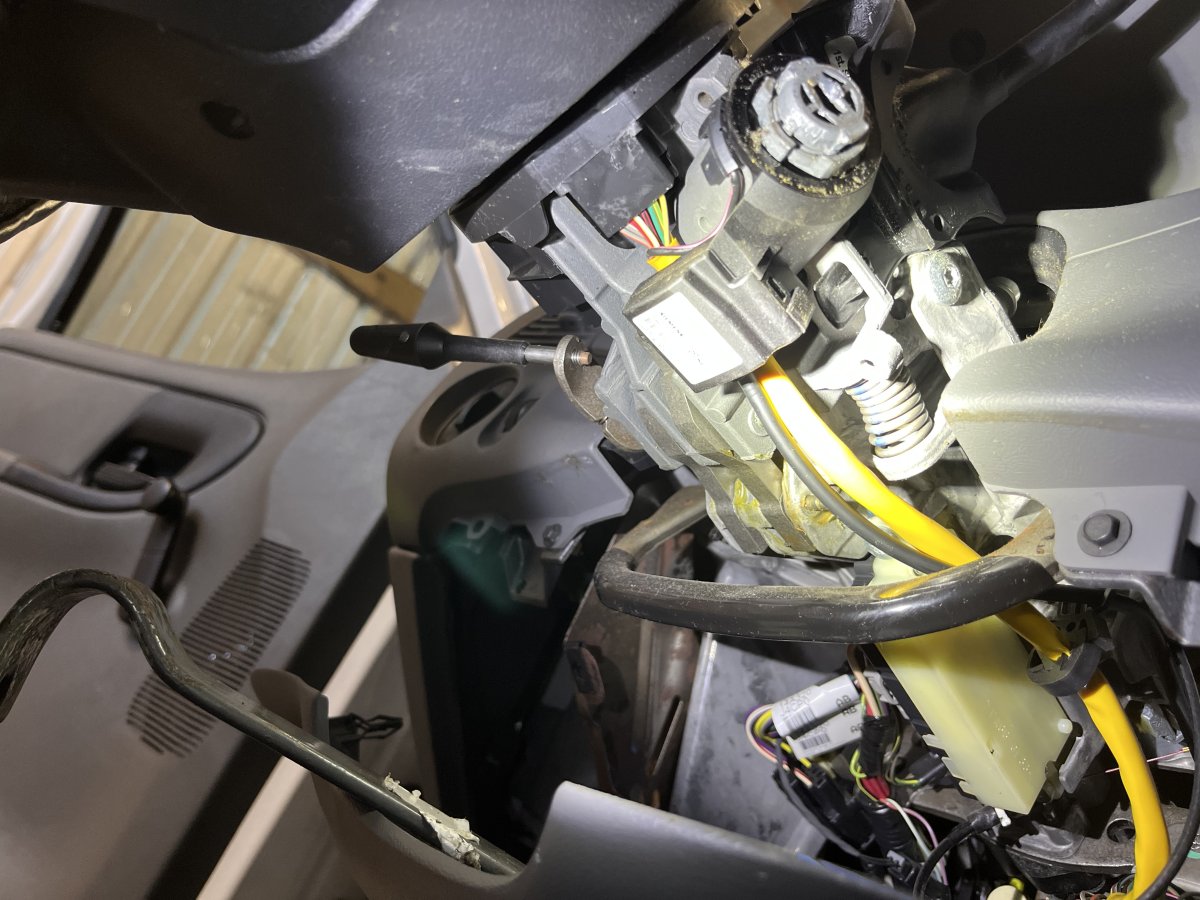

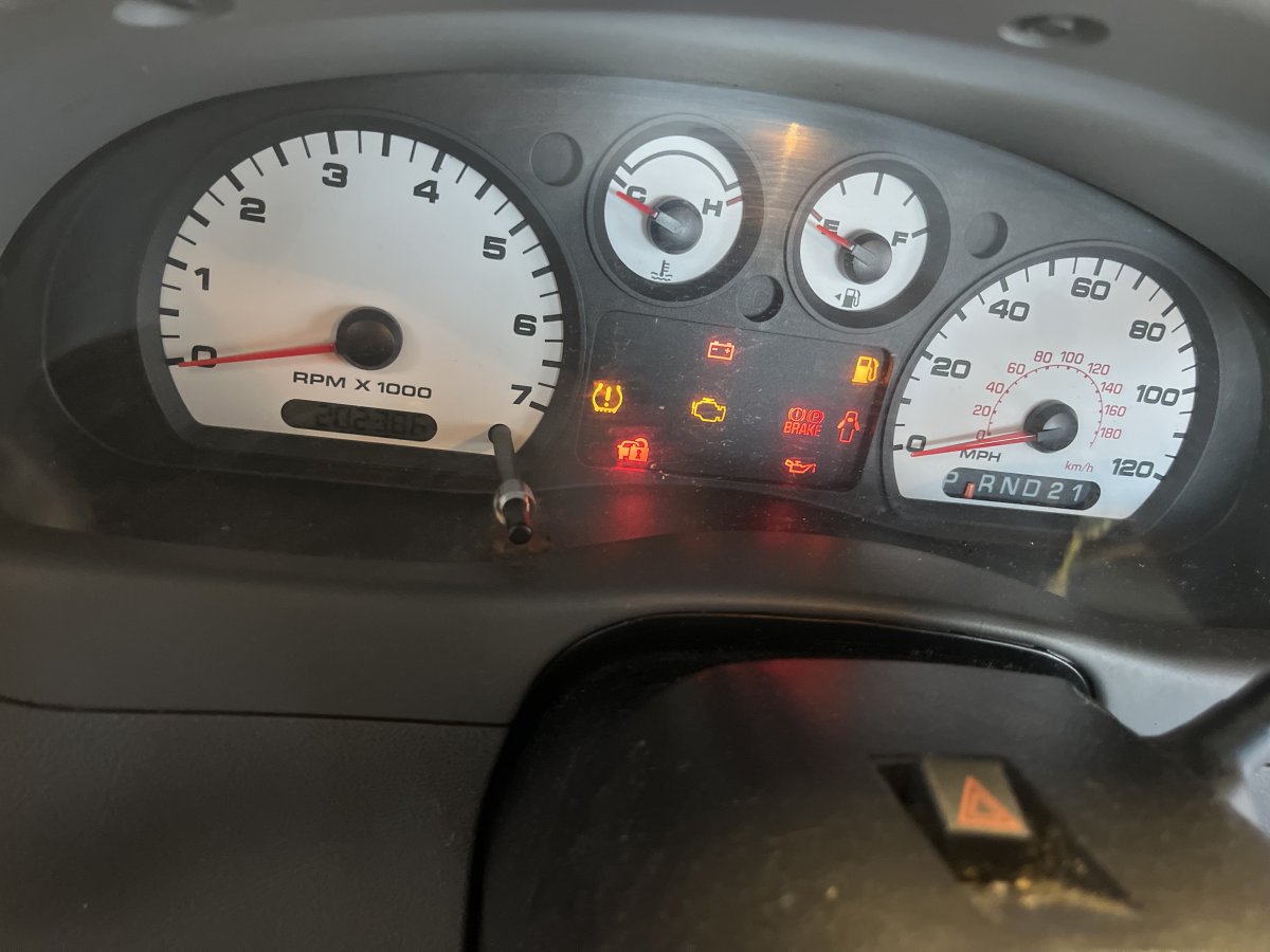

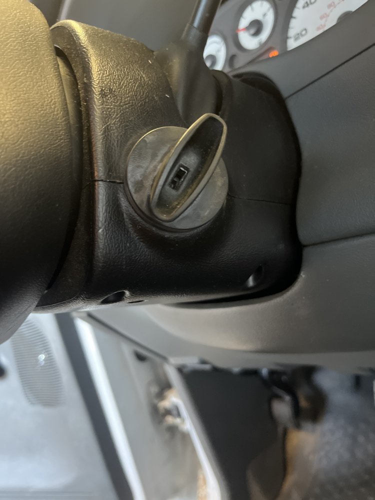

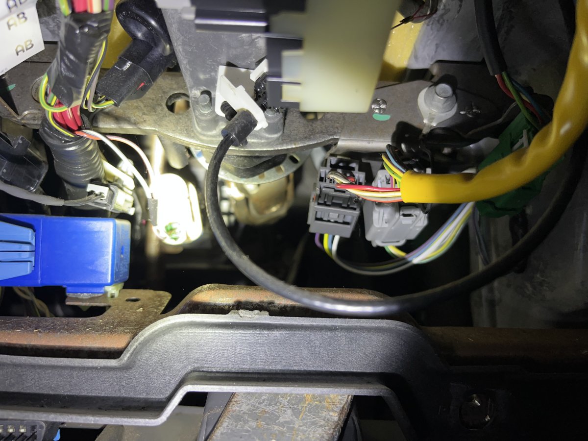

Good afternoon! I have bought a vehicle without the keys. 2008 ford ranger sport 3.0. I see that this is a chip key. Unfortunately when the previous owner lost the key he drilled the ignition. I can turn the key onto start position without they key. However the security imobilizer will not allow it to turn over. Can i jump wires to bypass this

Best to replace the lock cylinder and get a key. I may be mistaken but I think ForScan can program the key to truck. ForScan is a Ford scanning software that is downloadable.
Welcome to TRS :)
In a word, No
There is no way to bypass PATS in pretty much any year or model Ford, it is that good, lol
Best, cheapest, option will be to have a Mobile Locksmith come to vehicles location with a laptop and Ford software, he can program new PATS keys that will be recognized by the PATS/Computer system
You can buy a new lockset(ignition and 2 door locks) with 2 new PATS keys
You can install these first so locksmith just needs to program the new key numbers into the PATS/computer system
It still takes an hour to add Keys to the system, sometimes longer, this is on purpose so a car thief can't just add a key and drive off
If you can tow or trailer the Ranger for free to a Locksmith that might be cheaper, so he can do other things while waiting for the system to accept the new keys
Ford Dealer can do this as well but not the cheapest option
You do need to show proof of ownership with the above, so have those Documents handy and your ID
And since you have never started the vehicle, there may be, probably will be, other issues, but since PATS disables fuel pump and injectors that's the first hurdle to get over
Make sure there is oil and coolant and also FRESH GAS, gasoline only lasts 5 to 6 months in a gas tank, after that its no longer "fuel", it's a good weed killer, but not fuel :)
