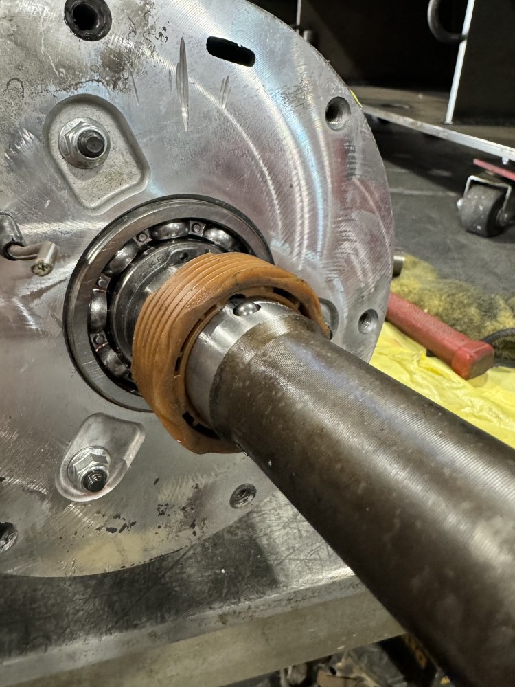

The check ball pocket that holds the drive gear on BW1356 (shaft diameter is the same for BW4406)

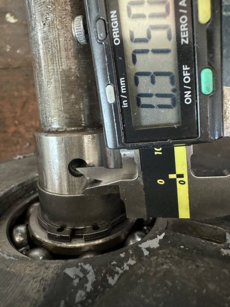

Measurement of 1/4 check ball above the output shaft and distance from retainer clip to center of pocket

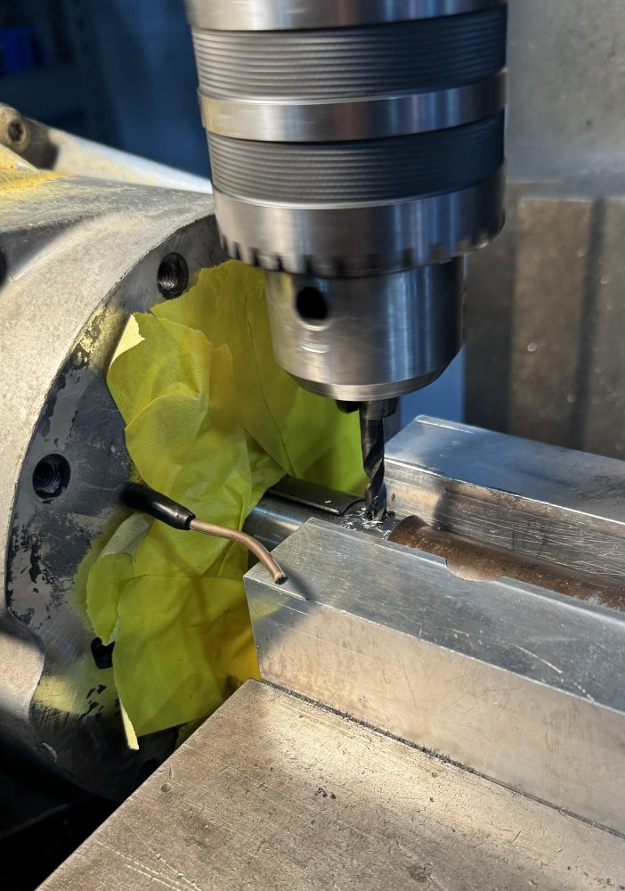

Into the Bridgeport. 1/4 carbide drill to a depth that the ball sits .085” above output shaft

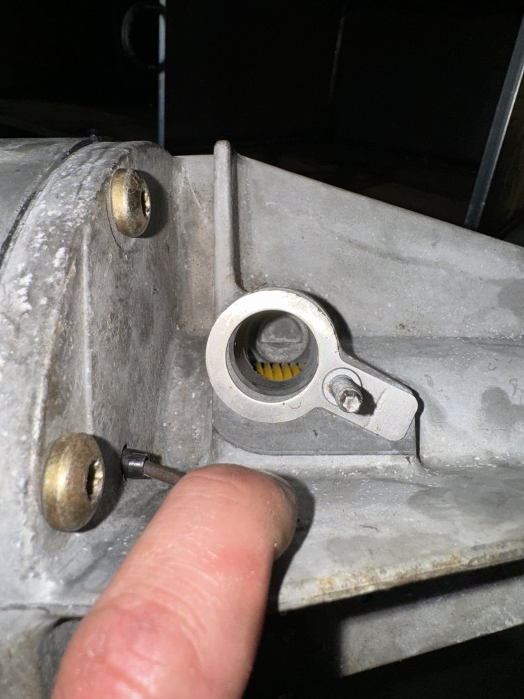

FINAL ASSEMBLY
