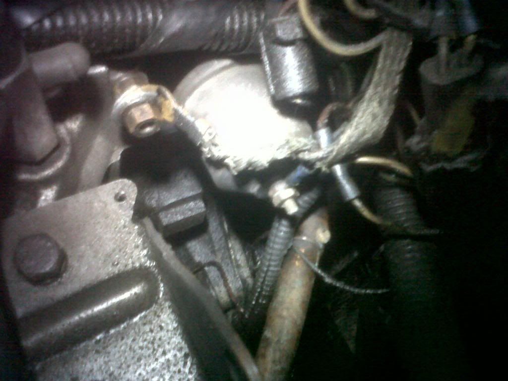

I know the ground strap goes to the last intake stud...it should have a threaded end on it...as for the other "wire" that is probably the oil sending unit...

Thanks. I figured that they go on the stud but can't tighten them down. I think they both go on the threaded stud.

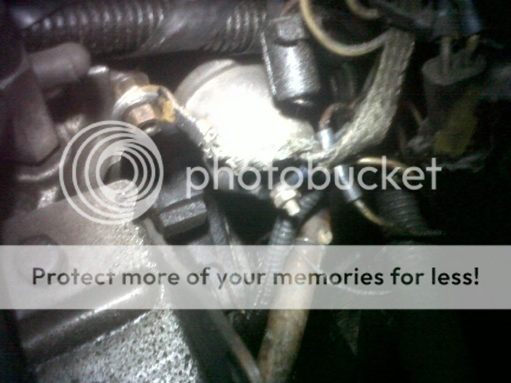

Well, yours may be slightly different than mine...I took a pic of mine but remember this is a carbed application...and you will notice the carefully shaped grounding strap on mine that took years to perfect...:)
The oil sending unit is right beside the ground strap connection...those were the only two that I had to remove to take the head off mine...

I have a bolt with a stud that goes into intake. Also have a nut for it. But I can't get the grounds tight. Yours is a little different. How did you get your ground tight? Did you put on a washer or something?
I actually put two washers on either side...you can probably see that in the image...but the ground strap had a little burr on the end that was, I suppose, meant to stop it from spinning...but it just got in the way so I filed it off and used the washers...
If you have some dielectric grease you might want to put some of that on...or vaseline...or even silicone spray...the washers can rust and cause more problems if not treated.

Yea I seen that little thing. Looks like it goes into a groove somewhere. I might just take bolt back out and put both wires there and tigthen down. I wish I would have payee more attention to exactly how they where. I thought they would be in a little groove somewhere.
Anybody know exactly how the wires go? Do they need to be tight?
not sure about where they go, but they are ground wires so being tight is critical to their function...sorta like loose battery terminals...
