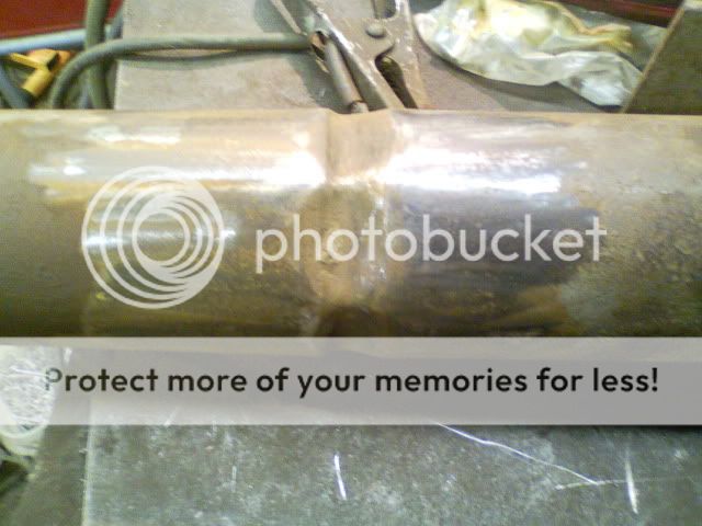

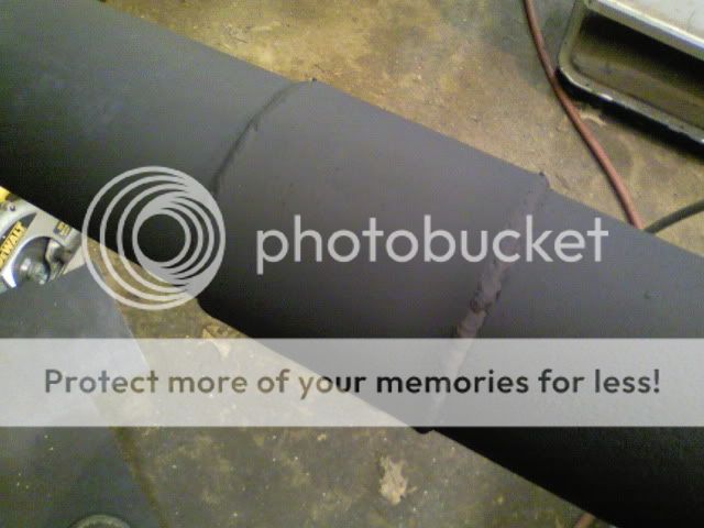

Here is what the drive shaft looked like from hitting the gas tank skid, it wasnt bent at all just dented up, no vibration at 70 mph on the freeway. But I figured I should reinforce it anyway.

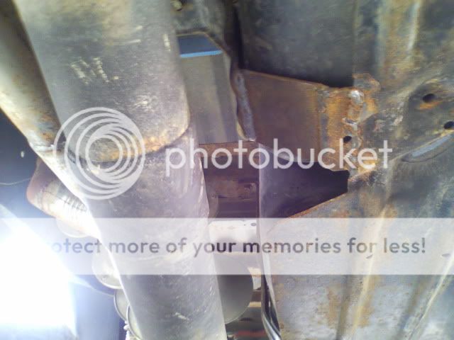

I trimmed back the the skid and reworked the support to clear the shaft. The bottom weld looks terrible in this picture for some reason, but its and nice bead up close.lol

we are slow at work today. so i will get it on the lift today and see if i can get anything done today for it. pics def help bc i didnt know exact where it was hitting. thanks again seth. kind of surprised it rubs towards the front of the tank more than the rear.
The diff is offset to the pass side, but the tcase output is centered, so the front is closer.
