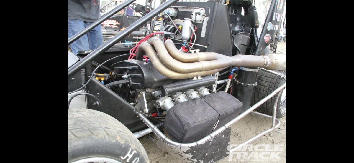

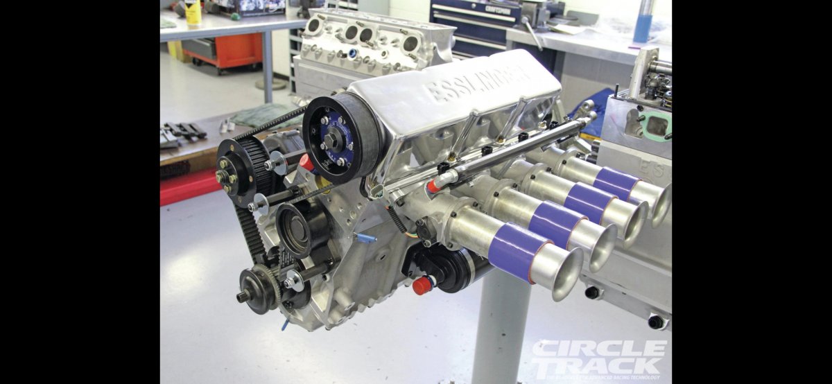

A complete Esslinger USAC sprint car engine will run you about 25 grand...
Thats how you get that much power, a large wad of cash.
What is the upward limit on them with a HC build, stock parts ported, forged pistons, cam, etc.
I dont need a rocket. 150 at the crank would be nice.
The entirely forged, not one stock part, injected sprint engines make about 350hp naturally aspirated and they can last for multiple seasons (these are sealed engines I believe, open engines undoubtedly make a bit more power). There is a turbo drag engine that makes almost 700 but I'd imagine that engine needs to be rebuilt after around every 30 seconds of run time...
Neither of those engines use a single ford part though, even the blocks are made by esslinger. They are just based off the Lima. But when people talk big power Lima's turning 9k these sre the engines they are referring to. You can't build anything like these engines with ford parts.

There are some making 700hp Turbo charged obviously. Well like I was saying there are dirt track guys spinning these things out to 9 grand. Unless they are seriously cheating or tech inspection lets these guys slide they are doing something to the bottom end and valve train to allow this to happen. I know lil to nothing about the lima, except mine got 9.25mpg and used a quart of oil every 110 miles. Peak horse power at 9 grand isn't the goal its to ride the gear out as long as you can. Sliding around a circle track is a lil different than a straight line we can agree on I would imagine. I know a guy who had a built 351 Cleveland he spun that up to 9000 rpm and was pulling past other guys who could only turn about 6000-7000 rpm but making more power.
As I said, the engines capable of doing that are NOT ford engines. They are aluminum block full roller, fully forged engines, girdled to death with massive high pressure dry sump oil systems. There's no cheating involved, they are simply purpose built race engines. They share the basic design of a Lima but nothing else. You can't pop an engine out of a ranger and turn it into one of these.
