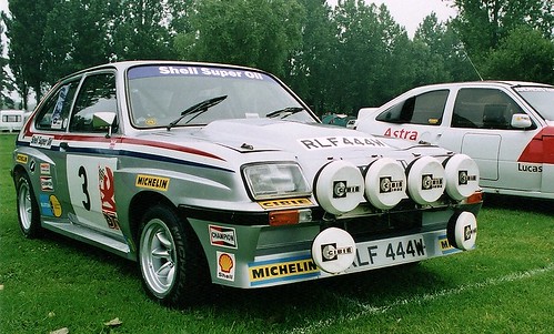

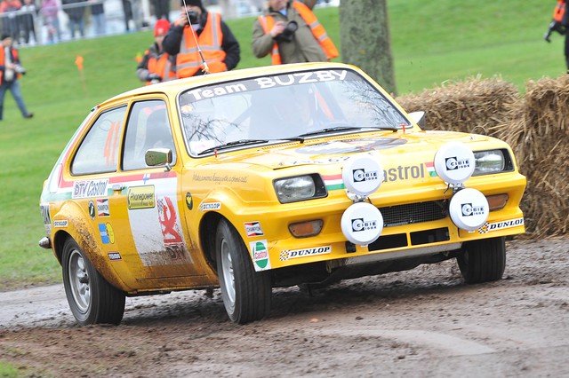

What kind of parts go in to cars like this? I know safety stuff like cages and rally computers. But what else? Any suspension upgrades? Do you have to run at night at all and have extra lights?
I'm definitely going to work in some suspension upgraded. something to improve the damping while maybe offering a touch more ground clearance.
There's some pretty interesting stuff in regards to lighting in terms of position and number. I had only ever seen cars with an even number of lights but it's actually a requirement as well.

The lights on the Lancia are quick detach, you don't run the extra's in daytime

I would think (4) lights would suffice. On the top of my Ranger, the middle to light up the road ahead - one slightly off right - one slightly off left, and then the outer (2) light upo the outer areas. Anything more than that and you'll be eating up a lot of juice.
I have 2 spare lightforces kicking around I'm going to use for now.
