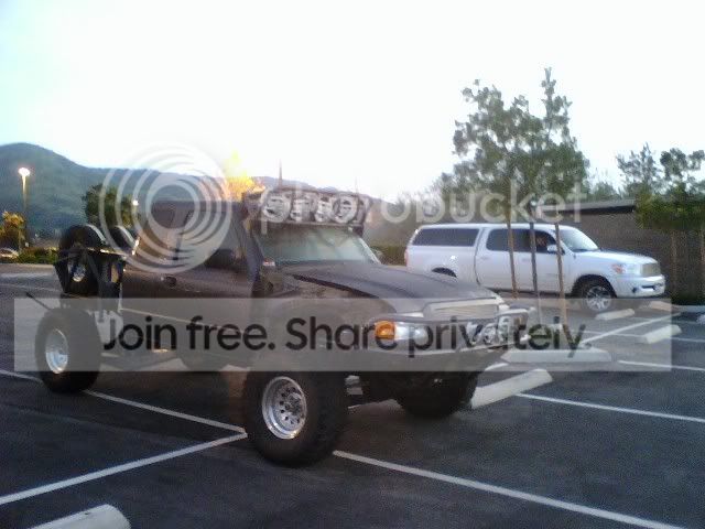

Here are a few pics of a sweet ranger prerunner to help you out with the setup.

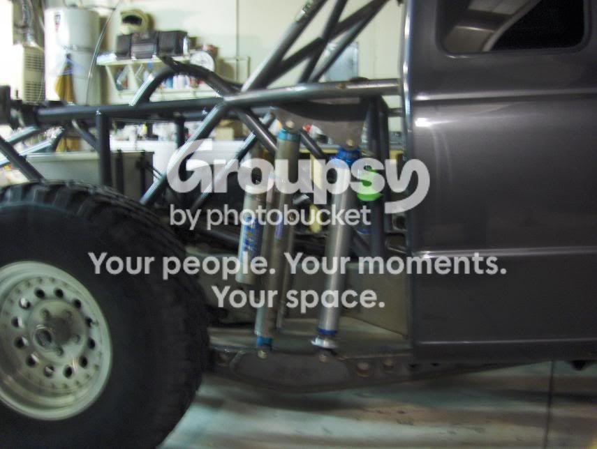

first off thats a sweet ride second i guess im leaning more to the full on prerunner. i want to be able to handle the jumps but not blow all my money on the truck. my price range is around 4,000. I do have a question about the ride on the pic. i see what looks like two types of shocks on the rear. From what i thought all i would need for the rear is the bed cage, 2.5 reservoir shocks and what the shocks connect to. Im positive im leaving out more of course. Sorry im just still tryin to comprehend the rear suspension.
Do the deavers with a shackle flip (to a tension style shackle) and mount your shocks from the bedcage. There's not much more to it on your setup.
That trucks running bypass shocks w/ resi'd coilovers on a triangulated 3/4link setup... little more $$$ on that setup, haha.

in the pictures posted above, that truck has a 4 linked rear end. the links replace the leaf springs, so on each side he has a coilover, and a secondary bypass shock. the bypass shock allows greater fine tuning of the suspension travel.
