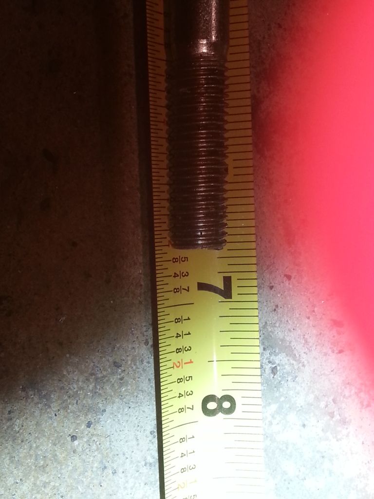

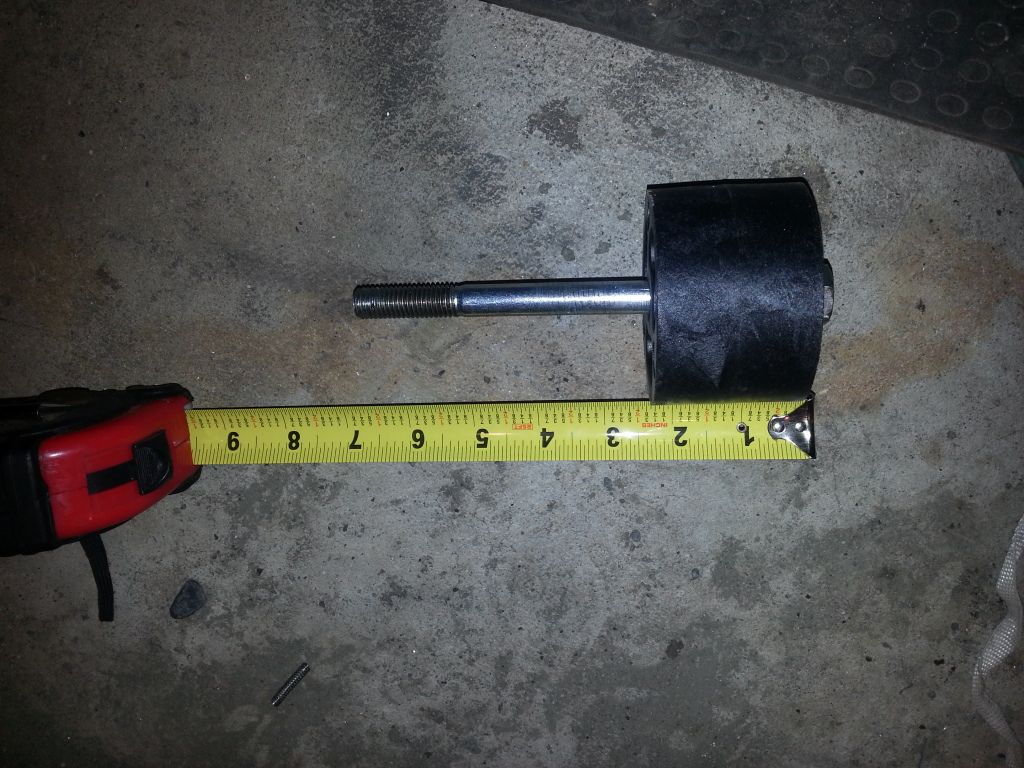

Any who I bought a 2 inch body lift. There is about an inch of bolt left over. You could probably make it work but id go atleast 1/2 inch longer. So say 7.5 to 8 inches. Get thicker washers.all of mine warped before I got them torqued down
Also... you can buy the pucks for like 5$. Not sure if this is your school project or what. Also I didn't use the steering or shift extention. Several ppl have used the 3 inch on a b2 and only used the pucks nuts and bolts.

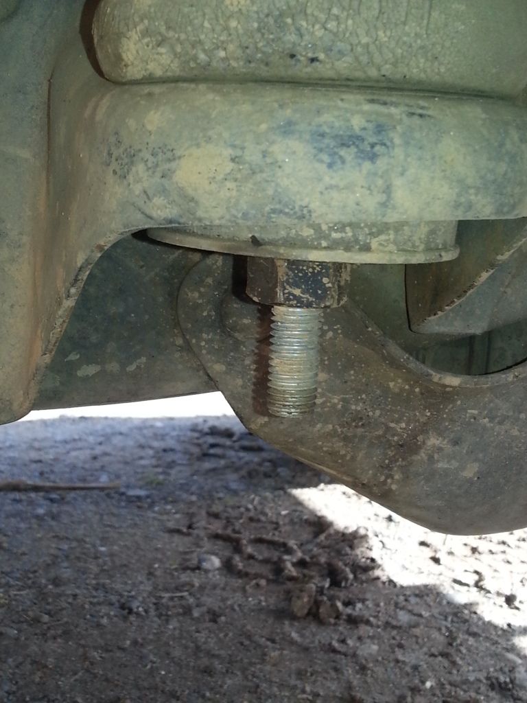

I really just want to tell you it's easier to buy a pa body lift and be done with it. The actual "lift" is just spacers that go between the frame and the body mount bushing. If you're set on making the spacers, cut lengths of 2 1/2" or 3" steel pipe to 1/2" shorter than whatever you want your lift to be. Then you can weld 1/4" plate steel to the top and bottom, drill a 9/16 hole in the center of the plate for a 1/2" bolt, at least a grade 5. It would be better to put a pipe with an inside diameter of 5/8"ish in the center of the big pipe, and weld the plate to both pieces of pipe, making it almost impossible to crush. You will without a doubt need a body mount bushing kit unless they've been replaced recently, and be prepared for a lot of work getting the old ones apart. I think most of the stock bolts are 3 or 3 1/2 long, so you're looking at 6-7" bolts for a 3" lift. You'll also have a steering extension to make. Unless you can get material for free, it really is gonna be easier and cheaper to buy the pa body lift, imho.
