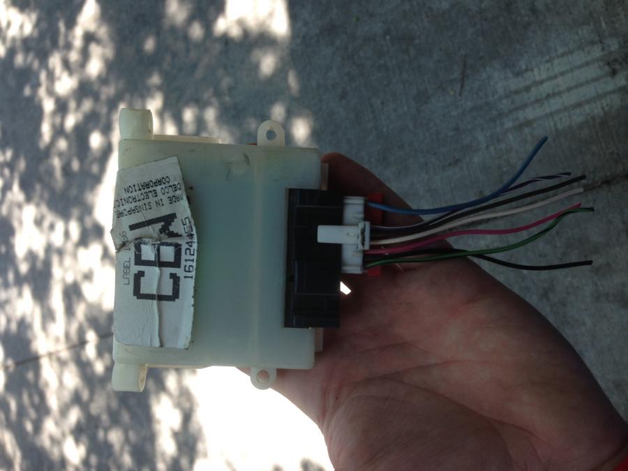

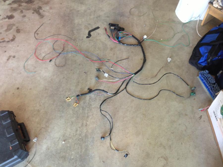

finished the wiring harness, looked at the ecm and found a little white box screwed to the back.
that is the DRAC, on chevy's the VSS goes into that and it converts the pulses to a signal that the cruise control, abs, speedometer, and ecm can use. It calibrates the signal for tire size and gear ratio basically.
so not needed since i can run a vss signal directly into the ecm on a later date.
No the VSS goes into that box on the Green/Black and Black wires that are right next to each other then I think it's the blue wire that goes to the ECM. The wiring diagram will show it. That box has to be between your ECM and the VSS
so this lets this the ecm understand the vss
i believe i dont have that diagram
we didn't use the DRAC on ours, because we didn't use the VSS.
not all tbi ecms came with a DRAC module, or an ETM (elapsed timer module) on models that had a drac, it needs the drac to use a vss. and on models that came with an etm, the etm needs to be present at all times for it to run
ok. thanks for the answer was really wondering if i should throw it away or keep it, ill mount it but not hook it up or anything.
