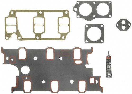

here is the 2.9 intake manifold gasket, I call attention to the evenly-spaced intake ports

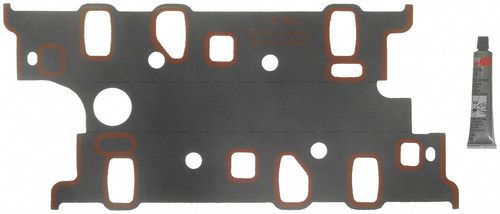

here is the 2.8:

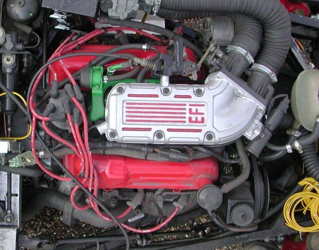

the euro-2.9 intake manifold: it looks pretty cool, and has a massive dual-bore throttle body like the V8s

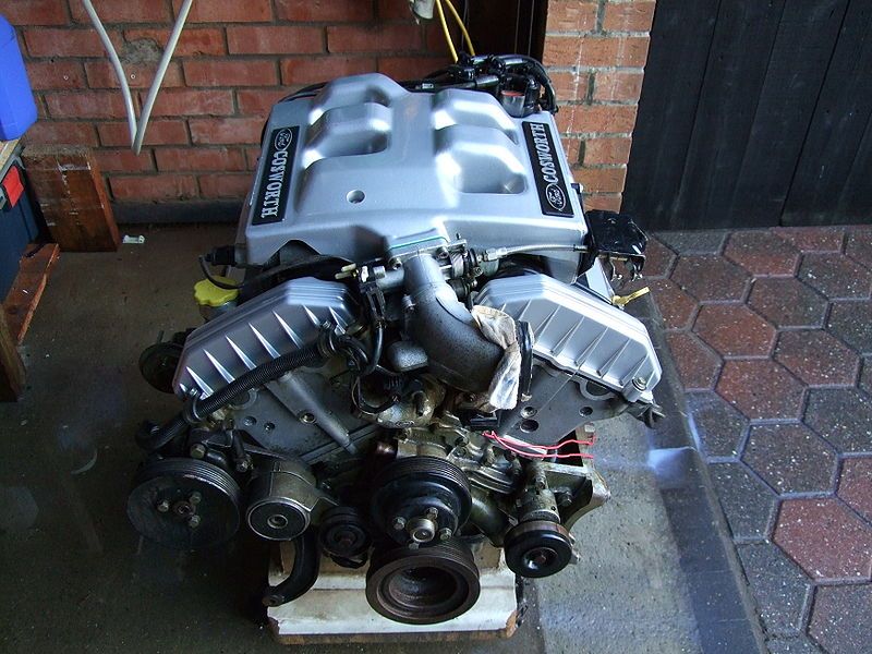

and the cosworth, quad cam 2.9, which actually used basically the same block as the us2.9:
Those are sweat lookin. Do you have a pic of the eruo 2.8?
