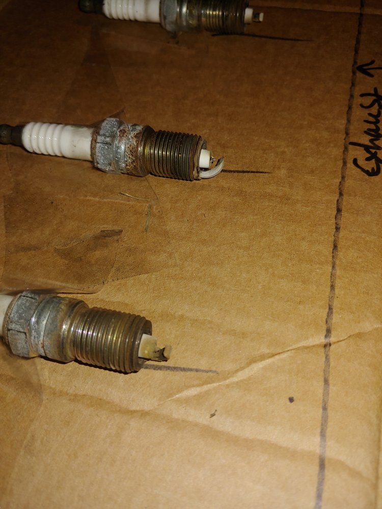

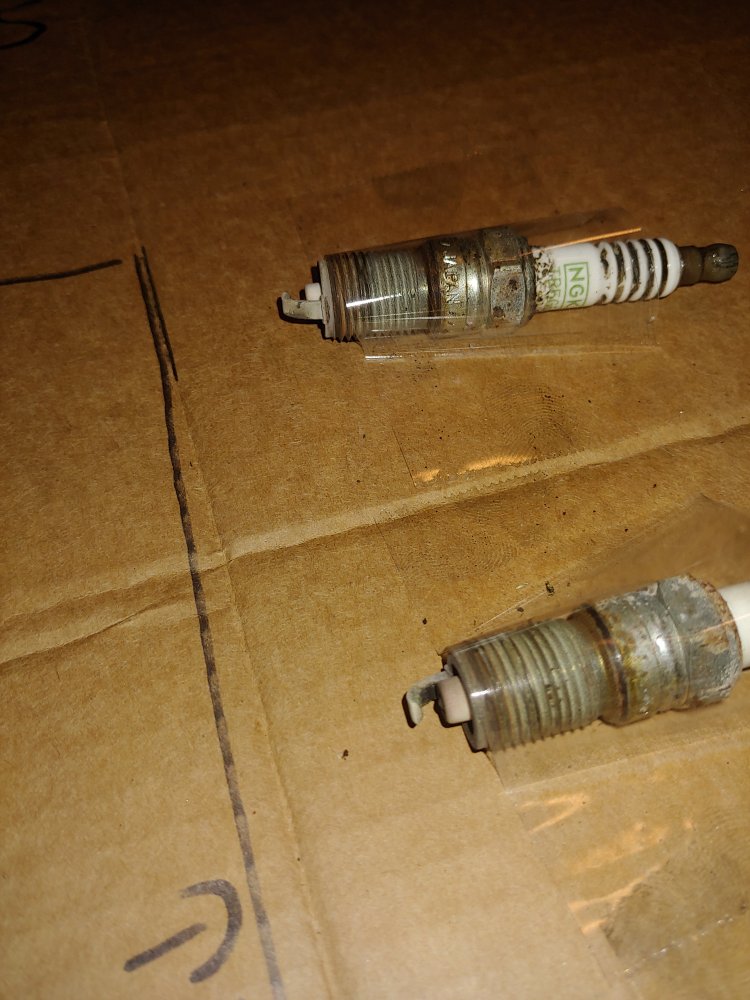

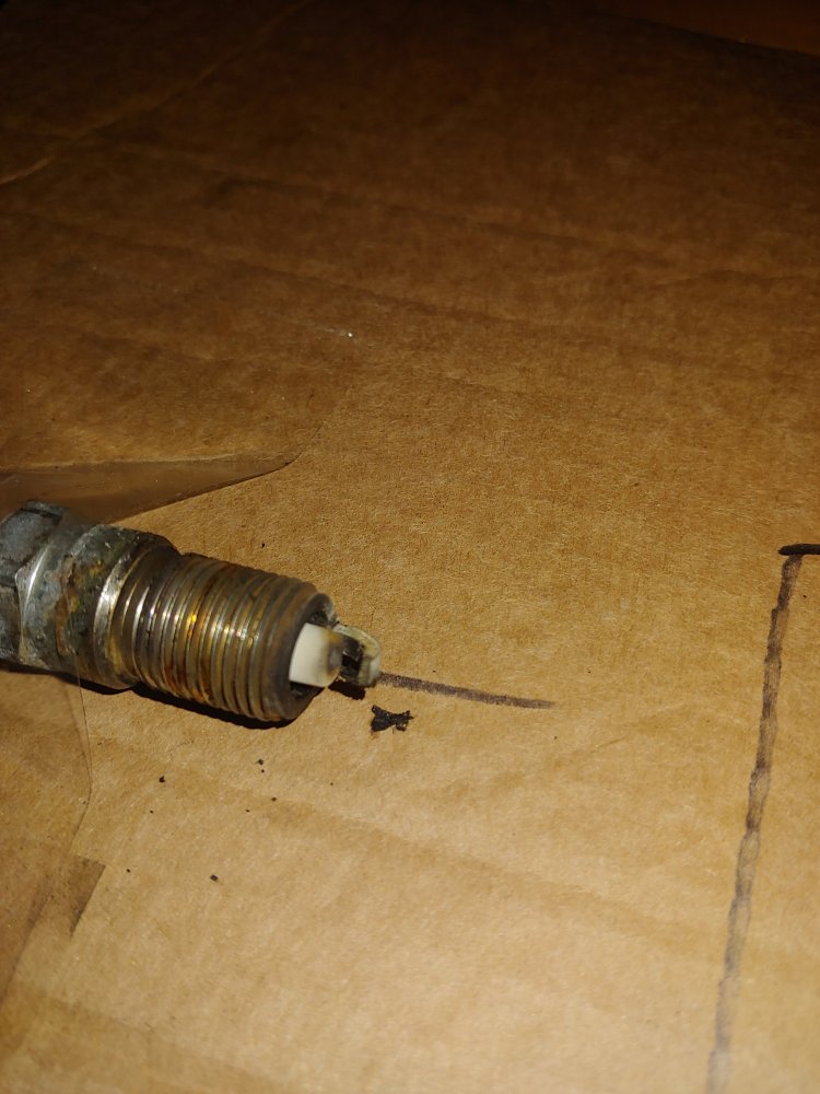

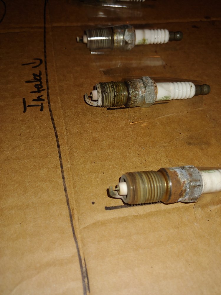

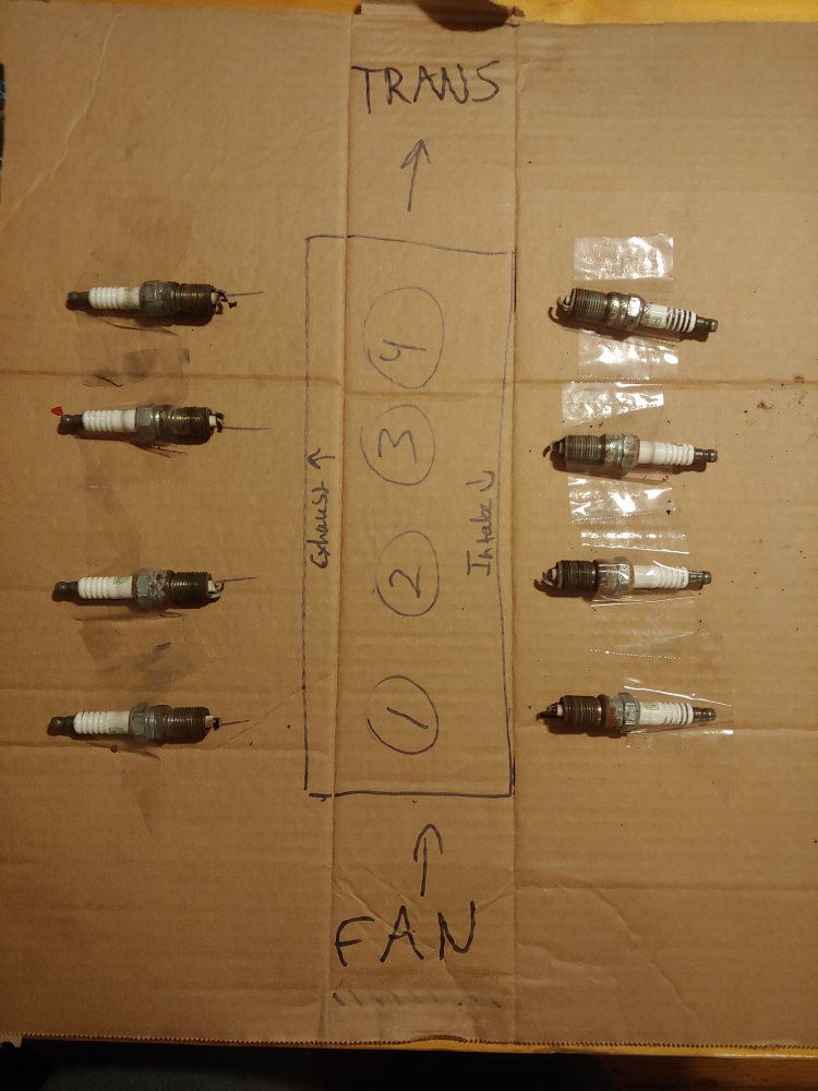

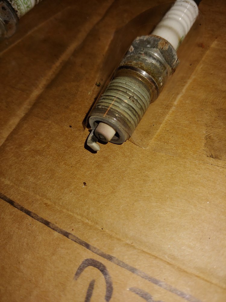

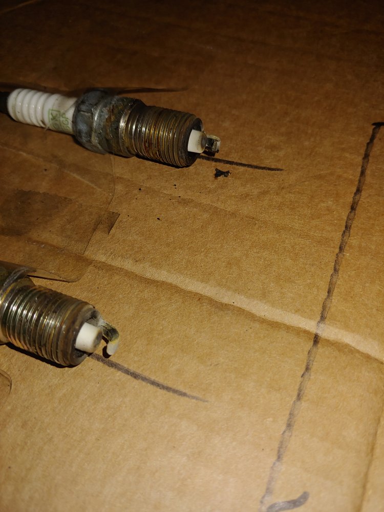

The plug wear us interesting. I'll upload pictures later. The plugs of the two cylinders towards the rear of the engine (3 and 4, presumably?) Had the electrodes basically melted off flush with the ceramic. The first 2 cylinders had electrode wear, but nothing like that. The wear on those seemed reasonable enough.
Ok, here are the old plugs. These had somewhere between 40k and 60k on them. I think it was closer to 40k but I don't remember exactly when I changed them. 2nd pic is intake side, cylinders 1 and 2. 3rd pic is exhaust side, cylinders 1 and 2. 4th pic is intake side, cylinders 3 and 4. 5th pic is close up of wear on intake side, cyl 3 and 4. 6th pic is exhaust side, cylinders 3 and 4. Very last pic is a closeup of exhaust side cyl 4, had some black gunk on the finger when I pulled it out. I don't think it got dirty coming out, the black gunk was like between electrode and finger when I pulled it out so I figure it was like that in the cylinder
What do you guys make of this wear on the cylinder 3 and 4 plugs? I was suspecting leaner condition in those 2 cyls based on the electrode damage- am I interpreting it right? If so, could it be that the injectors on 3 and 4 are a little clogged and would this explain a lean condition in 3 and 4

Get some OEM plugs. Motorcraft or Autolite. The center electrode wear is something I have not seen previously. I have seen them with very rounded shape, no corner or edge at all, but never worn like that.
I think I would be looking for a leak that allowed #3 & #4 to run lean. Lean will give hotter temps, and may be the cause for the wear. Nothing against NGK, but but but... try some OEM plugs. Or AC/Delco, I think their electrode material is a bit stronger. I definitely do not recommend Champion as their electrodes did not last in the ones I used.(not in a Ranger)
If you have a vacuum line that is plumbed into the intake... feeding #3 & #4... it could have loose fitting, or a crack that opens up when the engine torque loads the mounts, and forced the engine to tile a slight bit. The corrugated air feed tube has broken on some, and has lead to extra air the MAF didn't know about...
I did not look at the other plugs, just the exhaust in those two images. the #2 plug looks as if it is VERY lean, with zero deposits on the center ceramic. #3 and #4 are a bit lean looking also, though not as much.
I do not have this thread in my head, so ask. Did you check fuel pressure? Did you measure fuel delivery volume? Pressure is not enough, the pump may(will) develop good 'dead head' pressure, but fail to deliver volume enough to run the engine. Notable especially if you do a long hill climb, or cruise at highway speed and then try to accelerate. If fuel delivery is marginal, it will likely become more apparent when it has been running 'at the limit' for a while(cruise @75 / hill climb) and you THEN ask for more...
You can test volume by jumpering the relay or EEC-IV plug, and using a gauge/bypass to capture volume over time. Then do some math...
