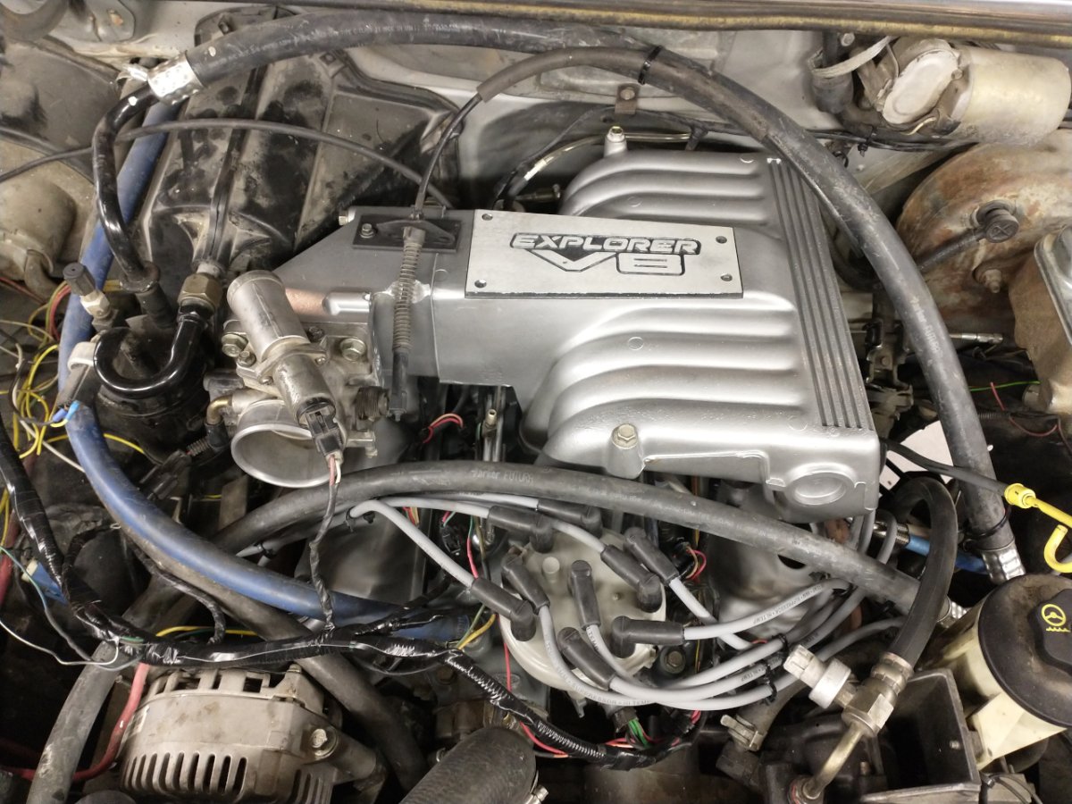

Setting the upper in to place revealed interference with the evaporator plenum. There were many ways to correct this, but since I spent a great deal of time getting the engine in it's current position I decided to mill half an inch off the intake elbow. I would have liked to have taken off more, but the EGR ports were getting thin. I may be able to mill right past the EGR ports if there is still interference under load.

I got it started, waiting on an air filter before the first test drive and tuning session. I predict it will pick up some low end torque and run much cleaner with the EFI.

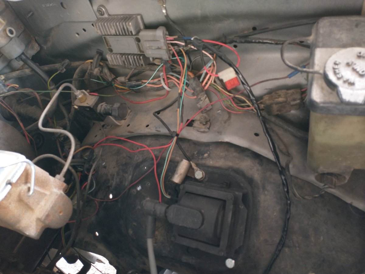

One of the reasons I like HEI is you don't need all this:
74206
The distributor I used came from the long block (1992 Bronco 5.0), which used an external module. Since I had all the parts to complete wiring this way (my '88 460 F250 uses the same module and I had a spare), I went ahead and ran it. The remote-mounted ones are more difficult to wire, but don't suffer heat-related issues like the dizzy-mounted setup. The fuse isn't a fuse, it's my impromptu SPOUT connector.

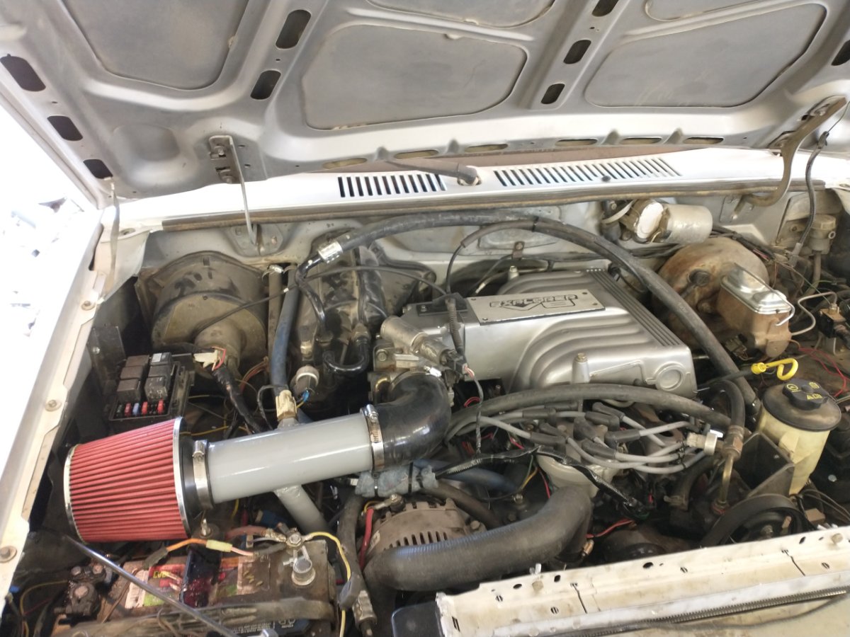

Air filter and rubber elbow are cheapo Amazon fare, I may change the element or run a pre filter in the dirt. I prefer paper over washable for off road.
74207
-Also need to figure out a heat shield around the filter, so it pulls air from the 5" hole I cut in the inner fender instead of from under hood.
I ordered a small 6 position fuse box to clean up that atrocious positive terminal.

I've got about 30 minutes seat time tuning with the laptop and it's already way more accurate than the carb could ever hope to be. This engine runs flat top pistons and likes to ping at WOT. With the HEI I could only pull timing, with the MS I can tune right around the ping.
