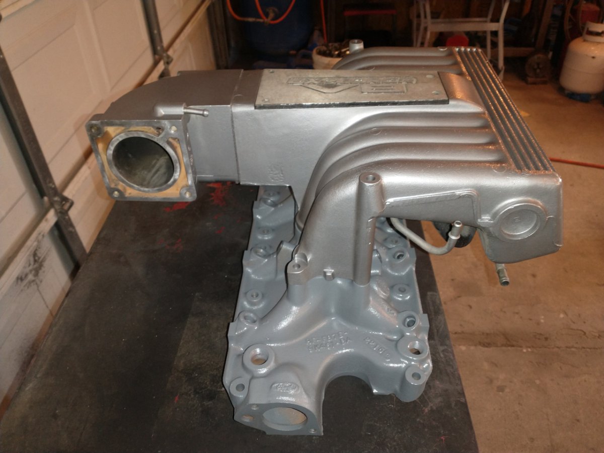

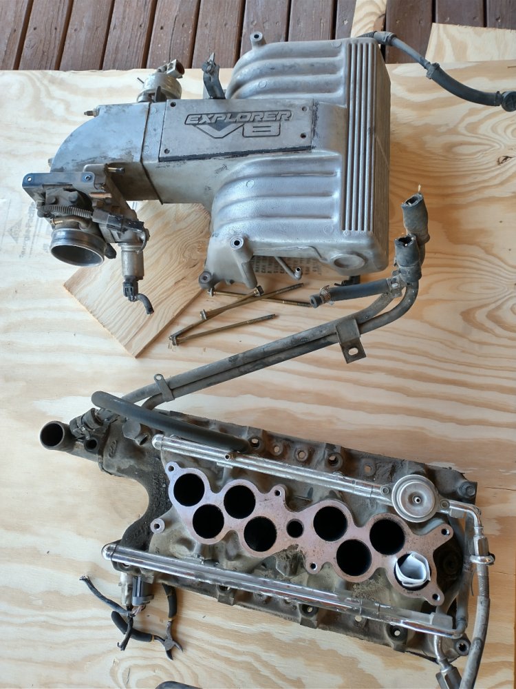

I picked up the early Explorer intake a few months ago and got it cleaned up and painted.

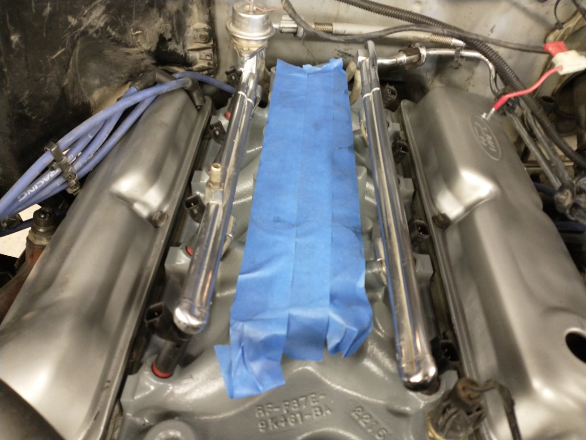

The injectors I scrounged from my junk drawer, out of a Dodge product. They are 23 lb-hr Siemens units with an ev6 connector. The harness is the original feedback carb harness that mated to a 60 pin Ford ECM. I had to make a few modifications to match the MS 1 ECU, and it's installed with a DIY MS to 60 pin adapter.

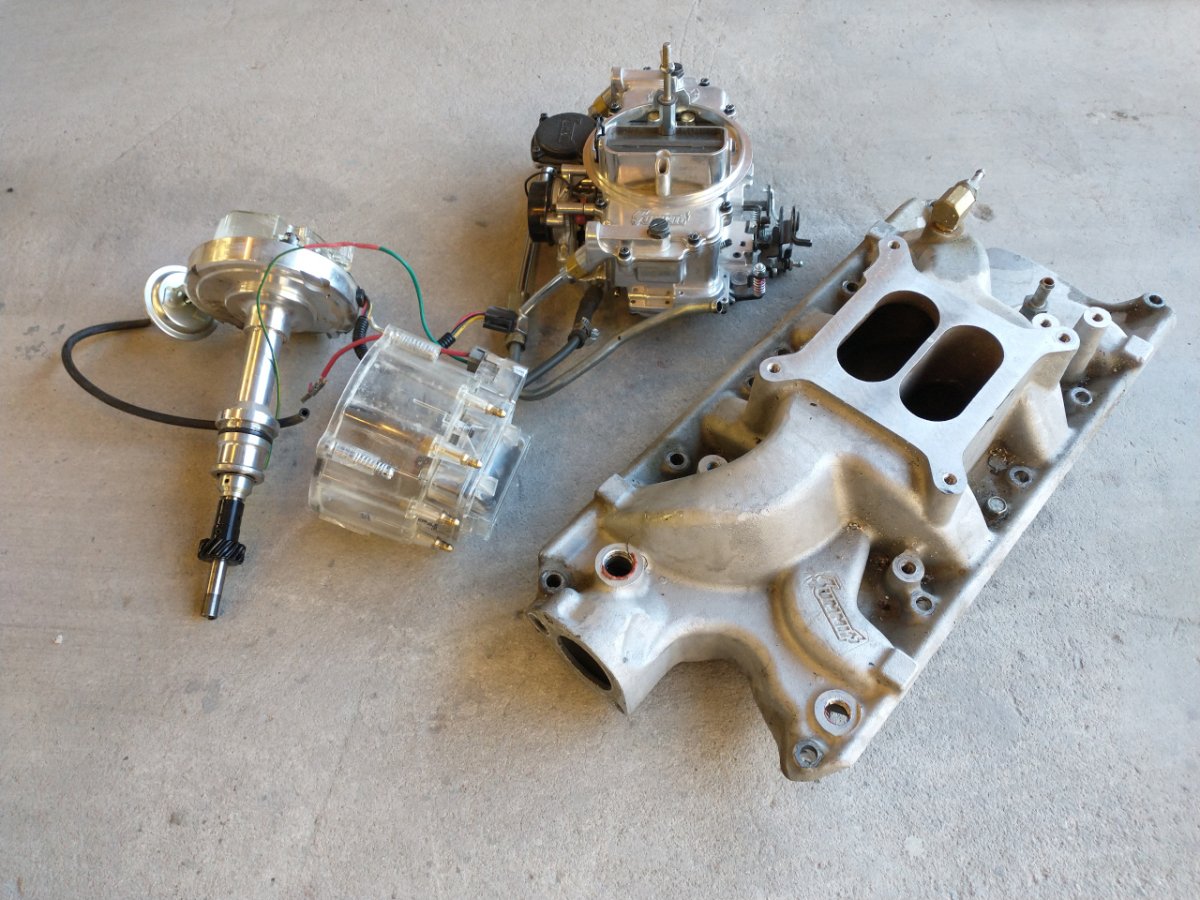

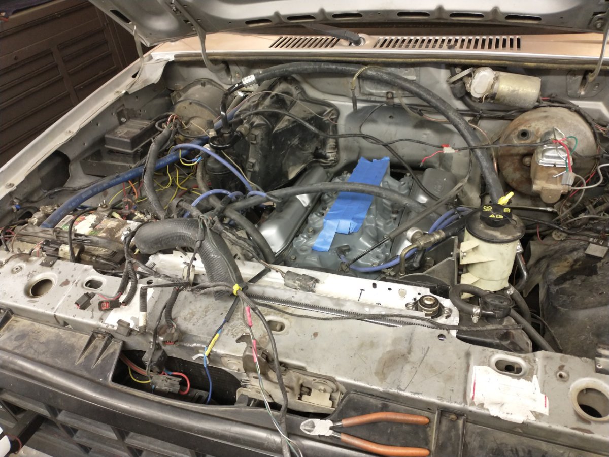

The first step was to get the engine to TDC, drain the coolant and remove the HEI and dual plane intake.

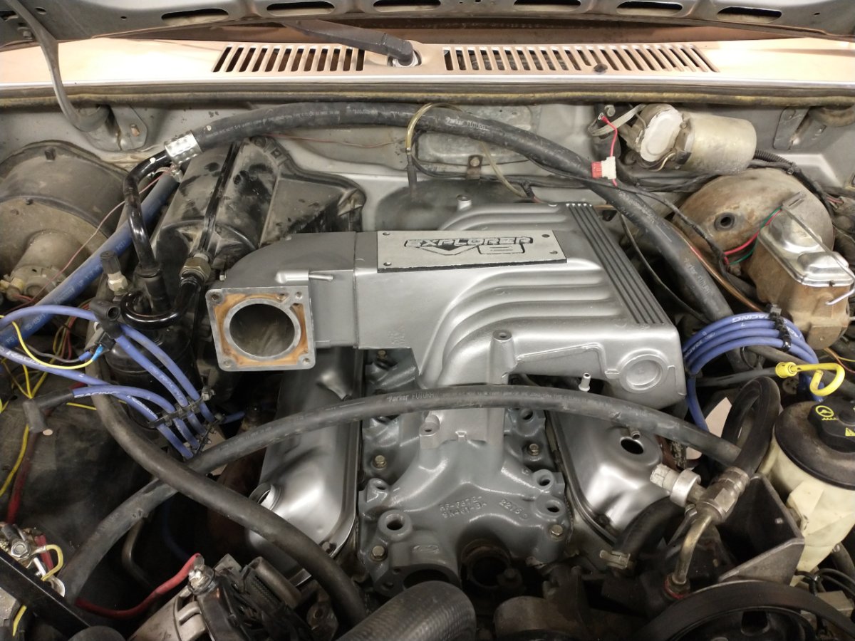

I installed the lower with Fel Pro gaskets, ditching the end rail gaskets in favor of a 1/4" silicone bead.

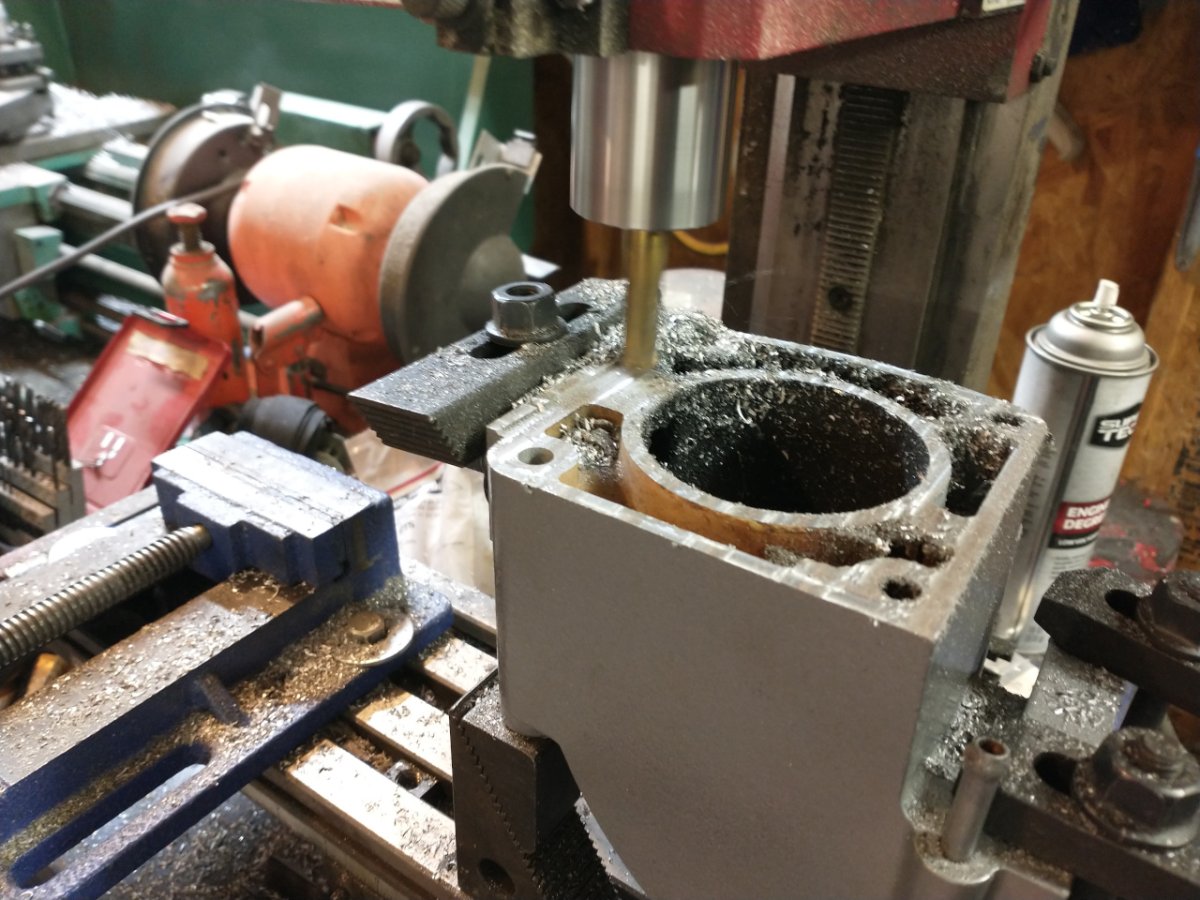

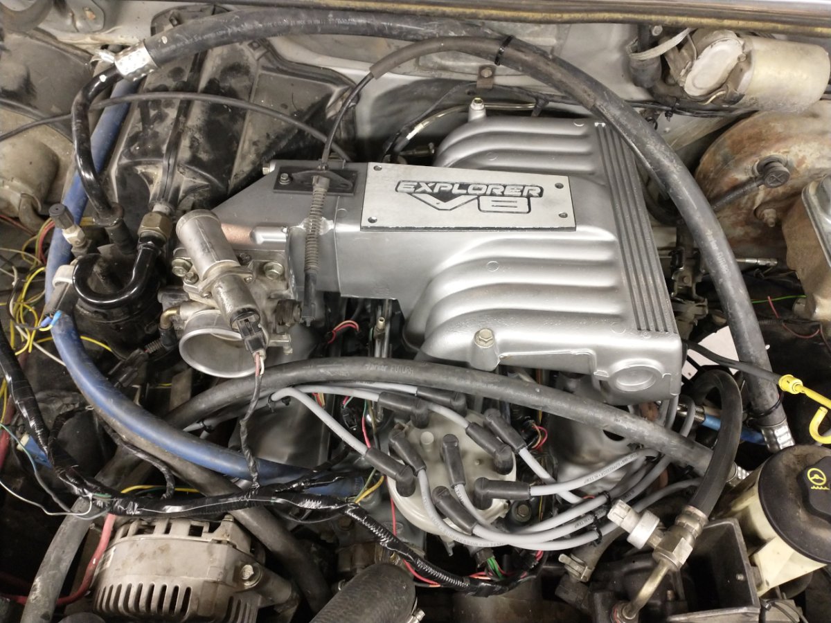

Setting the upper in to place revealed interference with the evaporator plenum. There were many ways to correct this, but since I spent a great deal of time getting the engine in it's current position I decided to mill half an inch off the intake elbow. I would have liked to have taken off more, but the EGR ports were getting thin. I may be able to mill right past the EGR ports if there is still interference under load.

I got it started, waiting on an air filter before the first test drive and tuning session. I predict it will pick up some low end torque and run much cleaner with the EFI.

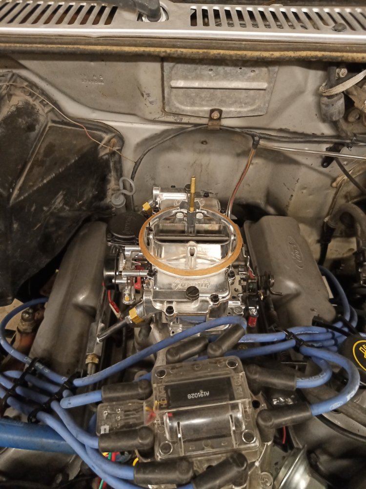

One of the reasons I like HEI is you don't need all this:
74206
The distributor I used came from the long block (1992 Bronco 5.0), which used an external module. Since I had all the parts to complete wiring this way (my '88 460 F250 uses the same module and I had a spare), I went ahead and ran it. The remote-mounted ones are more difficult to wire, but don't suffer heat-related issues like the dizzy-mounted setup. The fuse isn't a fuse, it's my impromptu SPOUT connector.

Kinda here nor there at this point but I believe the upper plenum you used can be rotated 180 degrees so that the inlet is on the driver's side. I have a Crown Vic upper on mine that is rotated that way from the factory and it worked very well for clearance... you might run into your power steering reservoir with the intake tube if you did that though.
