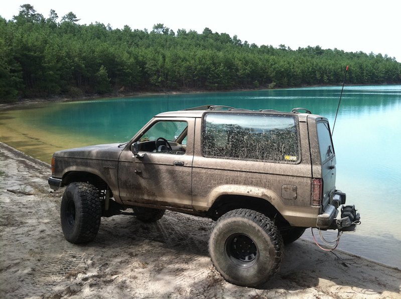

to be honest i do not know what kind or even how big of a lift it is...im thinging it has to be at least a 5-6 inch to tuck 35's with some room right? i bought the bII for 260 and all i did was drop another 2.9 in it bc the other had cracked heads and what not
If you're already a D35 in the BII, just swap the axles and everything over.
how big of a lift do you think it has? and is it really worth doing the swap because im having second thoughts
where u located at man, that looks like a truck that was for sale in jersey a while back, kid that built it lived town over from me, its got about 5.5" of lift, 5.13's front and rear lockrights if im not mistaken, the rears will bolt right into the explorer, just have to move spring mounts on the rear and get a new center pin, just make sure the explorer yhou buy is a stick otherwise you will be disappointed
