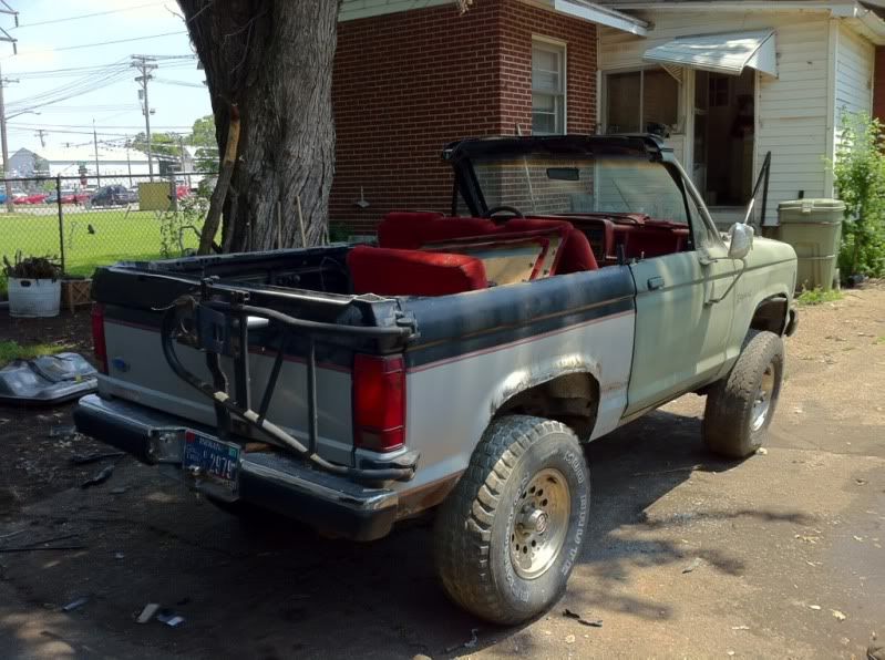

well i picked this bronco ii up for 200.00 i been working on it for a few weeks now
i thow some pics from start to now for thows that care lol
2inch lift here coil sping spacers and shackels
also trimed fenders 2 inches on 31s
topless
bed rails and tool box
biger tires went to 35x12.5x15
then i picked up some xj springs
removed the sping spacers and installed the xj spings
and were i am as of today filling in window chanels in and refit the door panel
little metal work
shoulda went ahead and did half doors like my old ones.
makes it nice, exspecially when you can just pick them up and set them off and run no doors if you want.
