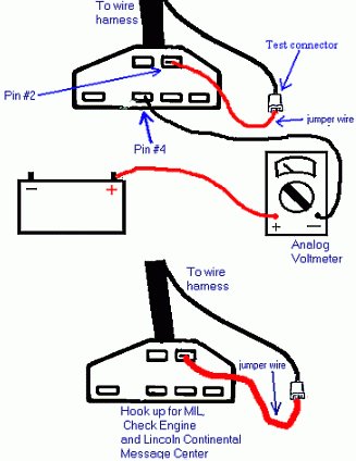

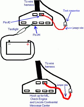

Have you pulled any codes off the ECM/ECU? Also, I would clear the ECM after changing any sensors, etc.
I didnt know you could pull codes on something this old, where do you plug in to? Also how do you clear the ECM?
The test connector and self test input connector are located on the passenger side firewall near the fuel pressure and ECM relays. Make sure the trans in neutral (manual trans) before pulling the codes. Check https://www.troublecodes.net/ford/ or https://www.2carpros.com/articles/f...gnostic-trouble-code-definition-and-retrieval for more details.
To clear the ECM, remove the negative battery cable for at least 5 minutes.
Yes there can be codes.
