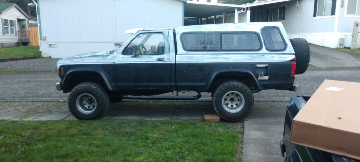

I did this just last fall on my 87 Ranger, I removed the centerline tank and installed BII tank behind the rear axle.
I have the skid plate off so I will shoot some fresh pics of it. I used the forward fuel tank support bracket from the BII but in the rear I just slid the rear Ranger tank support bracket forwards, then used the stock straps.
I had to lengthen the fuel lines, the power control wires and add a fuel filler door/access to the rear quarter panel.
This shows the fuel access, in progress. If you look closely, the tank is visible behind the axle. This has a body lift, without the body lift, that tank would be much more visible.

Here's some pics of my install. I made my own crossmembers, but still used factory straps and the factory skid plate.
I have about 1/2" of body lift, and I also clearanced the bed by cutting out one of the supports.
