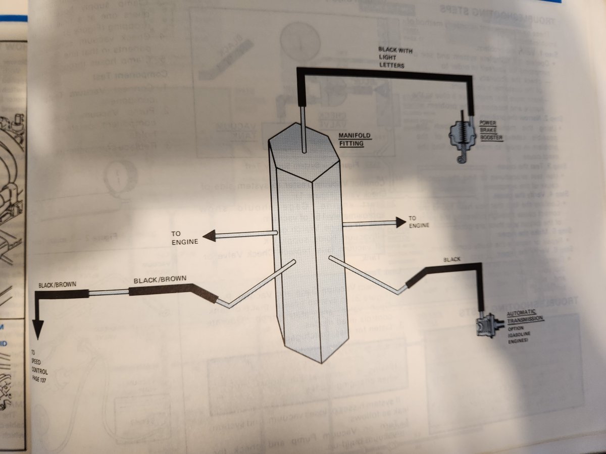

So I never got to checking the wiring, but the other day I installed new fuel injectors and afterwards the pump in the tank started working again and the truck fired right up. I really don't know why it started working again randomly but I've yet to check the frame mounted pump to see if it works. I've also now found a different issue, some vacuum lines seem to be disconnected from where they should be and I have no clue where they go.

If your talking about the diagram next to the hood latch then it is still there, however I don’t really know how to read those diagrams and I don’t know if it would help much with a few of them. Specifically one that has a T joint has it go in a total of 3 directions.
I am. The lines on the diagram are only useful for where they end. One line is one hose with no breaks.
Can you post a picture of the sticker and the lines in question?
So...
From my 86 EVTM... not alot there... I'd say they missed at least some of the "mark".
Should be a speed density fuel system so... you'll have a MAP sensor. The other engine port is EGR/EVAP duty.
There is also HVAC somewhere...
If your label is readable... post it.
