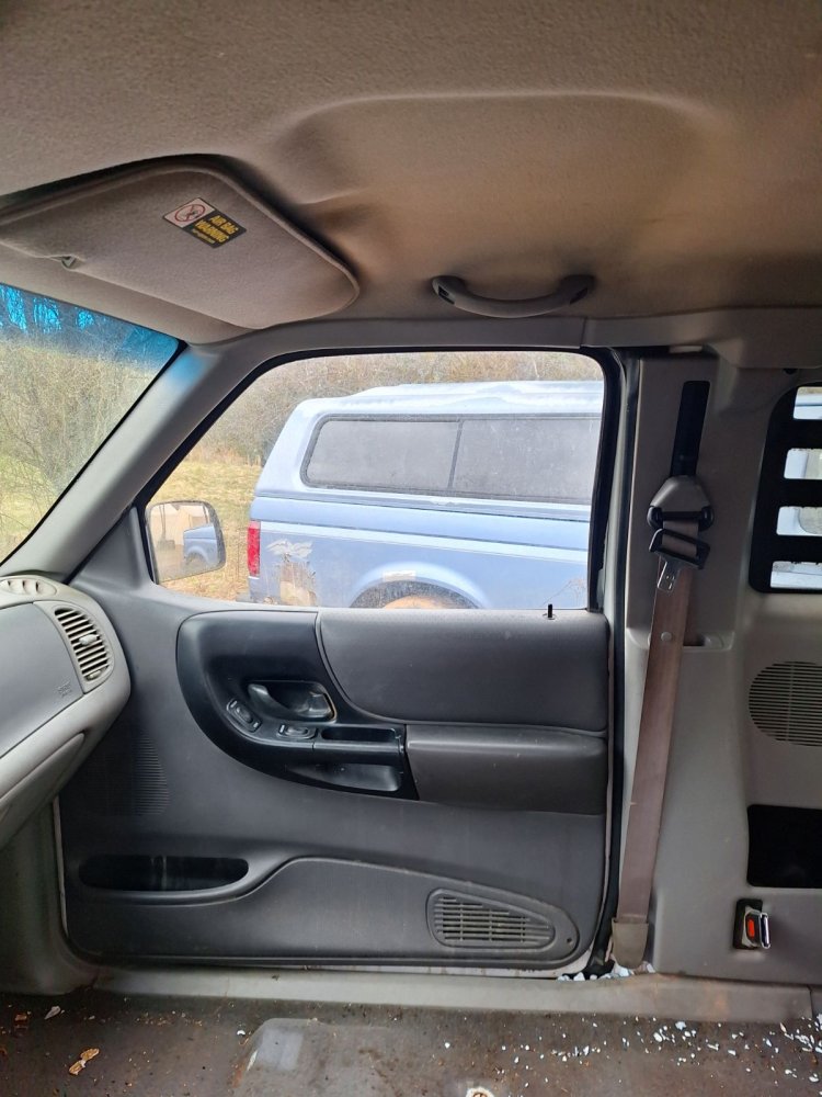

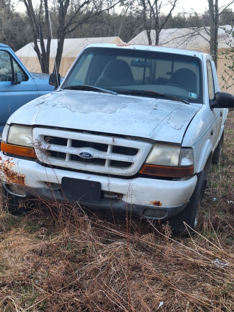

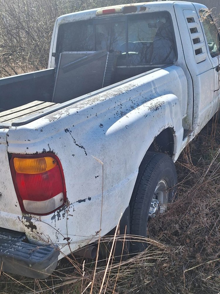

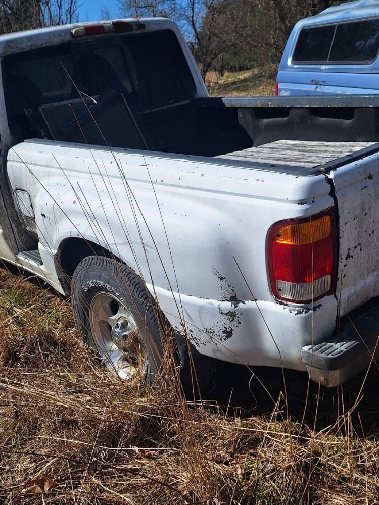

Well picked up the ranger today! 99 supercab, 3.0 auto. With any luck maybe I can get the very beginning of the project going as soon as next week. Now that I ended going Ranger maybe this thread needs to be moved too 🤔
here’s a pic or two. Not pretty, but good for a racer, and the frame is good and solid with just a bit of surface rust!
