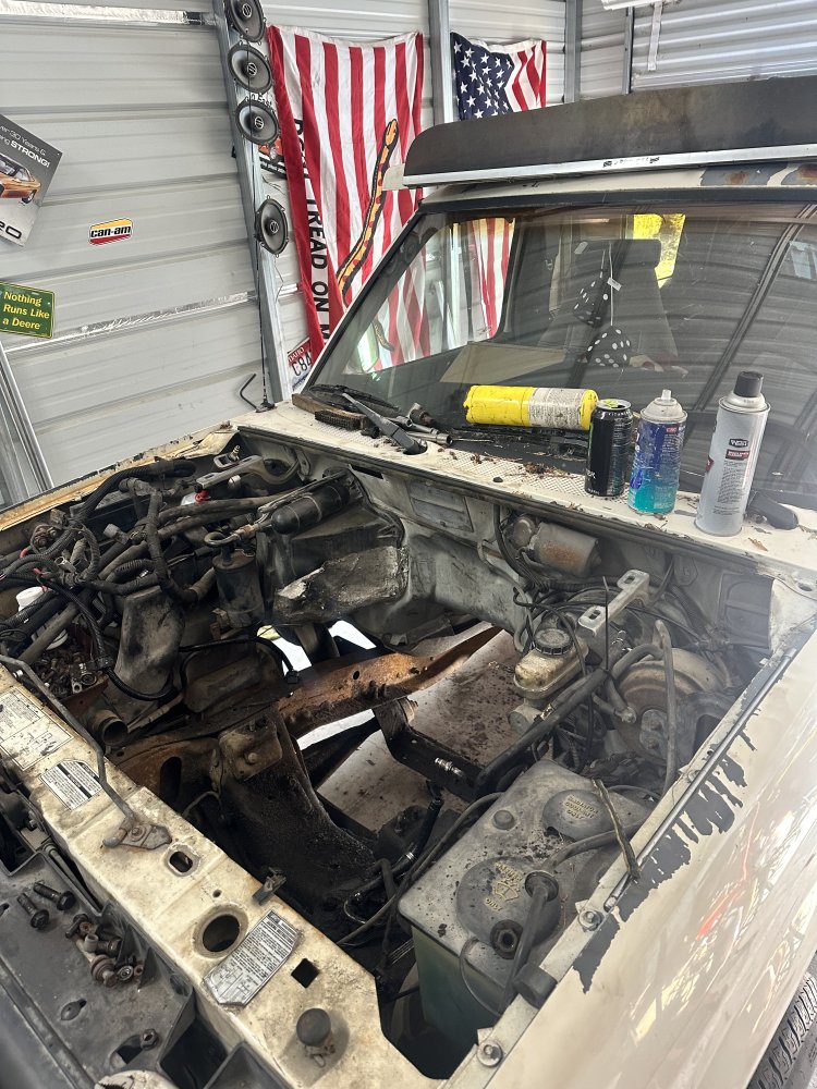

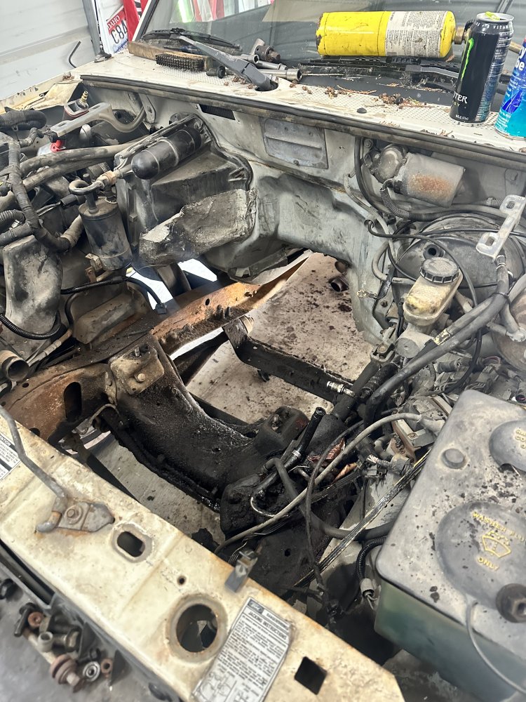

Finally had the time to get a little more work done on this old girl.
Pulled the drivetrain today and found a fairly recent (2016) rebuilt transmission under it. Now to start cleaning, painting and making it look a little better under there!

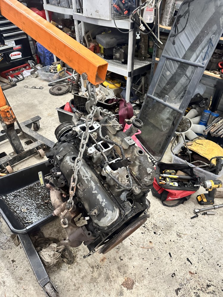

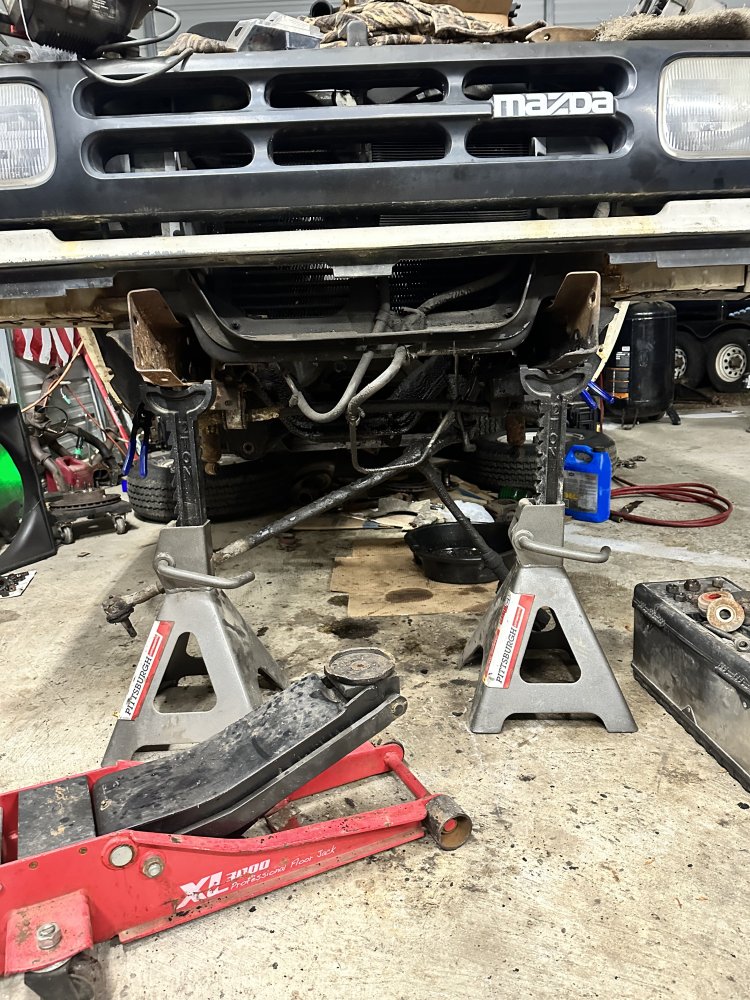

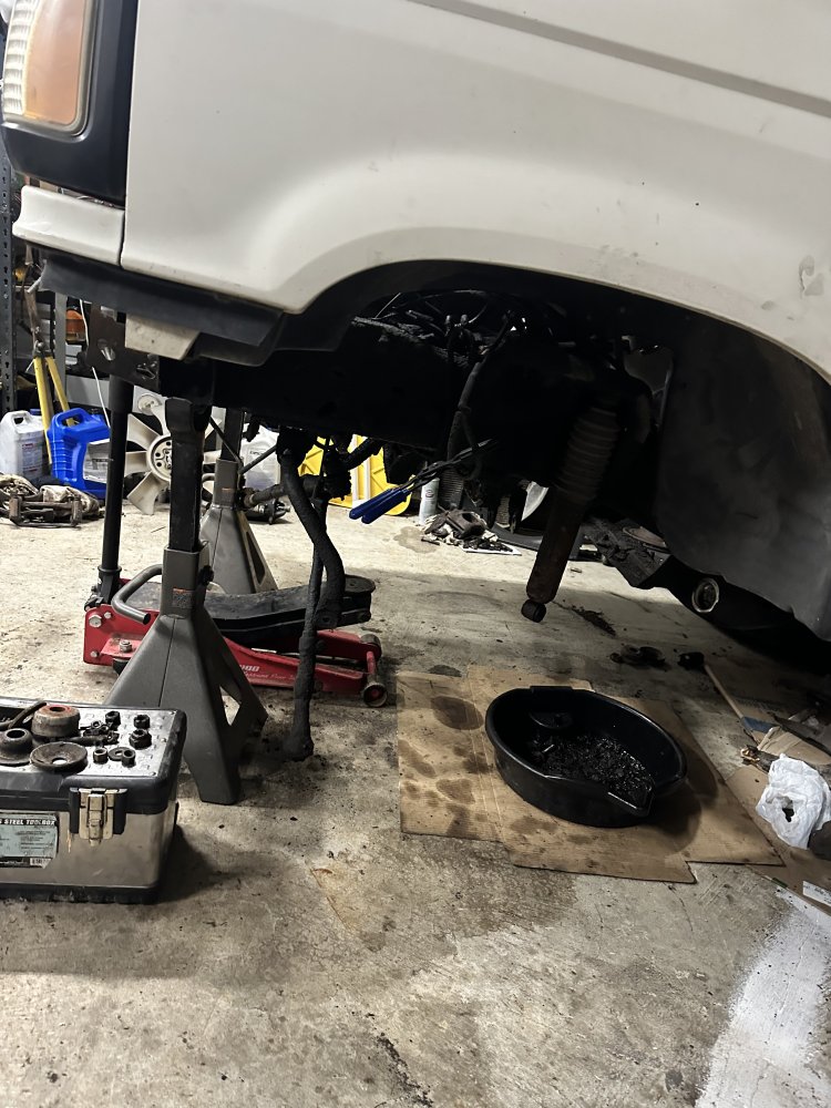

Was able to find a little time to work on her some more. Got the engine on a stand, and got the whole Dana 28 ripped out. All of it came apart super easy! Gotta get the trailer cleared then I can tear the Mazda Navajo apart … little bit at a time

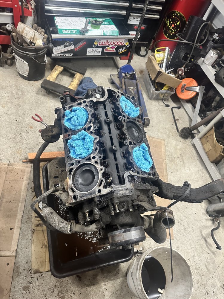

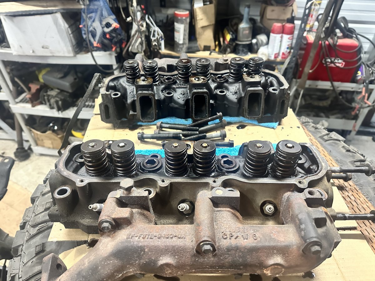

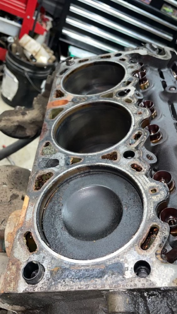

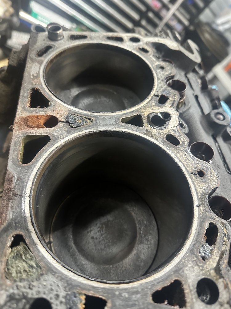

Got the engine torn down most of the way. If I’m being honest here fellas I was a little nervous about pulling the heads because of what happened las time. Well in this case luck was on my side, and there are NO cracks and everything looks great! Crosshatching looks great and no scoring on the walls NOTHING!
I was able to teach my 15 year old how to do everything and what it all was. Kinda nice when they listen huh!?
Now for the cleaning and re sealing of everything after we get the crank pulley off and timing cover etc… Fingers crossed, everything is going good so far!
