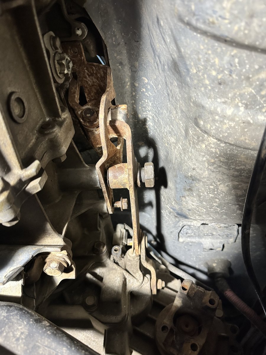

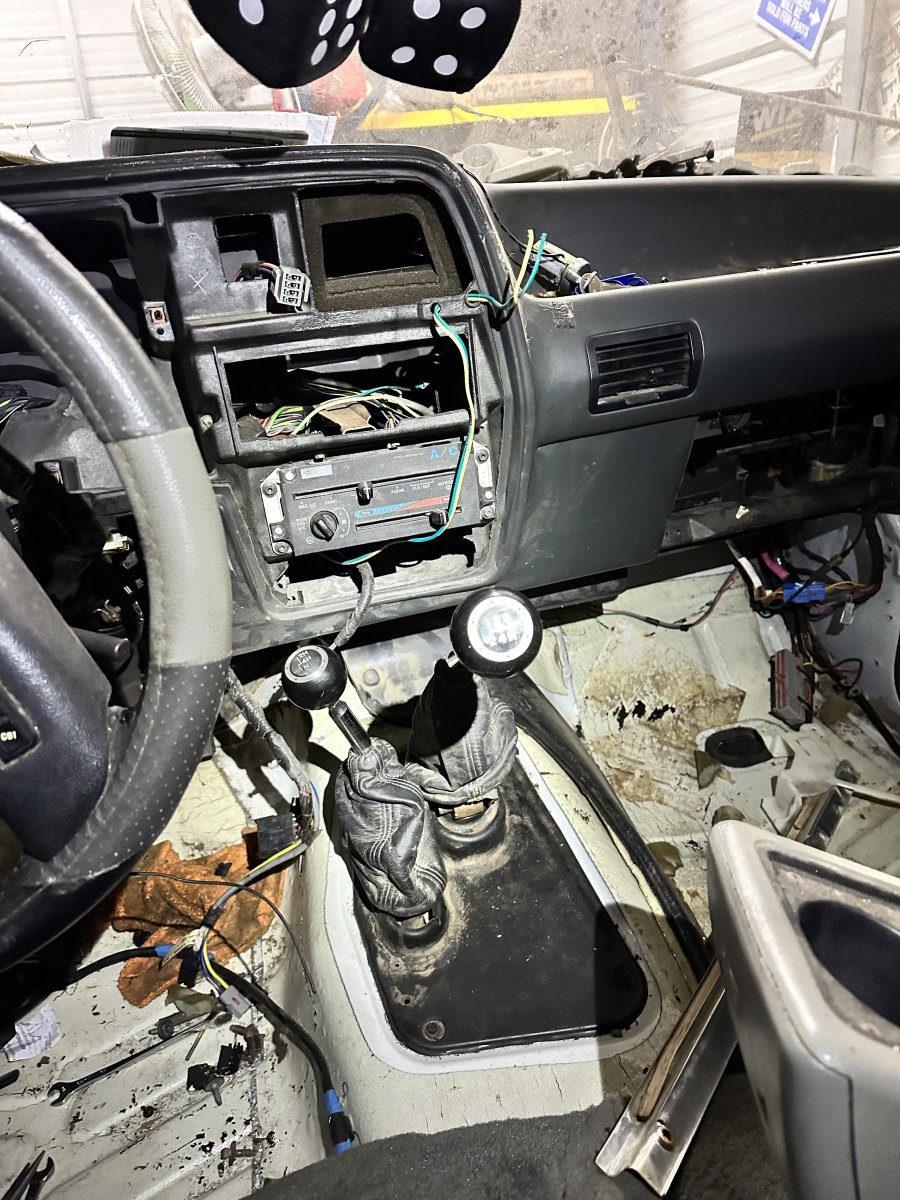

For starters I mocked up the shifters today since I’m impatient and wanted to see lol Also got the intake placed, throttle cable installed, Y pipe bolted to the manifolds, and the gas pedal mounted back up. Lots of little stuff, but it’s progress 👍🏻
I do however have a few questions about the fuel lines …. Would it be easier to just swap all lines and pump from an explorer (if possible) or just fab up a fitting ?
My biggest issue though is the wiring side of things since I don’t see colors too good. With the dash and radiator support wiring all swapped in, it should (for the most part) be a plug and play deal right?
