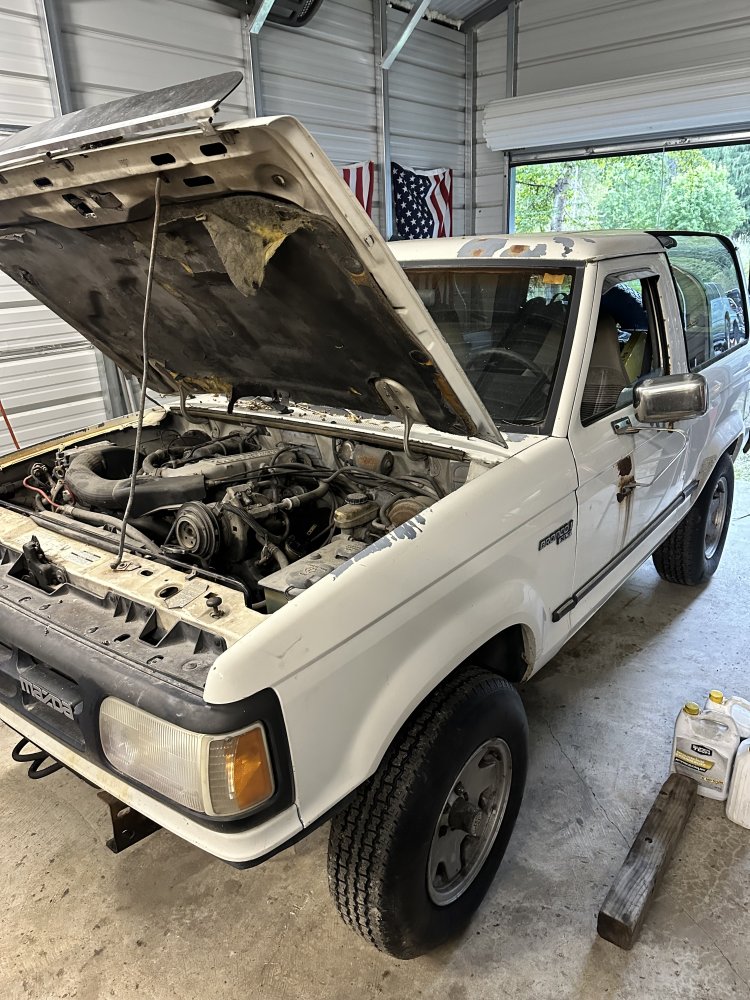

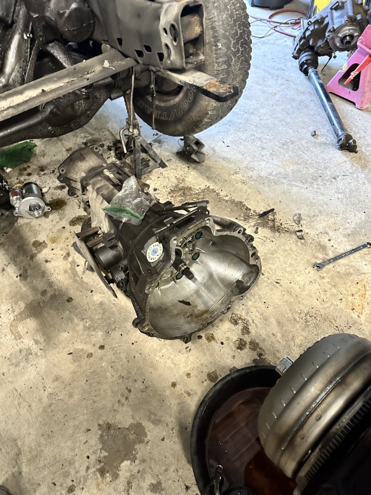

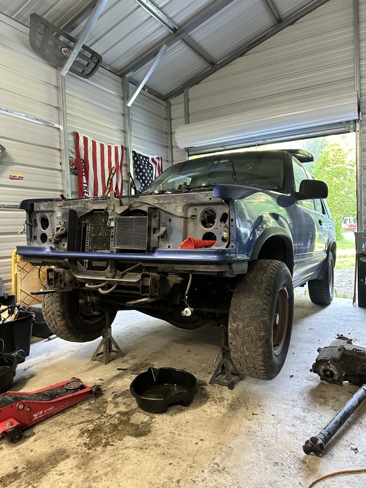

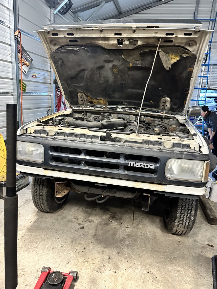

Got the front clip cut off the Mazda today, drive shafts disconnected, transmission drained, transfer case drained and dropped. Tomorrow I am pulling it out of there!

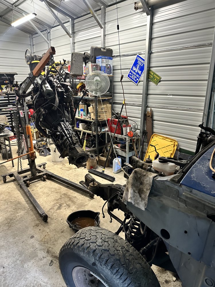

Had to leave the Y pipe on while I took the drivetrain out because the bolts were so badly rusted. It wasn’t easy, but I got it out of there today! Transmission has been replaced at some point….. (go figure A4LD) Got the torch out and got the Y pipe off too!

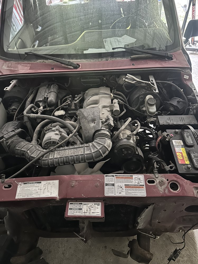

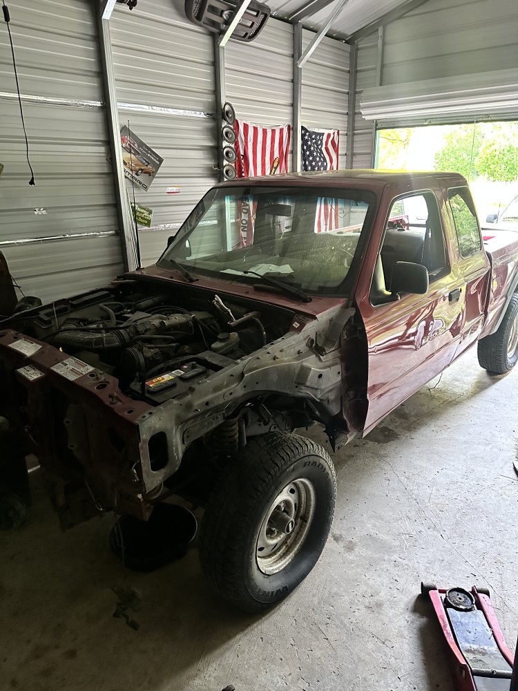

Slight change in plans. Still doing everything on the bronco that was planned, just going with a different 4.0. My buddy bought a truck from me a few years back (almost perfect 93 ranger 4.0 ex cab) for his grandson… well grandson was 15 at the time and he totaled it. I helped him out with a few things and he gave me the truck. So the engine from the 93 ranger is going in the bronco (still sealing it) and the 2000 explorer 4.0 is gonna be going in my 96 ranger that I have sitting on the back burner.

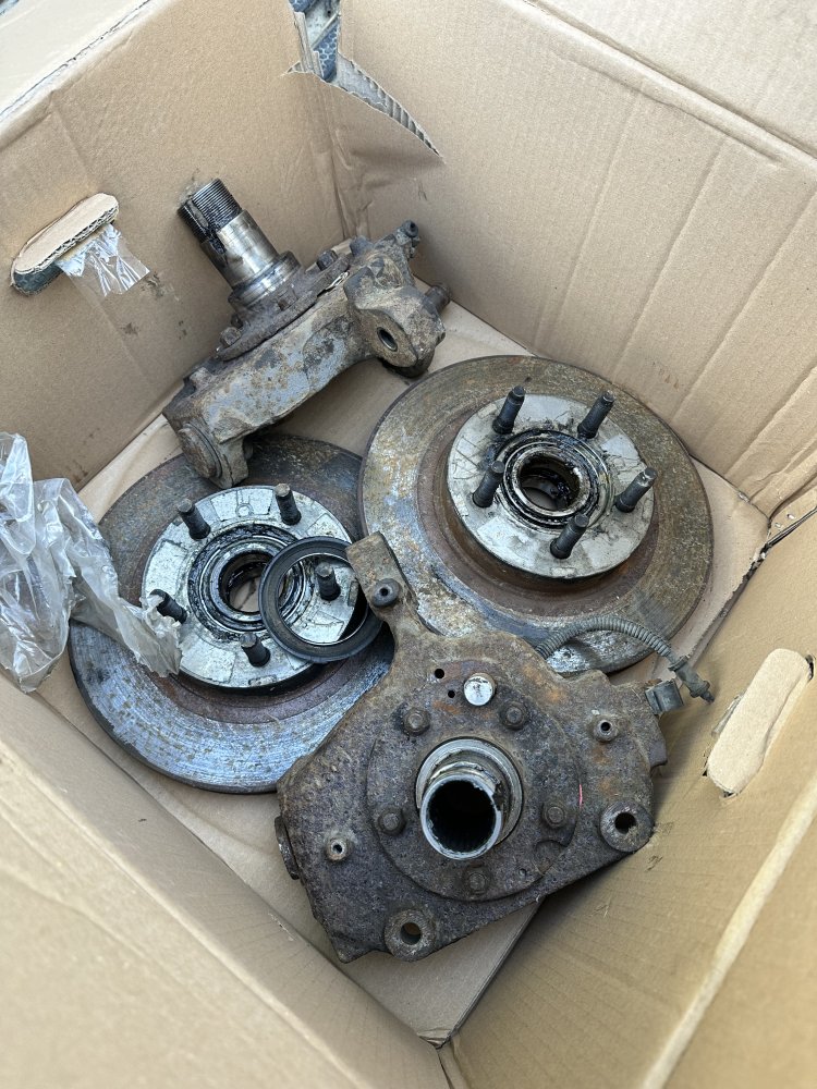

On a positive note… I got the brake parts I needed today, knuckles, rotors, and spindles!

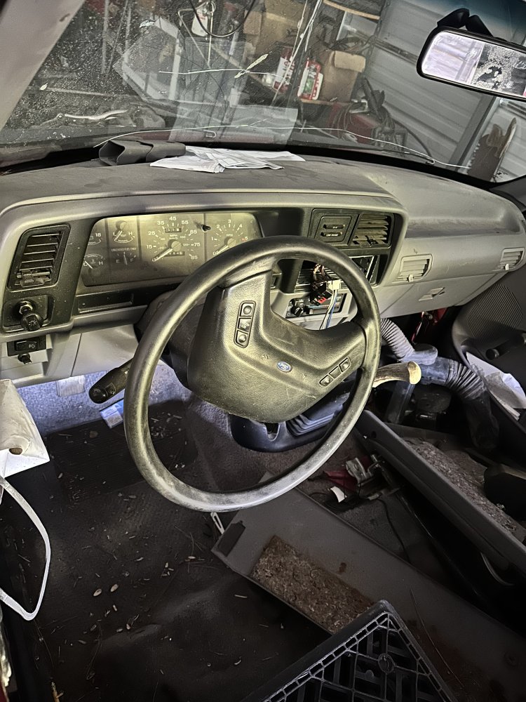

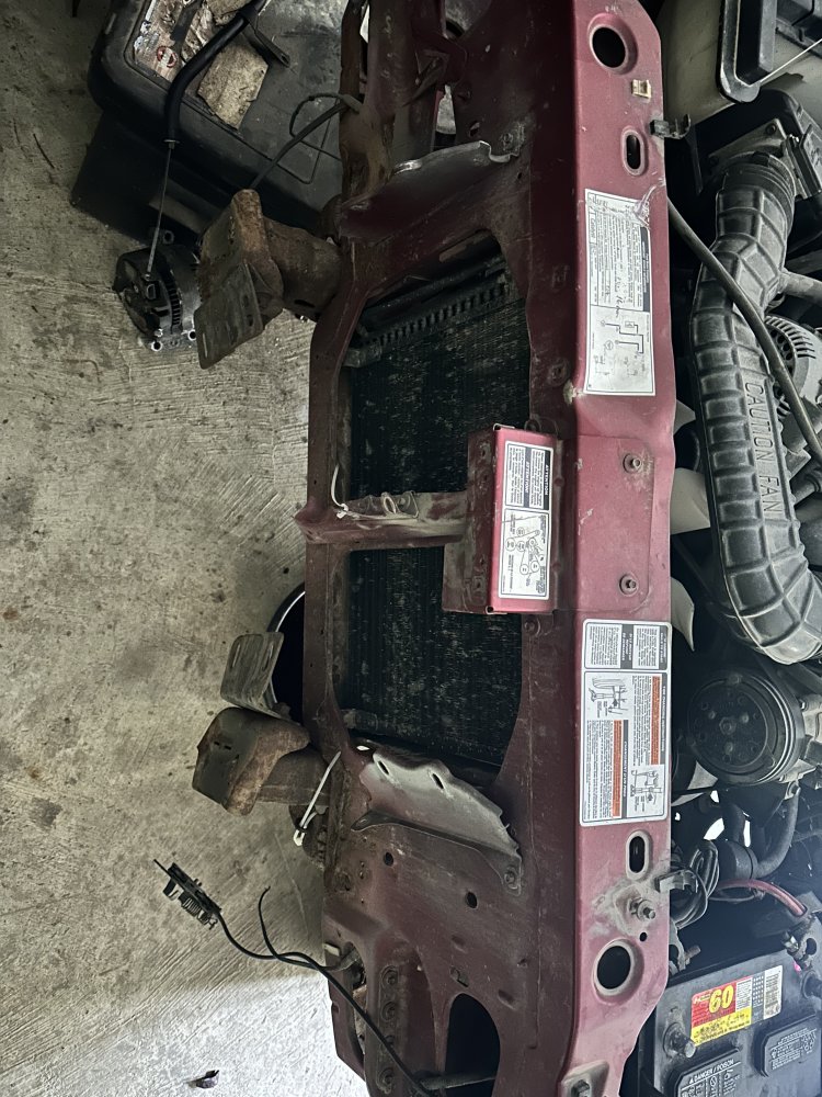

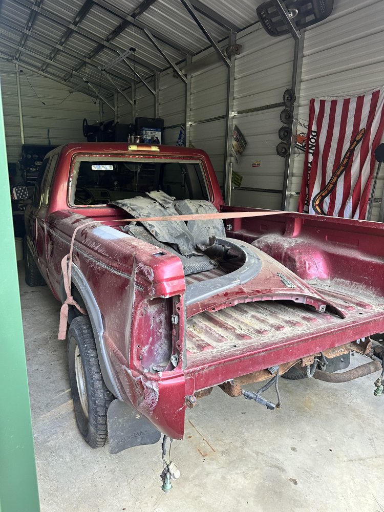

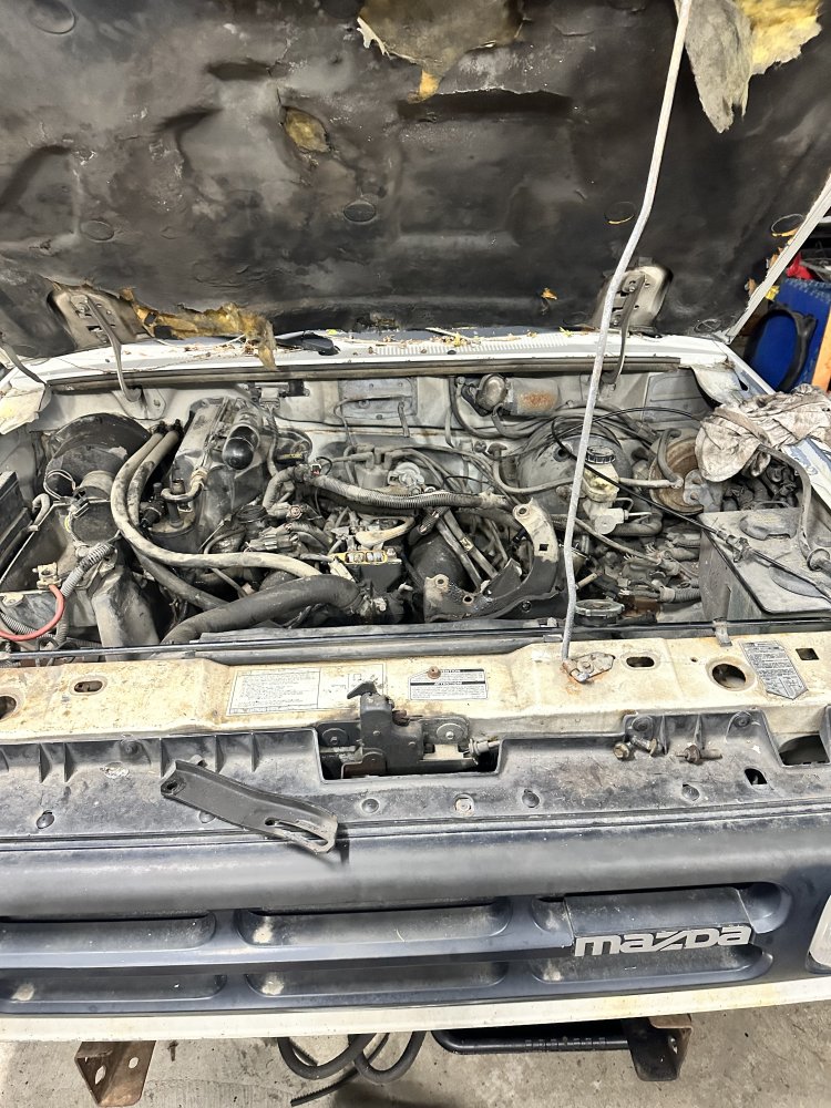

And finally after all the catching up I can finally work on this little bronco !

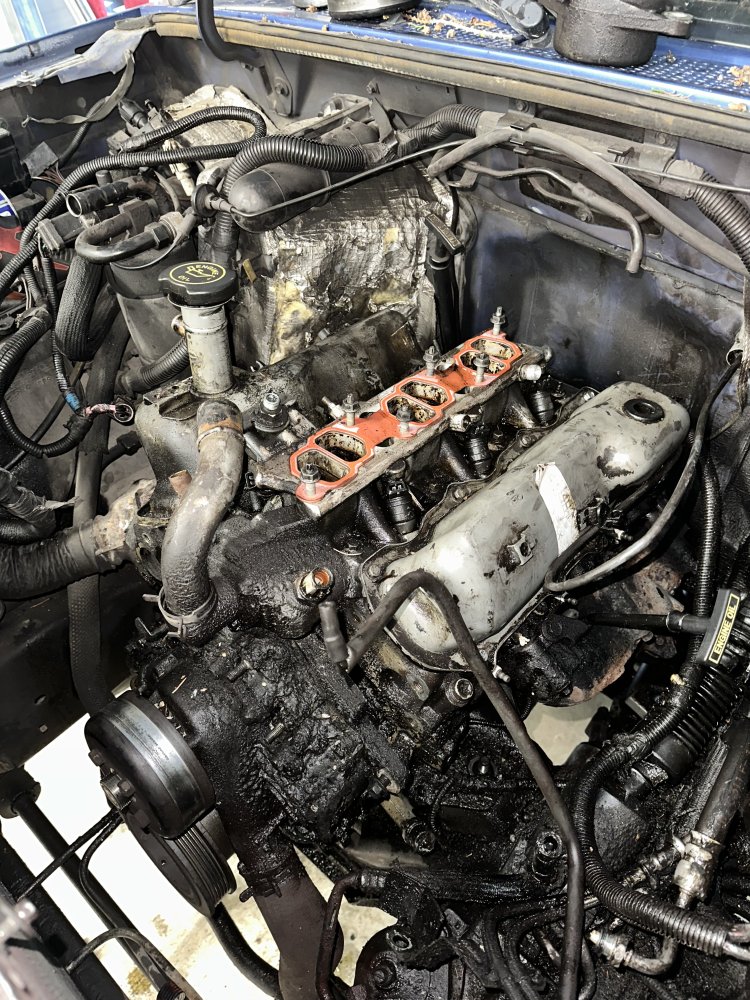

We did a few small things to it such as getting the intake off, alternator removed, A/C compressor removed, fan and shroud off, and a few other odds and ends things. We will be working on this one Now since my son is in drivers education. Gonna be pulling the drivetrain first then it’s going on jack stands for the removal of the front and rear ends!
