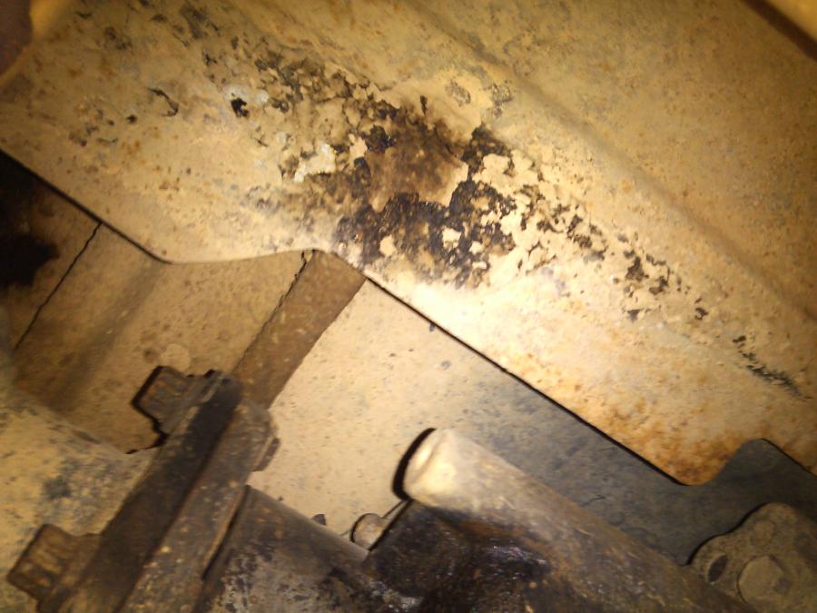

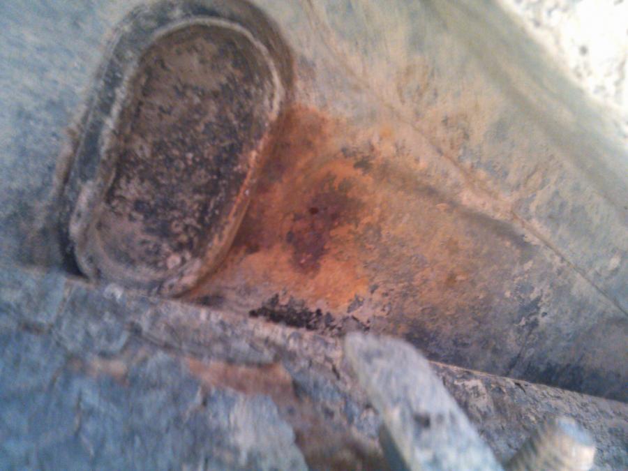

ok now that im on break i have time to work on the under body were i found a good amount of rust, on the body, the frame, the floor i need it gone basically so anybody got any good ways to get rid of it
The only way to "get rid of" body rust is to cut it out and replace it, preferably with steel. Some folks have used fibreglas but that is a stopgap measure.
These are what i could get finally now the weathers good its been raining for about a week so heres the few i took today

Buy some Master Series silver. Take a wire wheel and clean the areas you show in the pics. Use some harder if need be, but clean it up well, nothing loose left. Then put on two good coats of MS. After that, coat it with whatever you want, bed liner, undercoating, black paint etc. You will be fine.
