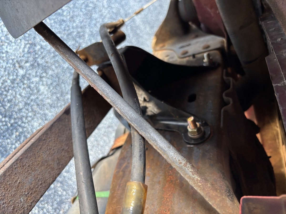

Broken front leaf spring mount

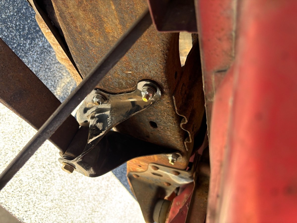

Got my truck back from the welder today. They replaced both front leaf spring mounts, the bushings and U-bolts for a little less than $600 total. I know some of you could have done this job yourself but like I said - I don’t have the tools or skills to tackle something like this so it seemed like a very reasonable price to me.
They also did an inspection of the entire frame and told me it was “solid”. While I was paying a guy who works there actually offered to buy it. Said it was in a lot better shape than his Ranger.

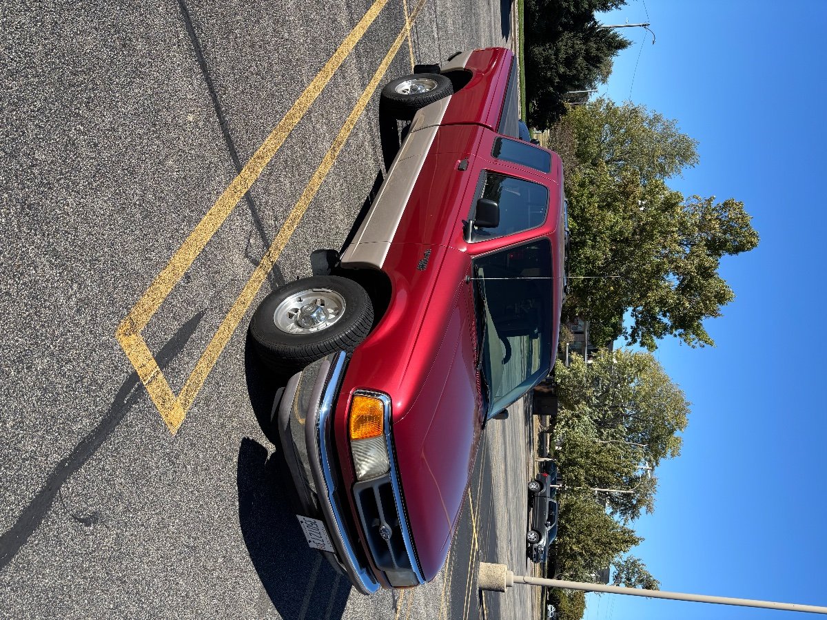

Here are pics of the new hangars plus one of the whole truck.

The mismatched hardware is slightly odd IMO, but it's fine. Tight and not rusty is literally all that matters. Maybe one mount came with hardware and the other didn't?
Looks good.
Considering the trouble I had with mine, I'd have probably paid that to get it done too. LOL

I didn't think it would be as bad as initial estimates. Glad you got someone to fix it, that one was definitely worth saving.

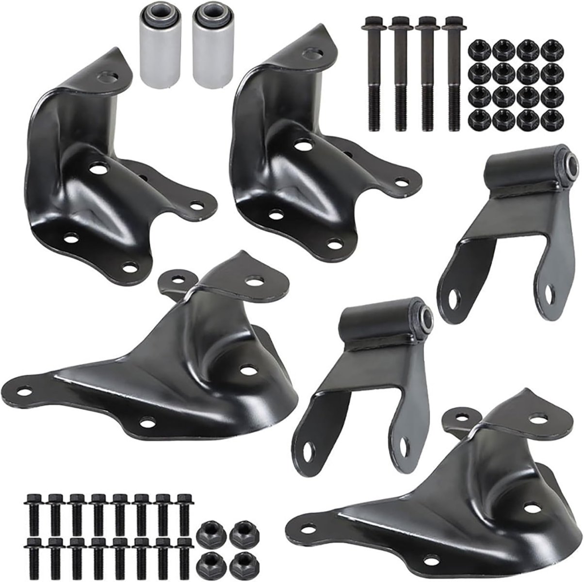

You can literally buy the spring hangers and shackles off of Amazon as a complete kit for $78:
Or just get the mount you need. That link is for an extended cab, but I'm sure they have the front mounts for a standard cab as well.
I'd grind off the rivets for the old one, remove the hanger, wire wheel the frame to get rid of the surface rust, paint it with Rustoleum, and bolt the new hanger on with Grade 8 nuts and bolts.

For the price of the kit and doing it myself, that's probably what I would have done. Replace all of it and be good for another 20-30 years. Considering that OP was paying for the work, partsd plus labor might have been better for him with just the front two.

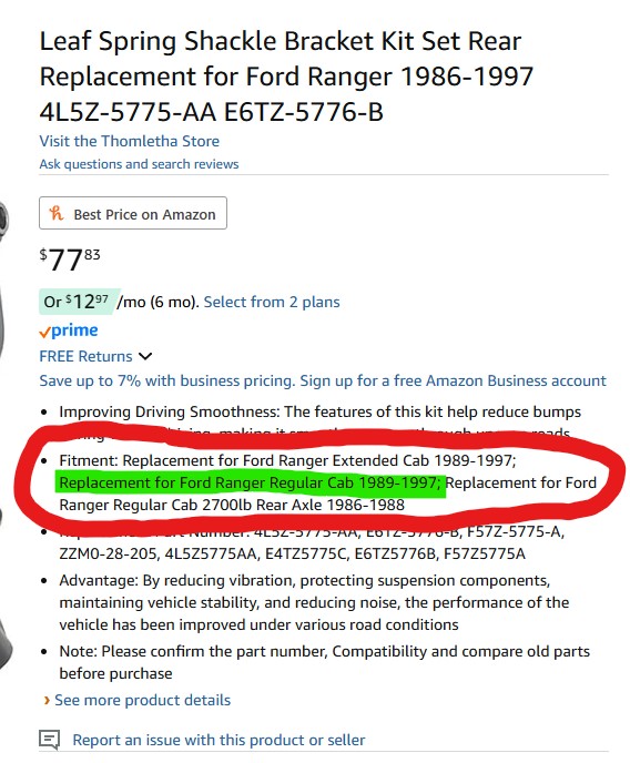

From the listing linked:

Even if it didn't say that, those parts are going to be the same for all wheel bases and 2/4 WD on a Ranger. Well, at least for the 89-97 ones. Pretty sure that they would fit all 83-88s and the 98-11s as well, but never compared them.
