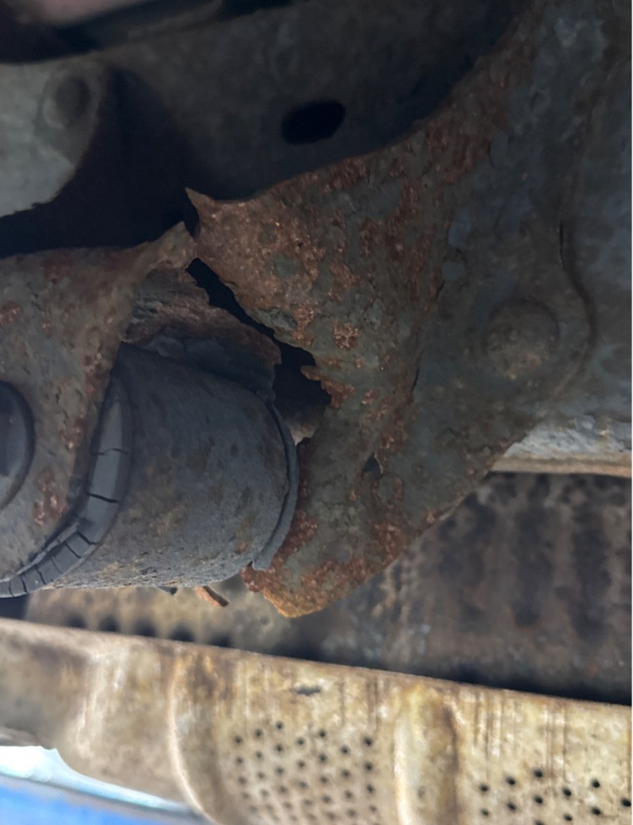

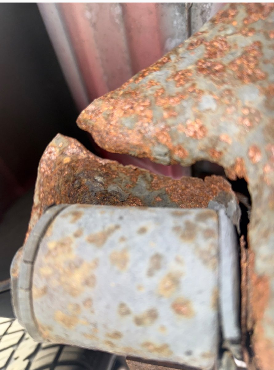

My 1997 Ranger only has 56k miles but one of the front leaf spring mounts on the rear axle has broken and my mechanic is telling me even if they could find the part (which they haven't been able to so far - rear leaf spring mounts are abundant but front mounts are not) the frame is too rusty to attach it. I might take it to a welder to get another opinion but otherwise it sounds like I may have to scrap it which seems like a shame with so few miles. Open to any other suggestions or ideas.

seeing that I would be very concerned about the frame.
by the way, the front & rear frame sections join together at that mount and rust really likes to hide between the 2 plates.
I on the other hand would not be too concerned about the frame from what I can see of it. I would however take a very good look at the other three spring hangers, better to do all of them at once if necessary. Just from the initial statement by the mechanic that he can't find the parts, I'd be looking for another opinion from a unrelated source.
The mount is rusted and cracked, but that frame appears to be mostly surface rust which almost all frames will have. It's fairly common for the mounts to rust out and/or break without negatively affecting the frame. I've seen (in pictures online) the mounts rusted away to the point that the spring is resting on the bottom of the bed, but the frame is just fine to install a new bracket. Mounts are readily available as noted above.
I wouldn't hesitate to replace that mount myself, but I've got access to the tools and place to do it. Depending on the price quoted for the work, it may be cheaper for you to buy the tools too, plus you'll have the for future projects.
Jack and jack stands to raise and support the truck. Tool set to remove the leaf spring and reinstall the new bracket with bolts. Angle grinder, hammer and chisel/punch for removing the rivets. Wire wheel and paint the frame if desired. Grade 8 bolts, washers, lock washers, and nuts to reinstall the new bracket.

From what i can see of the frame it looks fine.
Id find a new mechanic. I had the drivers side shackles replaced on my 97 F250 that were in way worse shape (not broke though) and the frame looks alot worse and its still solid.
I just realized that's the passenger side, that's doable in a driveway with a jack, jack stand, hand drill with good drill bits and a cold chisel and hammer once you get close enough with the rivets drilling them out... Assuming the front mounts come with fasteners like the Dorman shackle mount I bought a couple years ago you're set there...
