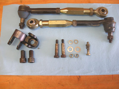

I had MOOG tierod ends that had replaceable rubber bots and zerk fittings as well.
Theese put an end to bent/ broken tie rods.
Those are some stout tie rods. :eek:
