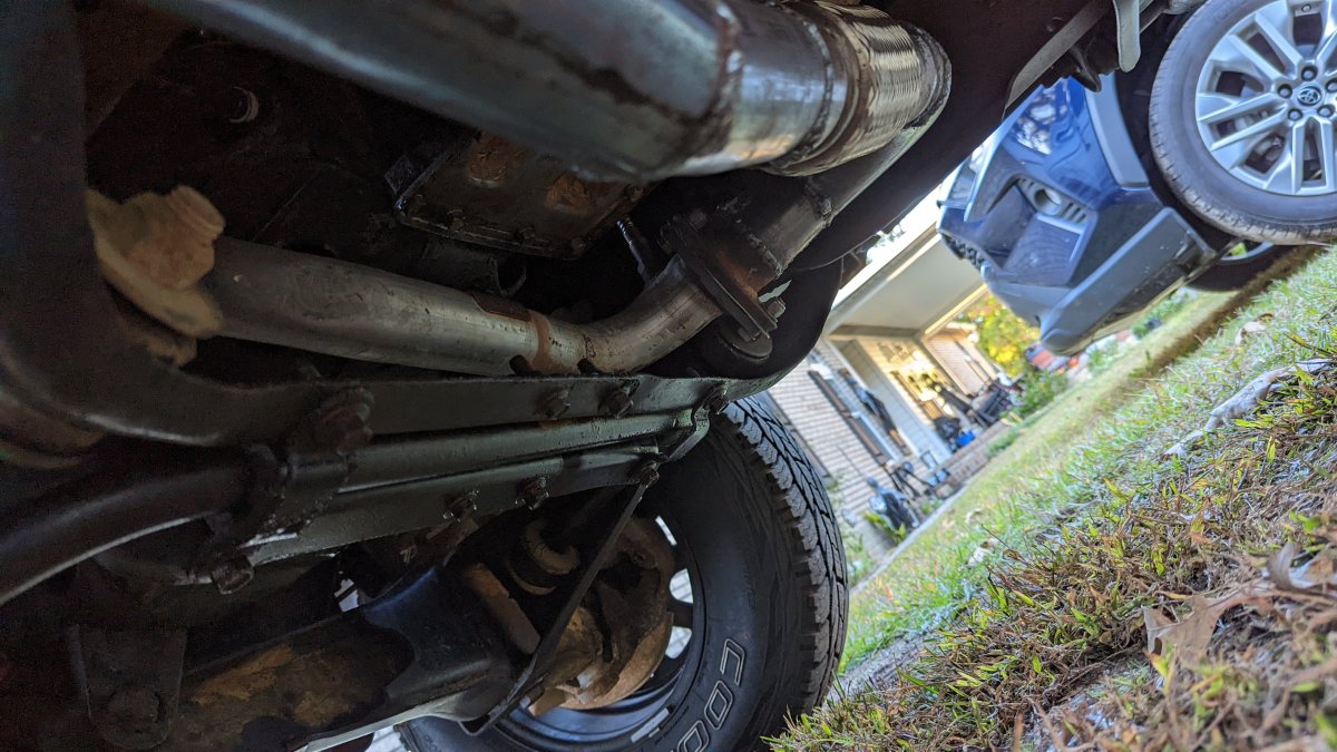

I will say that you will have to prepare for adapting the exhaust though. What I mean is the standard headers and Y pipe comes down to an oval flange that mates to the factory cat. Nobody produces an adapter to round pipe for these that I know of, but some of the guys on here have talked about making their own. I should have done that or found someone to make me one. I asked my usual exhaust shop and they said no problem, but what they ended up doing was belling the end of a pipe and beating it to an oval and just weld the crap out of it. I wasn’t really pleased with that. But it’s about your only choice for anything not standard around here. If I had my own shop together, I’d probably get a bender and do it myself.
It's easy, I did it to my turbo setup. Took all of 30min to get a basic adapter that didn't leak.

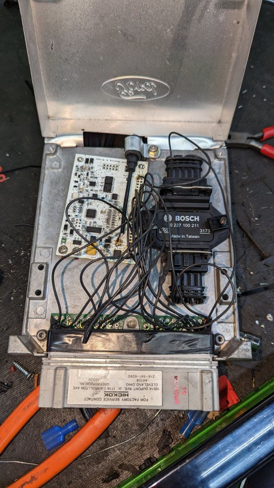

My truck's on a microsquirt, although I did it a bit differently.
Brand new to the B2....is the Sven Pruett build real?
Sir…did you use the oem case to put in a standalone ecm? I am nothing short of thoroughly impressed.
Yes, I did. And then decided to rewire the engine, pretty much nullifying my reasons to use the factory case & connector.
