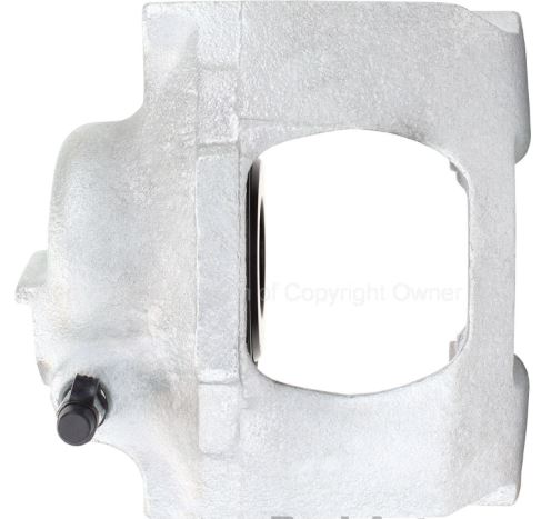

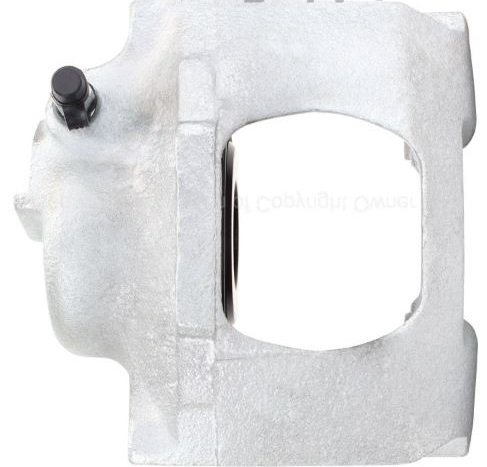

Are you sure you have the calipers on the correct sides of the truck, it wouldn't be the first time I've seen them put on backwards.
Bleeder on top = correct
Bleeder on bottom = wrong
I think you're onto something here as my bleeders are definitely on the bottom...will be working on it early week and will keep all informed.
Thank you for the help.
Eureka! After swapping the calipers/bleeders to the top I have braking pressure! Front dual and rear single caliper swap complete!
