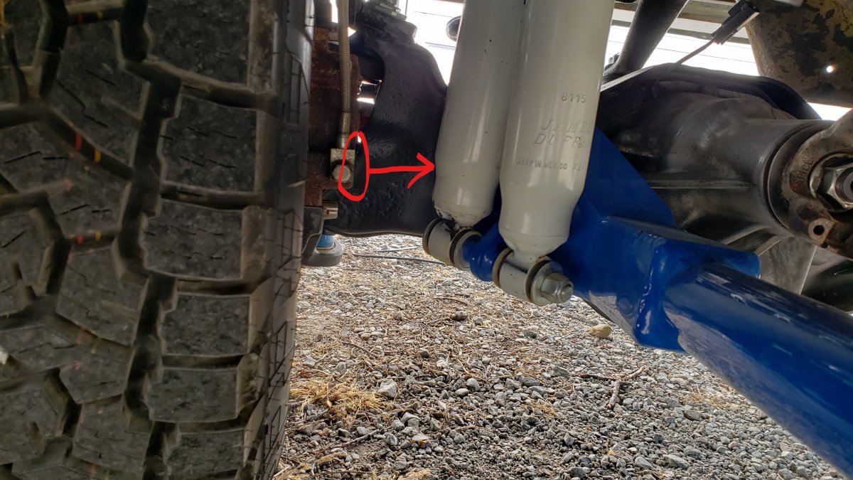

Since everyone likes pics and I like showing this thing off...
Since you like showing it off... cool truck BTW... post a couple more pictures of the offending area's. Like pics of the banjo bolt... caliper... shock mounting.

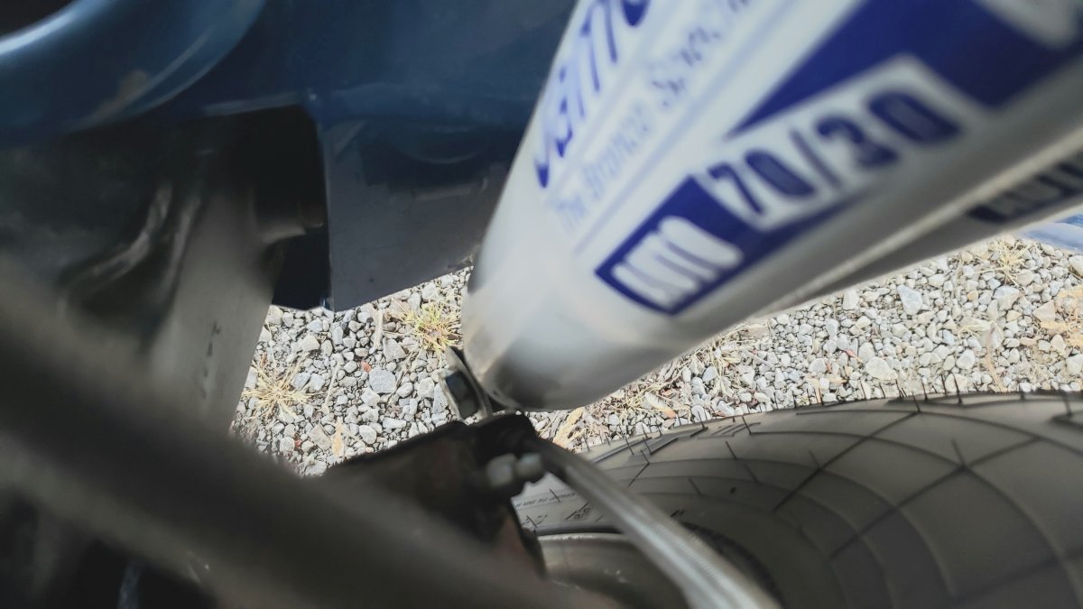

I need someone to hold the wheel at the full lock position but this give you an idea of what is making contact.
Actually i think its the "rear" shock not the "front" that the fitting makes contact with.

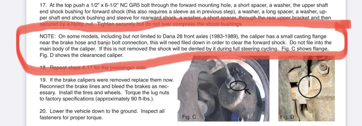

Did you have those duff arms on a D28? Did it not hit?
When all else fails, read the instructions.
Lmao...
Great find. Who woulda thunk to look at any instructions.
