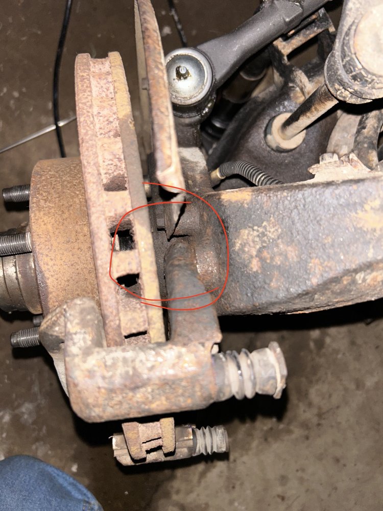

Heres some photos so you get the idea. its the upper bolt.

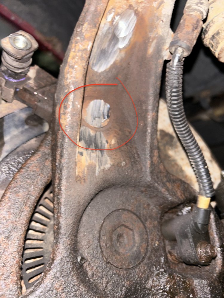

Here you can see we ground it down. The idea is to cut off the head and just pull the whole rotor off the other side. But the bolt head is sort of buried in.
Heres a top view of where the bolt is connecting the caliper to the rest of the vehicle

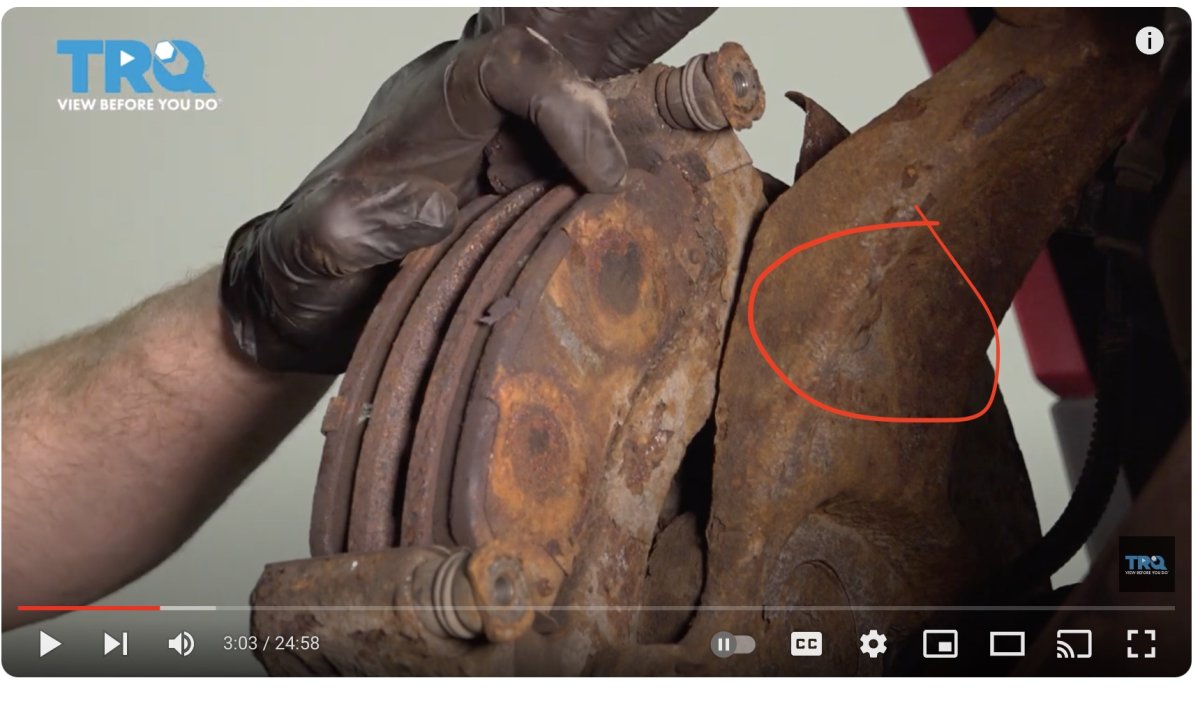

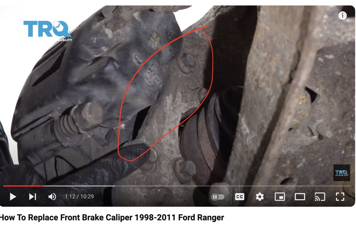

Here is a youtube video of what it should look like

Maybe drilling it out? You might need to remove the knuckle to get proper access to it. If you can get enough of the center out, it might release enough tension to knock it the rest of the way out. The threads will be in the caliper bracket. So, you don't have to worry about that. Try to leave enough bolt so you have something to grab onto once the bolt is out of the knuckle. It is NOT going to be a fun day. Though I imagine that today wasn't a great one either.
If above doesn't work maybe you could use an air chisel to pop the nut off?
I'm with @sgtsandman, if I were faced with that the knuckle would be coming off for better access. With it off the truck I could probably get something in there to finish removing the bolt head, and remove thebracket with the rotor. Unless the remainder came out off the bracket easier, I'd probably replace the bracket.
No nut, the bolt threads into the caliper bracket. He'd be trying to take the head off.

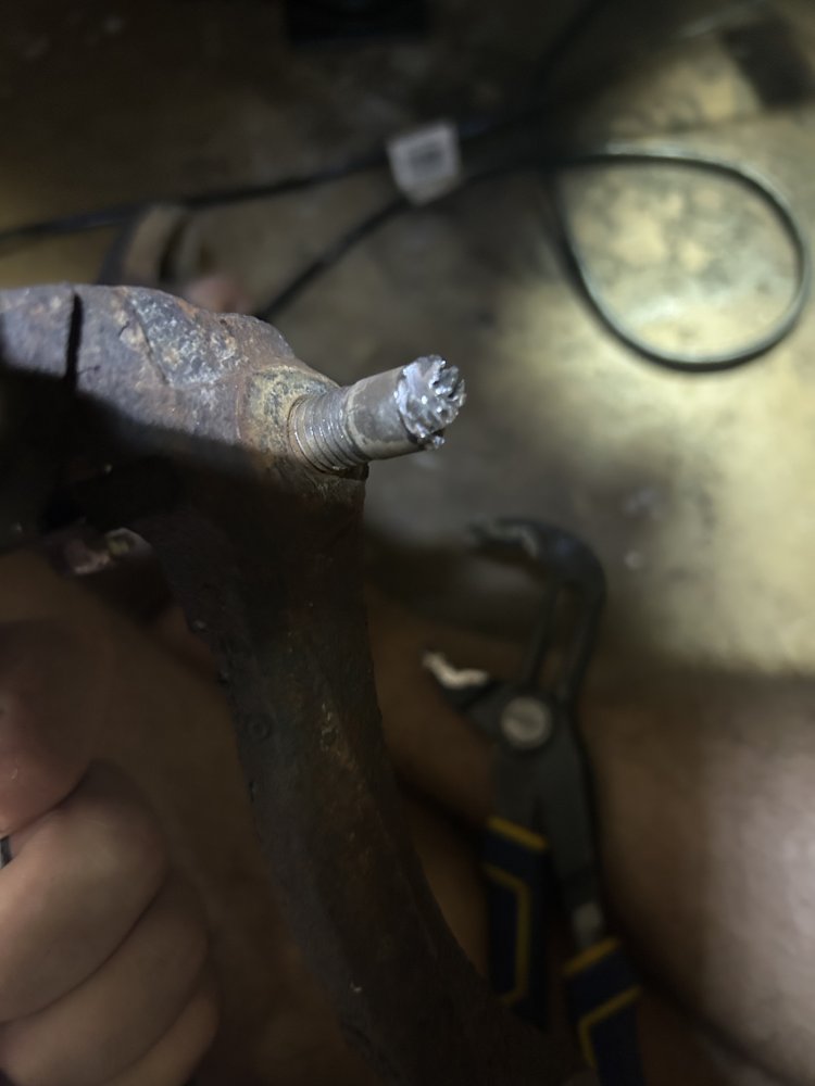

Thank you all for your advice! After entirely too long I got the bolt cut off, heres the aftermath:
