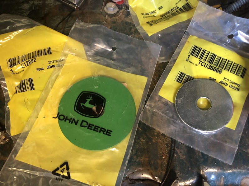

I kinda copied the construction method used for some of the aftermarket options for two of mine (I only needed two and didn't want to buy a whole set) Two big washers (from John Deere dealer. You can check around, duff used to make a kit for older trucks.
Do u have a list of what you got by chance
Those two washers, i measured my old mount for the tube length.
