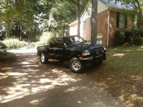

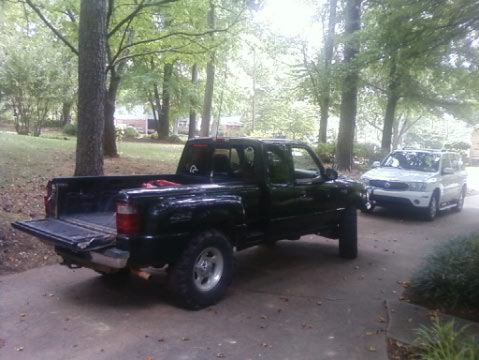

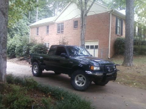

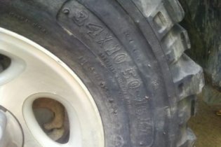

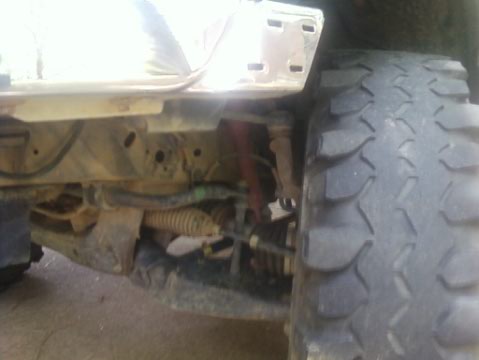

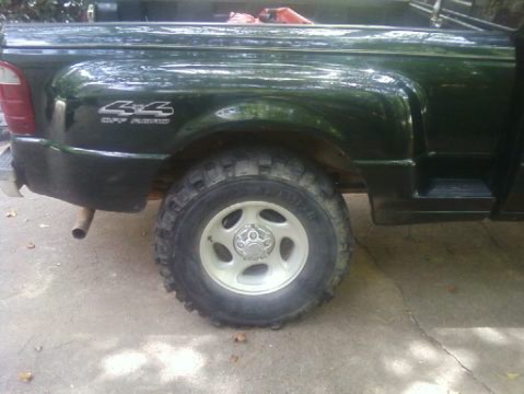

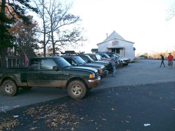

im running a set of 34 10.50 16 tsls right now but im dropping to 33 12.50 15s to run a set of black Cragers i got for free. check back on this thread tomorrow afternoon ill take some pictures of it sitting still and flexed out. the answer is yeah but wait til wou see some pictures of mine the 34s are a bit close to the fenders for my liking but if you have a body lift already on no worries. im running the 34s on a stock truck all i did was crank the bars. ill post pictures of my 01 in the morning when its light out and ill try to get some of my brother todds 98 hes got 33 12.50s on a stock truck it only rubs when he hits the mud hard

pictures of mwood1985s ranger
2001 major torsion bar crank stock keys and springs clearing 34 inch TSL Bias ply tires although they are more like 33.5s after using them on the road too much never had a problem with rubbing except when i jumped it into a mud hole to have enough momentum to get out the other side. fot a mostly stock truck shes suprised the hell out of me with the "power" of the 4.0 and pulled some things she shouldnt have out but did it anyways quite\ a few times both on road and off.
