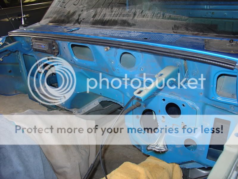

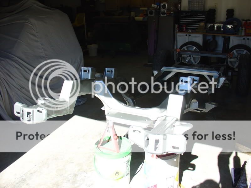

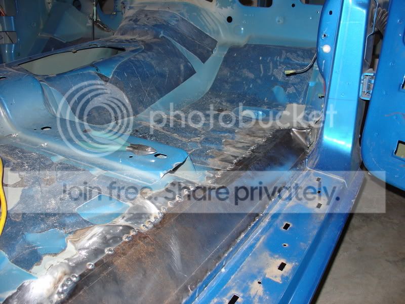

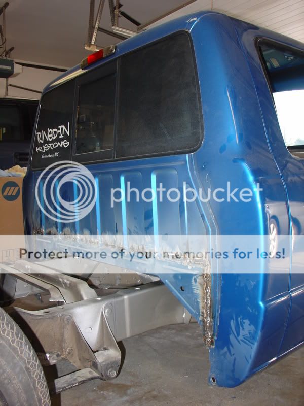

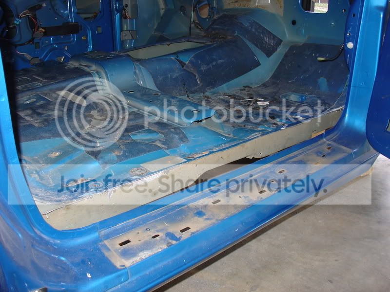

Heres some pictures of a bodydrop in progress..
lets not forget that we have to lower the front framehorns for the core support..
yyyyyyyeeeeeeeeeaaaaaaaahhhhhhhhhh i think im gonna wait on this one until I have some more time. THanks for the pics though really hleped alot
