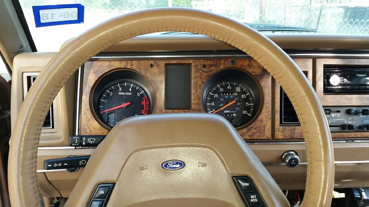

I was looking at that this morning and thought maybe drilling a small hole above the Speedometer and mounting it there. Out of the way and concealed. Also would be talking more in that direction... ( A thought)
I would first tape it where you think it will work, use it for a week or so to make sure people can hear you, so not too noisy or otherwise poor quality at their end of the call
The dash area is a cavity so will have some "harmonics" at different times(steady drone), depending on speed and road conditions, you could also get the "barrel effect" from the refection of sound(your voice) off the instrument cluster.
Visor is an open area, and windshield slants away from you so no reflected sound, which is why visor is popular choice
Point taken... I just mounted it in on top of the speedometer. Looks great! If it doesn't work I will move it and find a NOS replacement instrument panel to replace mine...
