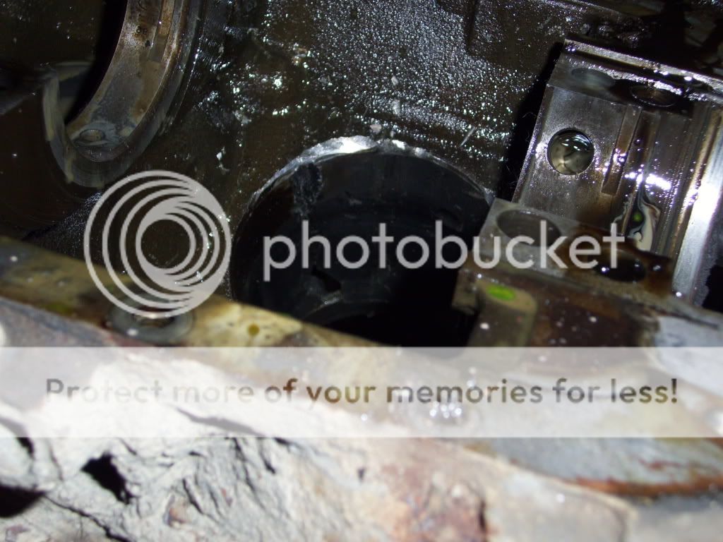

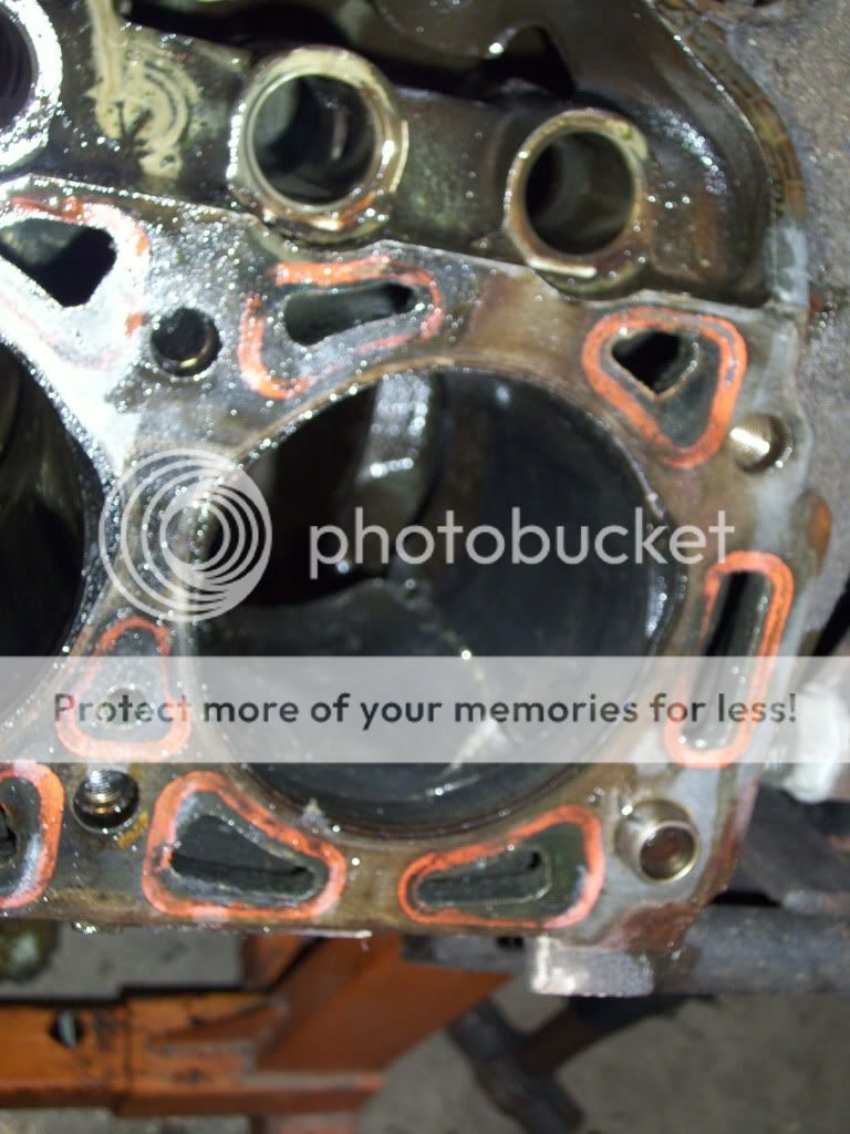

The pics don't do it justice, I was actually quite impressed when I saw it. and from how it was explained to me it seems that the motor was ran for a couple of minutes with a badly bent or broken rod. He makes up for being the only un-lifted truck in the bunch with copious amounts of throttle application. I'm quite impressed that this motor lasted as long as it did and I think he is too.
