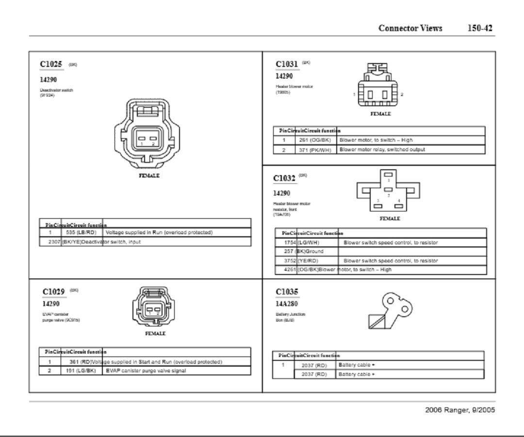

was changing my blower motor resistor, when i noticed the plug head has been cut off by the previous owner, and it was not even plugged in, I can't find a wiring diagram with the same color wires, and tried calling ford but no luck, anybody able too take a look at theirs for me and let me know where each color wire gets connected on the resistor.

2006 correct? Attached is the diagram and the connector view. The diagram says it's C1032

One thing to note is those wires in your picture have heat shrink self soldering pieces in them in that bulge, it looks like they weren't heated enough to get the solder to melt so it wouldn't hurt to hit them with a heat gun...
Like they said, it's not unheard of for the connector to burn either, it's a thing and why there's pigtails out there...
