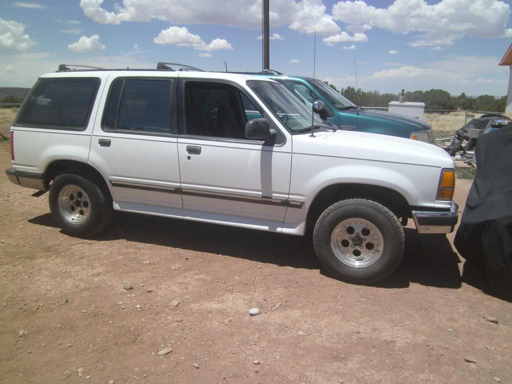

Here are a couple pics I will get more up soon.
Trav

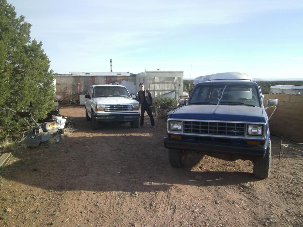

Next to our 84 Bronco 2 (ignore my brother)
