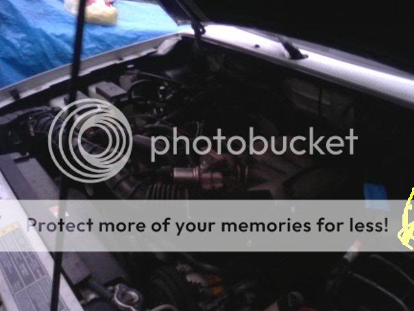

Okay, so the yellow is kinda where the big fuse box is, where about is the little one?
Ahh crap...my bad.
Its inside, below the steering column.
Its under the dash, below the steering column.
