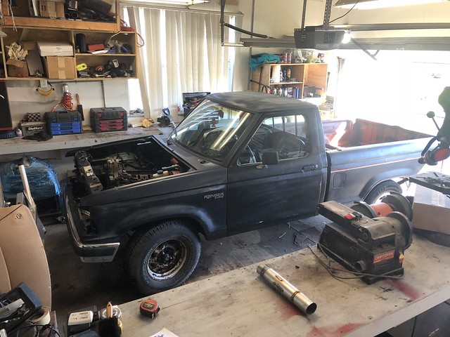

Well guys. After a year of resting. She’s made her way back into the shop! Pics are on the way.
so pulled her back into the shop finally

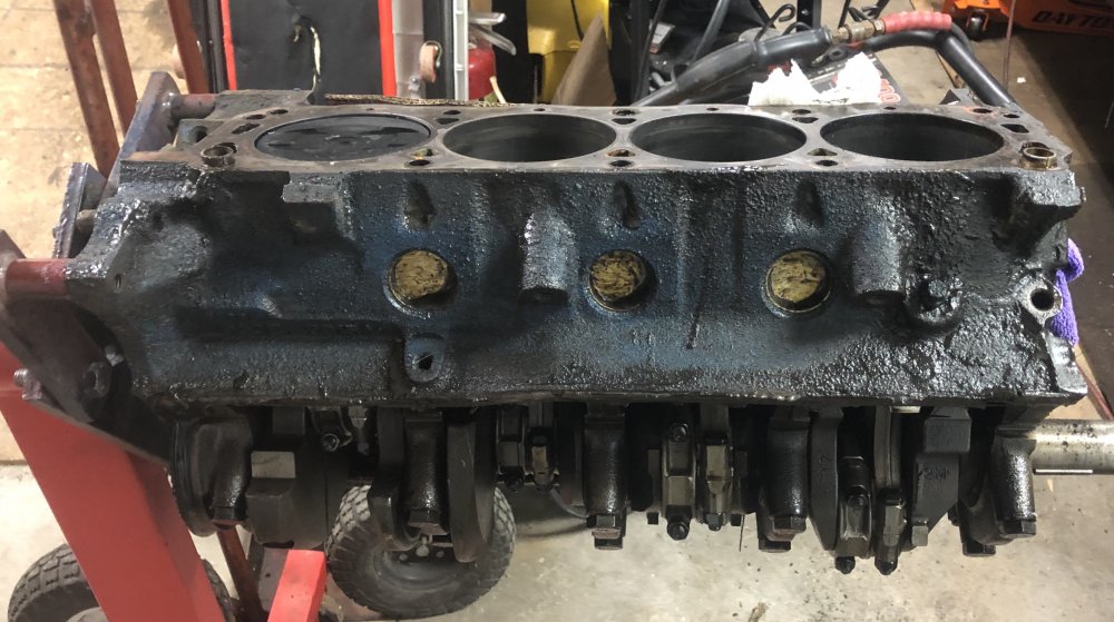

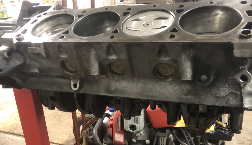

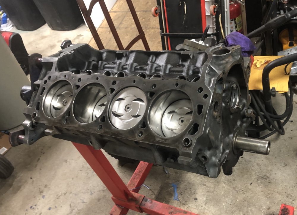

tore the engine down. very happily surprised. turns out to be a 306. and a fairly recent rebuild

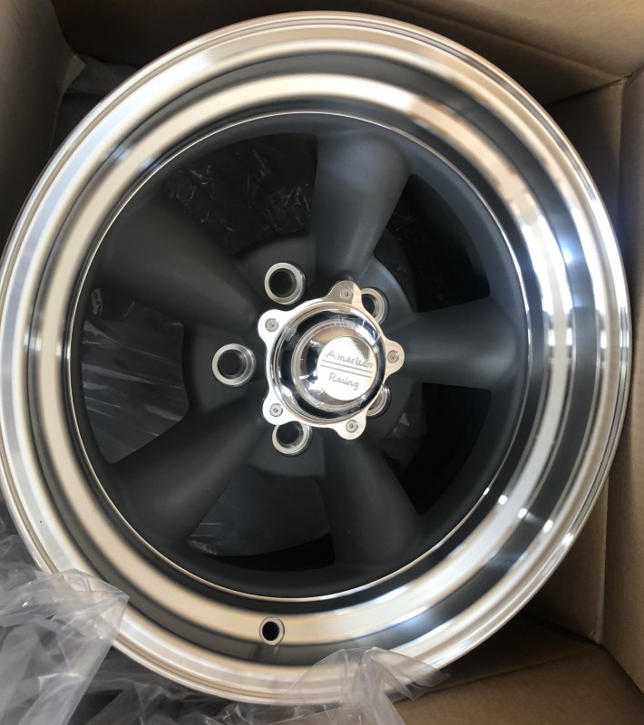

So I just didn’t like the black d windows on the old girl. Felt like I was just slapping parts on it to make it drive. Took a step back. And realized I need to do things right the first time. So I sold that wheel and tire package. Got most of my money back. And purchased the correct wheels for the truck. Behold!!!
Oh yes
