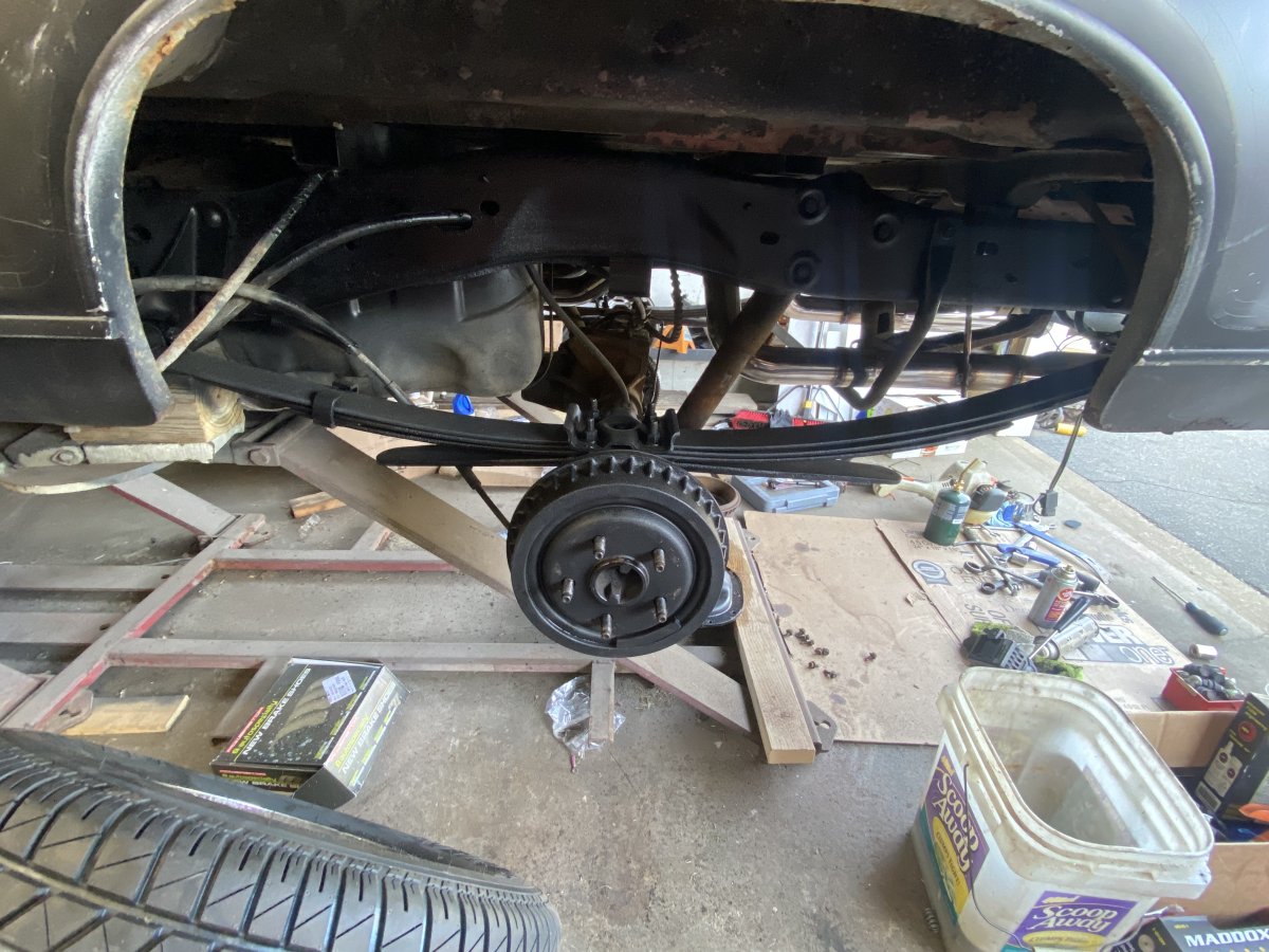

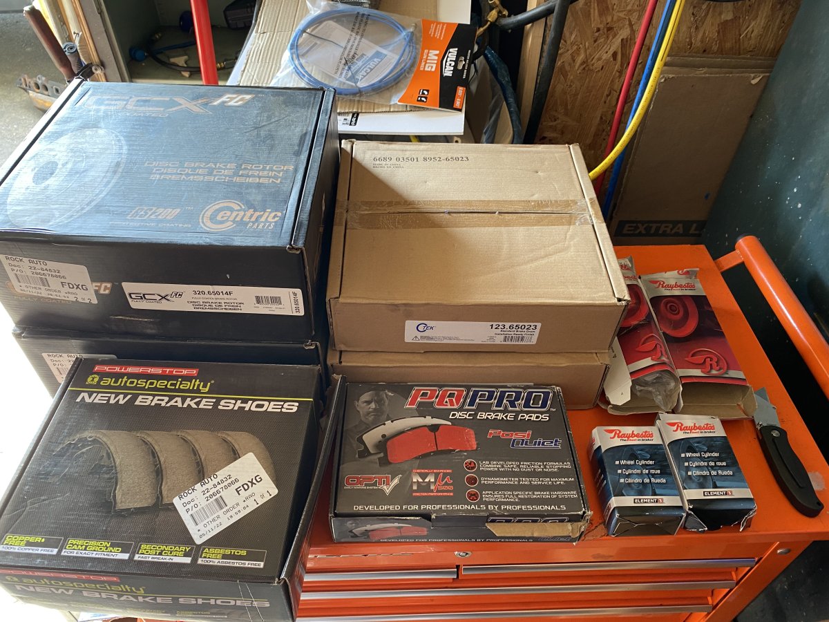

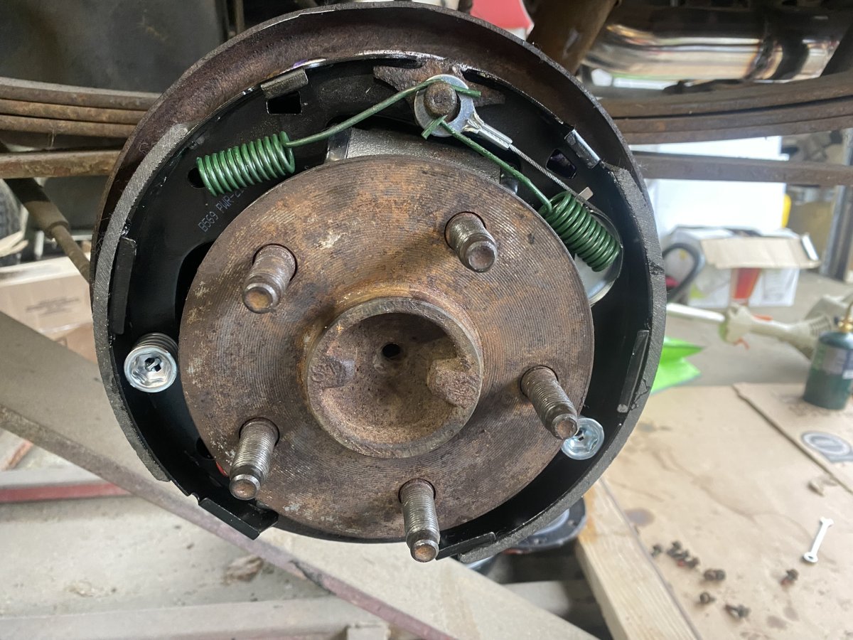

Brakes are kind of important. So are all the parts you need. So waiting on more stuff from rock auto. Yay
  • Blackwidow reborn

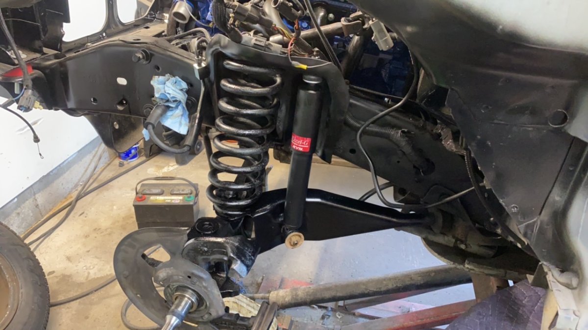

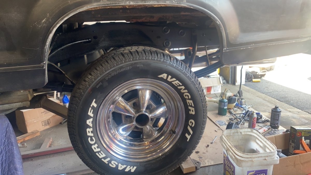

New axle bearings. New seals New hardware kit. Parking brake kit. Shoes. Wheel cylinders. Drums.
On the front. New ball joints. Shocks. Bearings. Seals. Rotors. Calipers. Hoses. And pads. Making her road ready one day at a time.

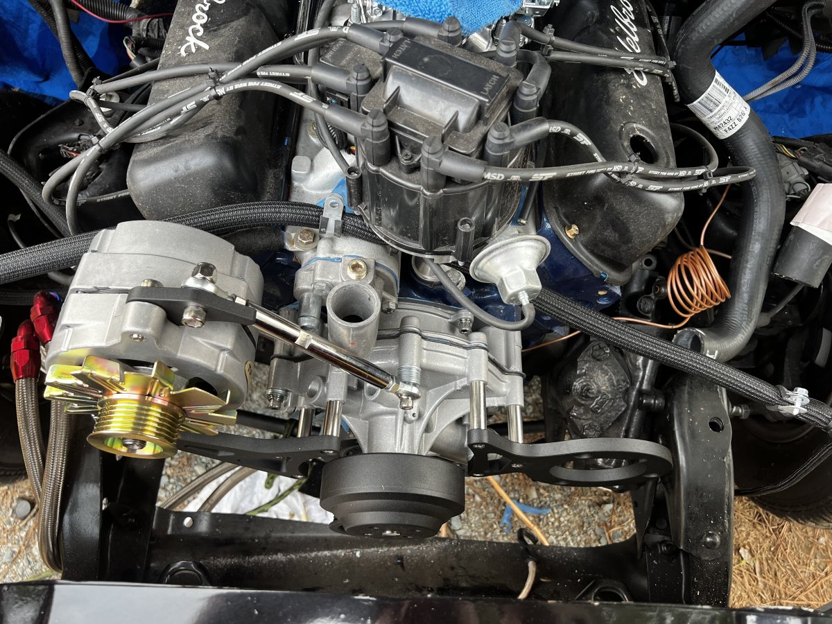

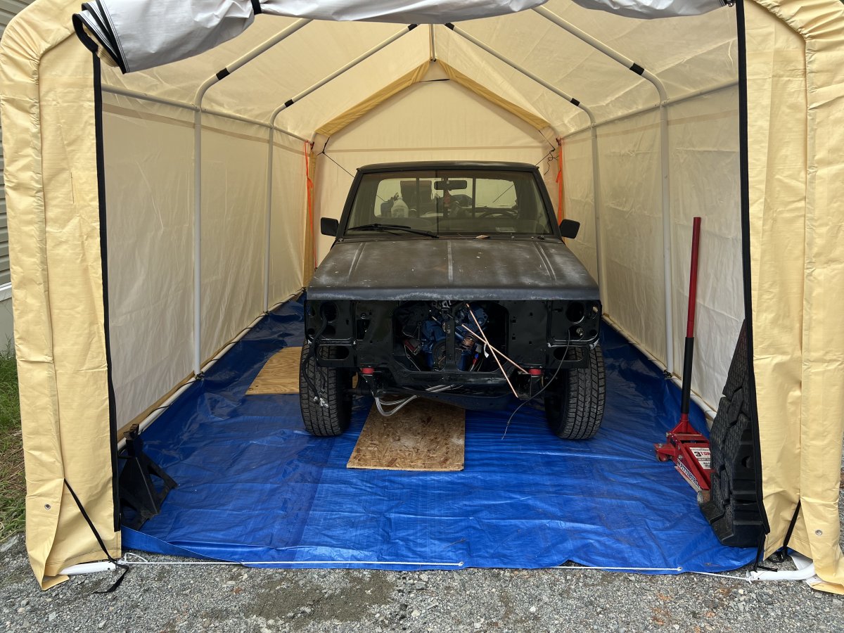

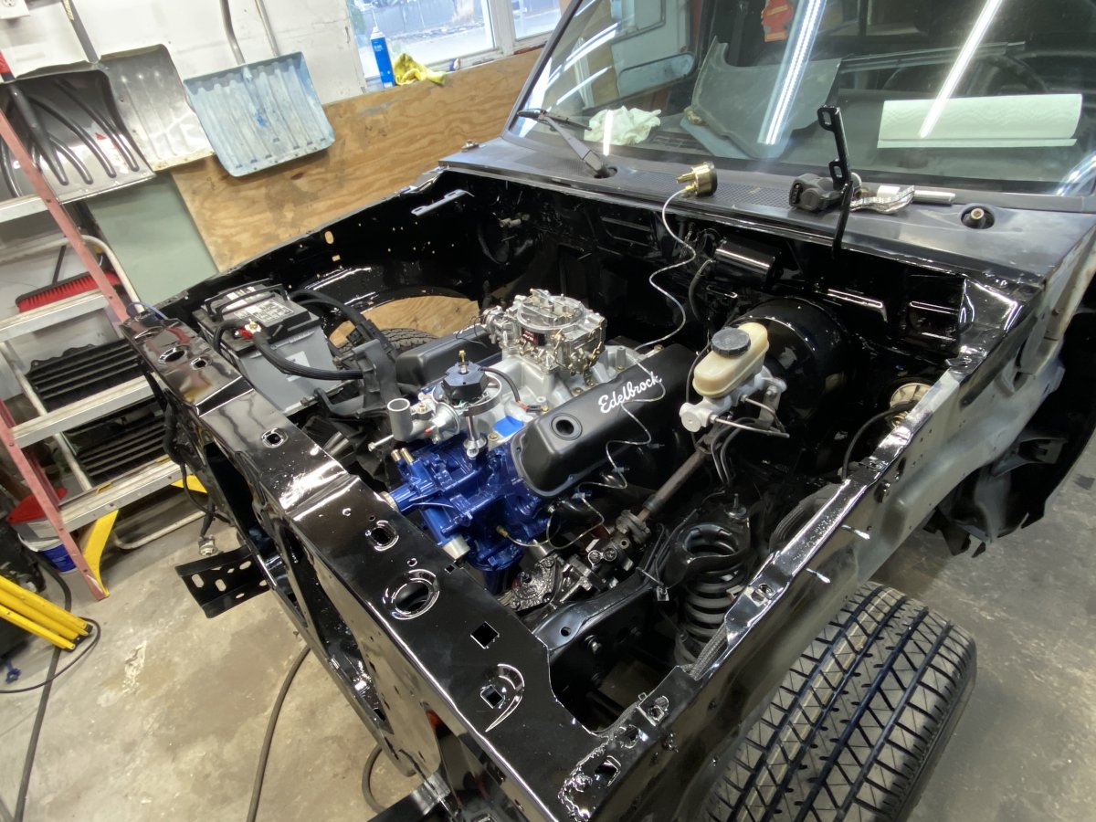

Setup a “garage” at my house. So I can get back to working on this thing. Haven’t found a job yet. So everything’s kinda been on hold. Hopefully I find something soon. But in the mean time. I can do the free fixes on the old girl.

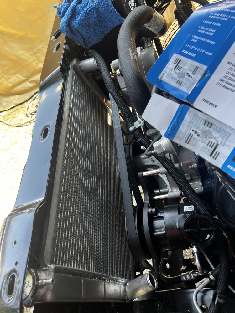

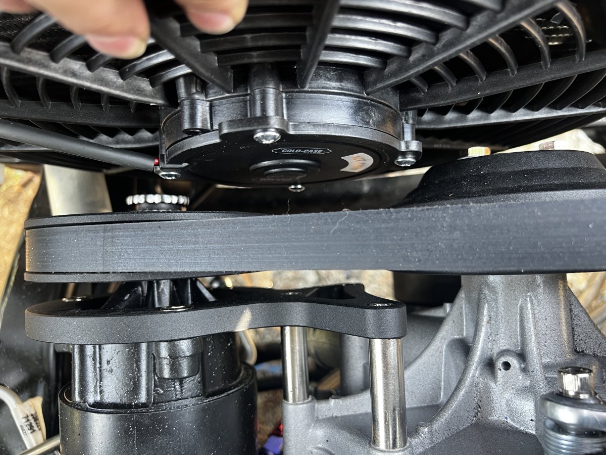

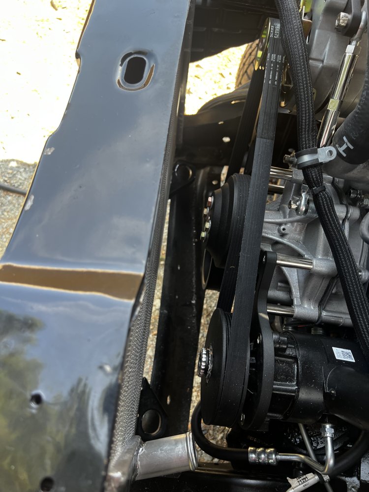

Alright. Had to swap timing covers and the water pump. I tried using the accessory kit from the sn95 mustangs. But nothing fit right. So I found this generic serpentine system off evil bay for a decent deal. Not the greatest quality but it will work fine for my needs.
Sadly. The stock radiator won’t fit. So I got a 28x16 universal radiator from Jegs. Little core support trimming. And we have plenty of room again.

you have to admire the irony of how a windsor fits and s10 and a 350 fits a ranger.
Or how to put a distributor on a ls. You use a Windsor distributor 😝

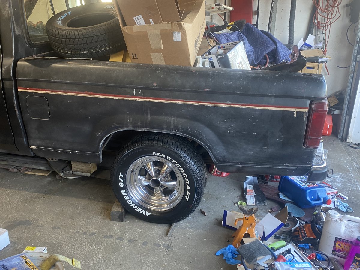

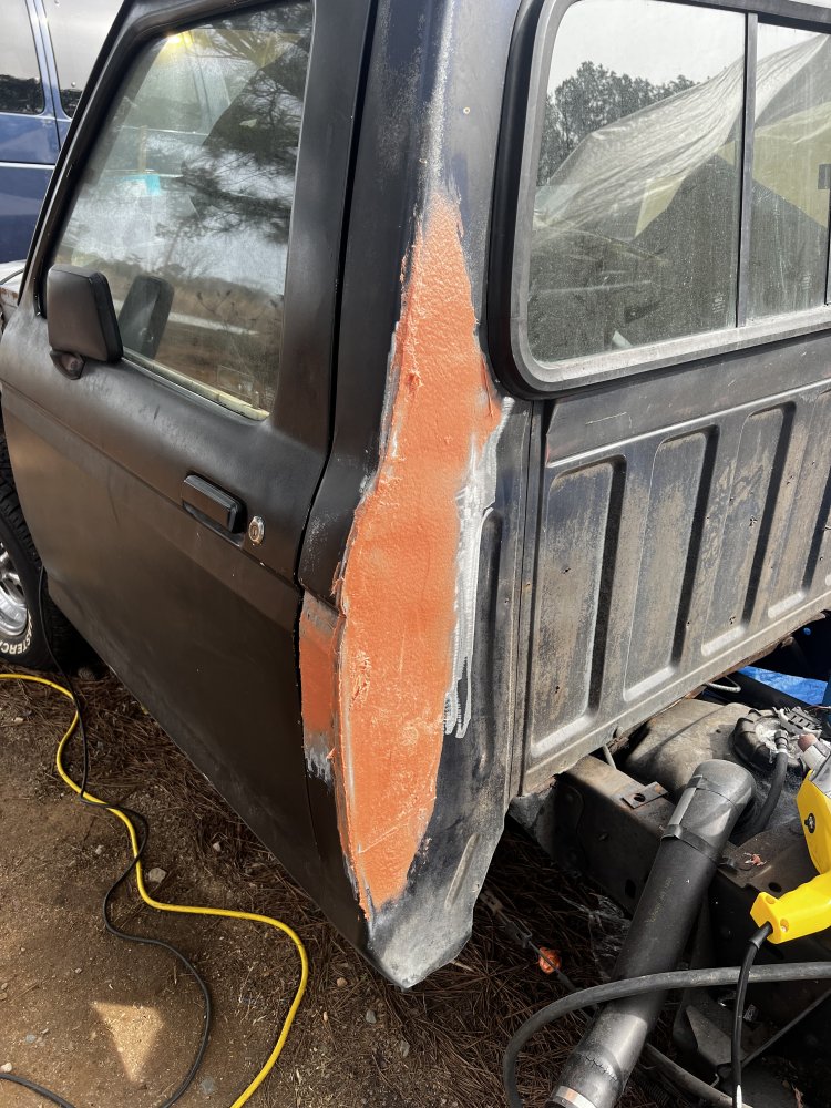

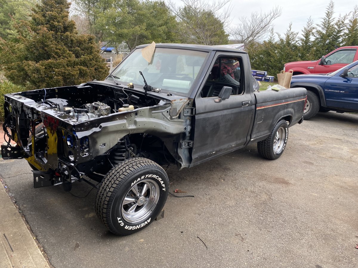

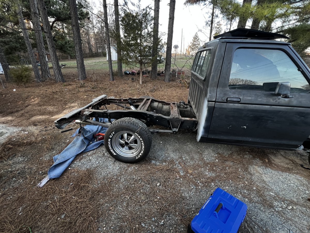

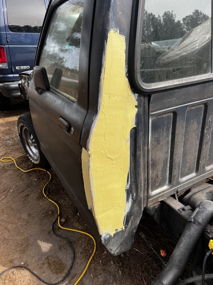

Only been 10 years. I should probably fix, finish this cab corner……
