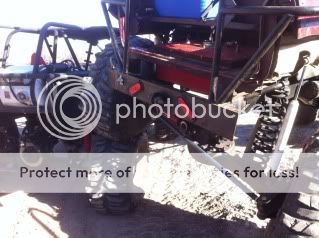

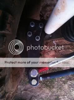

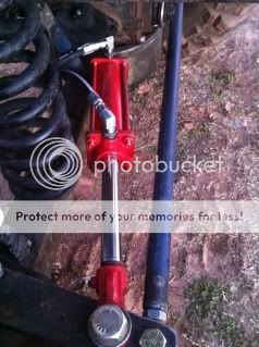

I had a question about the angle of the ram you installed. When i put the assist ram on the Ex, i had to make it parallel with with tierod. I assume this doesn't apply to the rear steer setup? My ram kept binding up, to the point it actually broke the mount off the front axle.
Hey Todd,
On a Rockwell the kingpin cover that you replace for highsteer arm is not level or square. Its pointed down toward the stock TRE location and leans in too. So the thing moves in about three directions at once. My tie rod is on heims, and the hyd ram is angled to match the angle of the high steer arm.
Make any sence????

made perfect sense. Looks awesome man. Can't wait to see some wheeling action of it

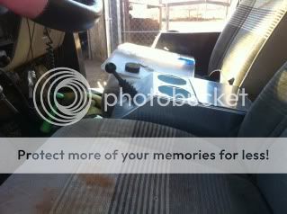

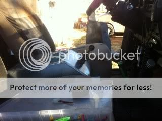

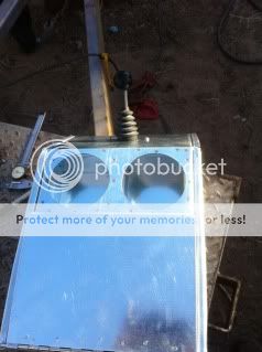

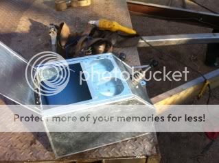

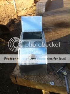

Center console, rear steer joystick mounted in it.
Im going to sand it, smooth all the edges/corners and paint it later in the week.
Wanted to get it in there today. Might go wheeling tomorow!!!!

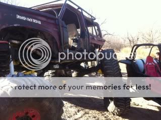

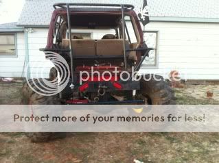

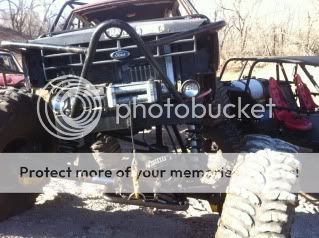

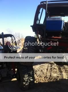

Here are some crappy pictures!!! I got to go to a friends house for a little bit and play. He just picked up a veryyyy early Sniper Fab buggy. 350/350, 203, steer rocks.
Kinda poser shots but we had a blast!!! Im gonna save up and get a 2"dia ram. The three is just wayyyyyy to s l o w.

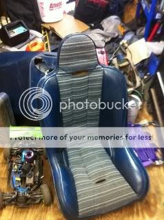

I bought me some pimpin 70's PRP suspension seats!!!!
Hell for $50 i couldnt loose....
