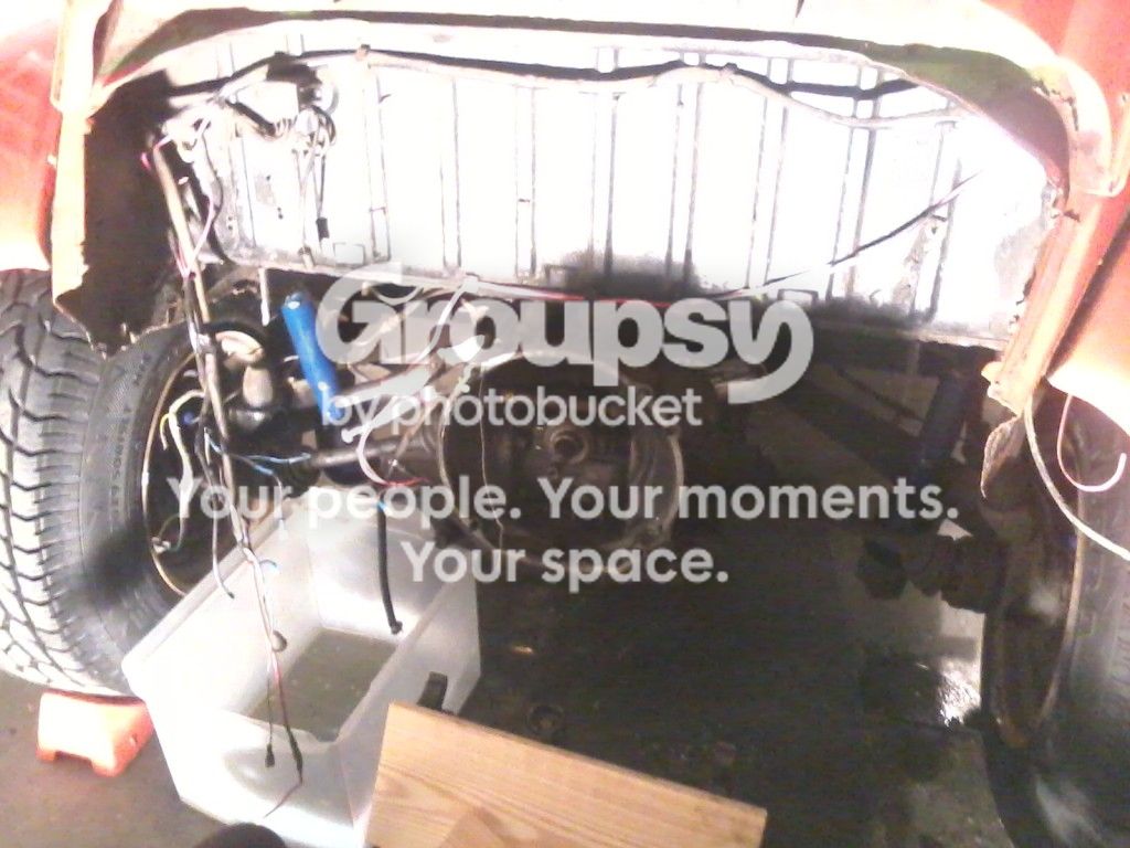

So at the end of today, I finished up gutting the interior and pulled the engine. Unfortunately when disconnecting the fuel line, it ruptured and leaked the entire gas tank so now the garage smells wonderful. anyway, here are the pics:

the motor was surprisingly light. It only took two people to pick it up and move it.

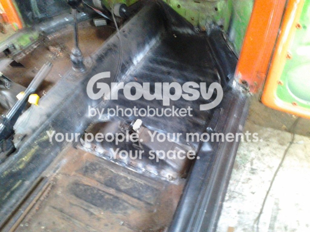

The floor tacked in:

Hopefully the body will be done by early November. Then the engine work begins!

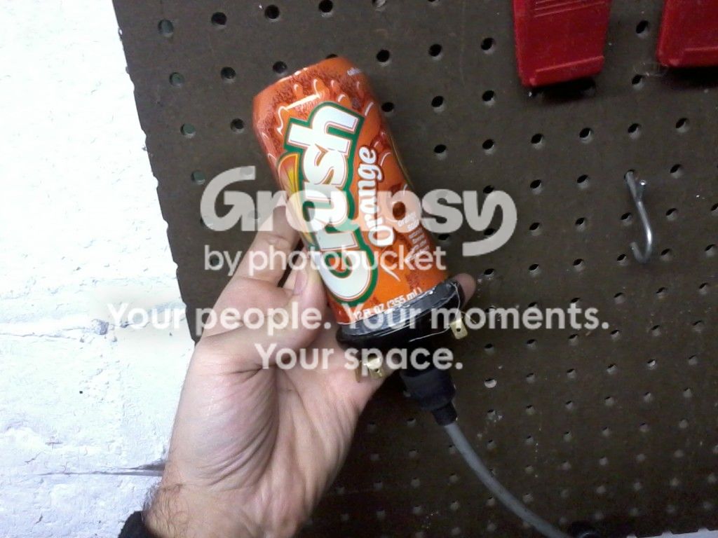

ignition coil cover I just made:
