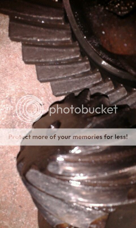

but on another note i swapped out the welded carrier in the front for a open one. hoping that will make it easier on the shafts. while i was in there i slapped some new gears in also. the old ones were toast. kinda hard to see but there toast

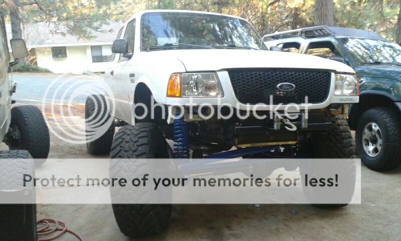

What size tires are you running? maybe I am blind but I didnt see it on my quick run through...
Truck looks sick btw!
im running 37's.

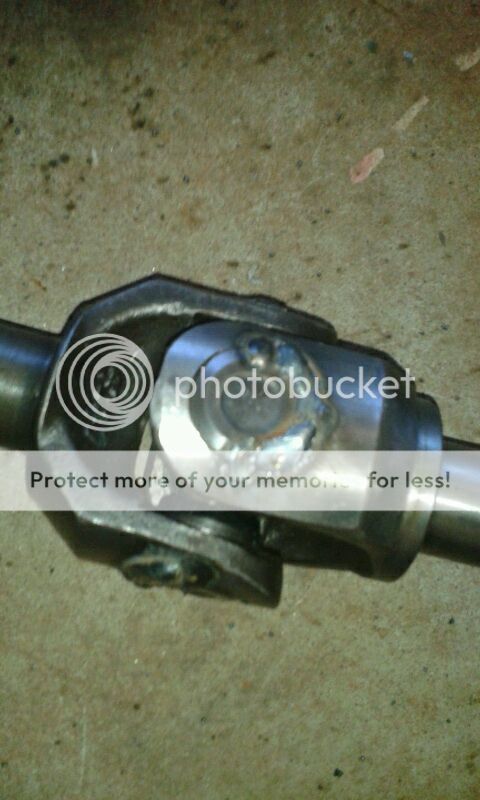

got her back up and running today. had stock shafts for the passenger side but had to salvage the cromo shafts for the other side
better late than never! sas v8 blah blah blah
passenger side. i dont think it will last to long. the weld looks like crap. my welding helmet took a shit. i did it blind.

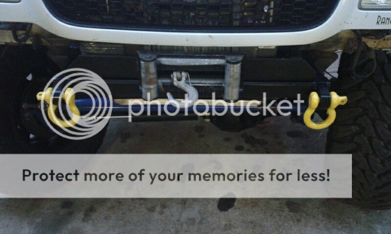

I'm totally going to steel your winch location idea. Thanks!
i did have to loose my a/c condenser to get it back far enough to not cut the grille. my f250 has a/c so my trail rig doesnt need it.
