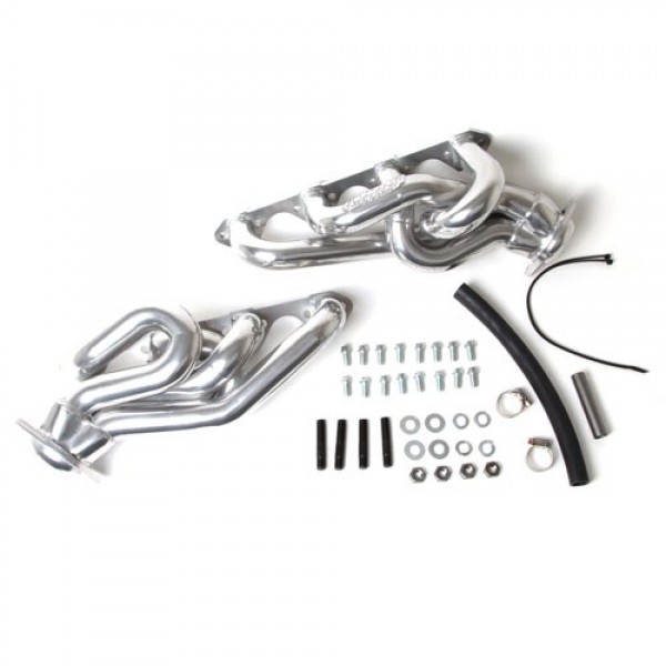

Back from the dead.....so for a 4x4 v8 swap ive gathered the 88400 headers will work, especially with a body lift. Im curious if anyone might know if the foxbody bbk equal lengths would clear....specifically on the driverside with the steering shaft. Posting a pic of them.
They are aimed correctly to clear transmissions, front driveshaft, starter etc, like the 88400's, just not sure about the steering shaft.
Or the patriot clipster headers if they will clear the frame and firewall.
