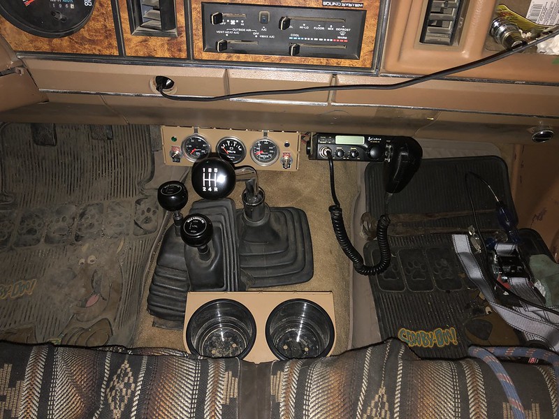

I have this pic of mine, though it was taken after I put a short body lift on the truck (though I also did raise the trans & t-case a bit too so I could make a flatter skid plate underneath). As such, it might not be a good reference. Again though, before the body lift and raising the trans, there was about 3/8" between the knob and bottom of the radio.
I have a full size CB in my '90 and tucked it down further than junkie's and don't hit it with anything. Wait, I swapped to a smaller one that still doesn't work, but used the same bracket... anyway, there's lots of room and if memory serves there's even two holes in the dash pointing down there so you don't even have to drill holes in the dash.

Different era truck but I put mine on the right side. Drove to Indiana and back and the only complaint I heard from the copilot was about the mike getting bumped off. I threw it between the t-case shifters and no more complaining.
