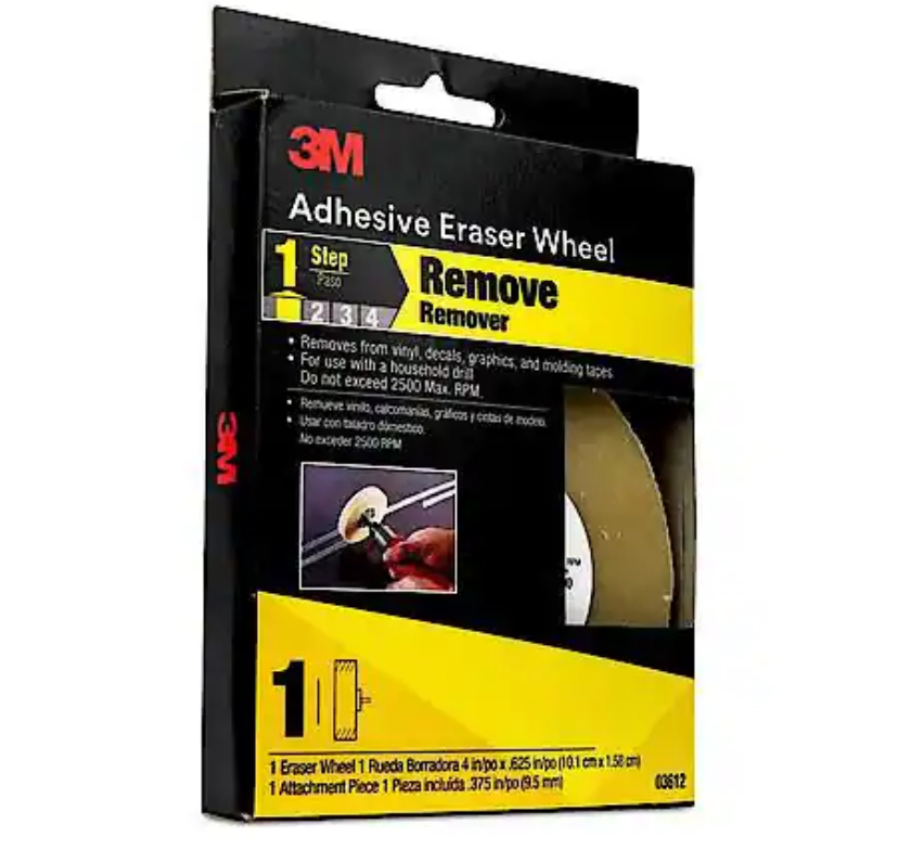

I got a 3M eraser wheel and a can of 3M adhesive remover coming tomorrow.

I wish I would have taken a picture... but I used my cheap heat gun... non marring trim tool.. and easily the badges came right off. Trouble is... like all of the adhesive tape stayed on the truck.
I had to pick and use my scraper to get the tape going... but that eracer wheel is the bees knees.
One down... one to go.
