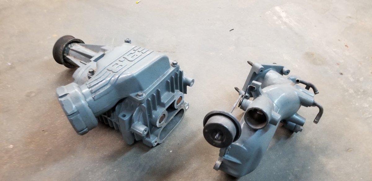

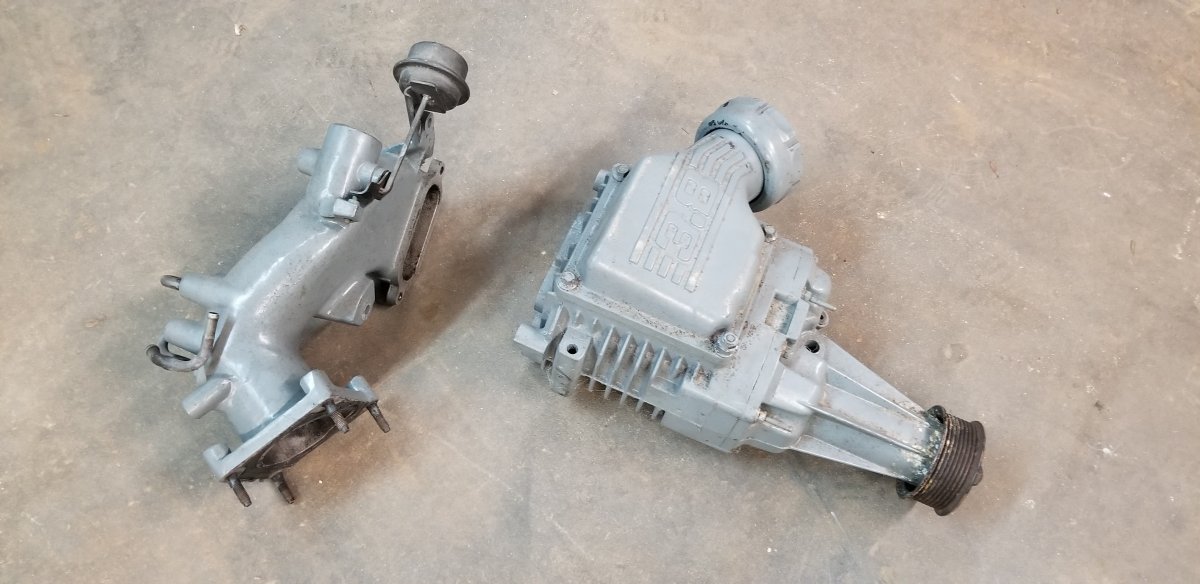

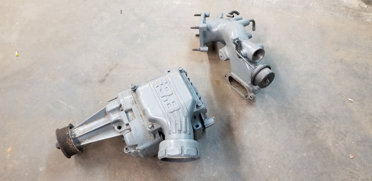

You mean like this one?
32961
32962
32963
I assume that's the right M90 for the ModdBox kit. Amiright?
ModdBox kit
Yup. That's the correct one.
Well damn! I might actually have to do this then. It's still $1800 for 60ish HP though. $30/hp might not be the best bang for the buck.
